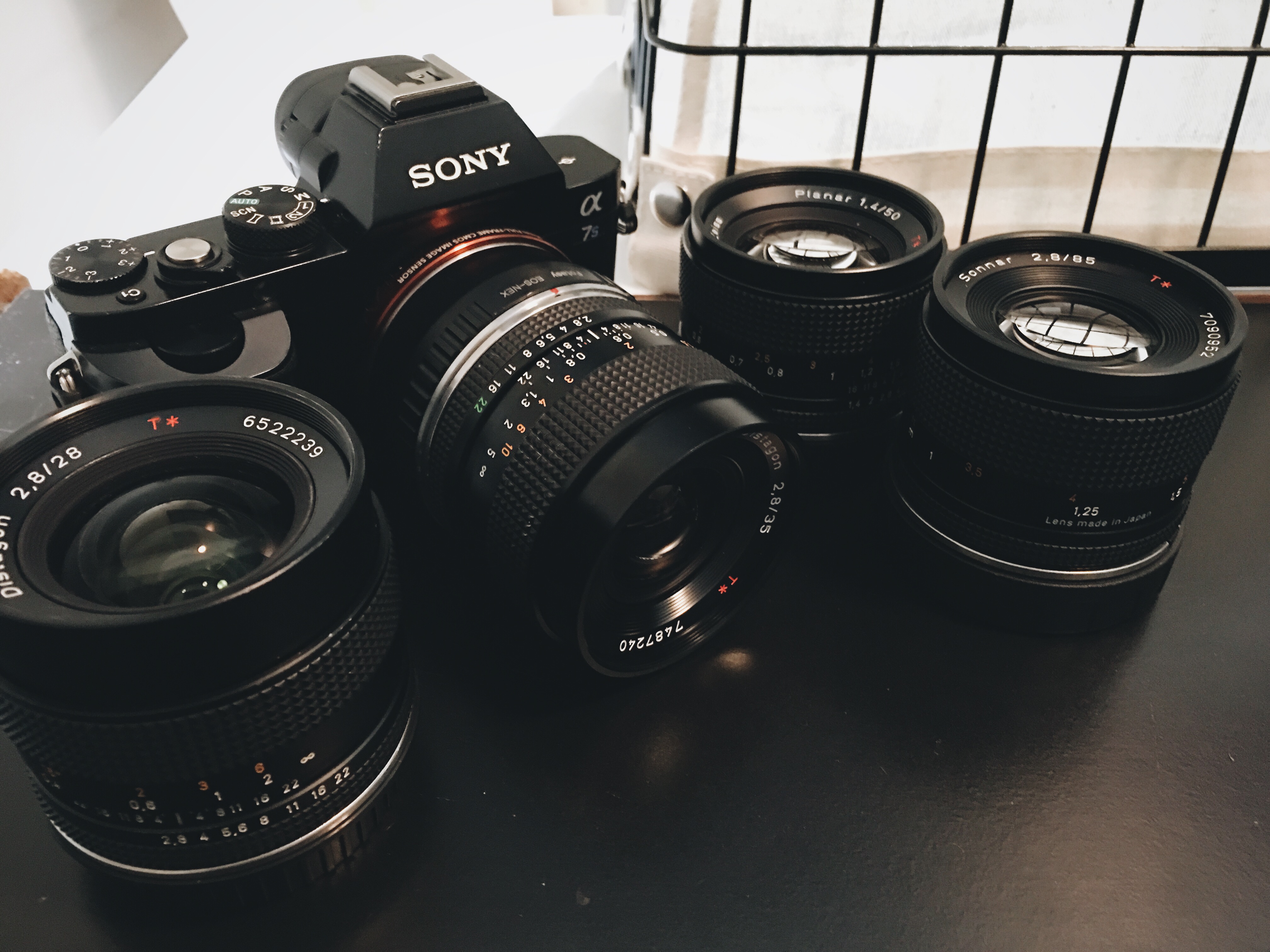

Dave Maze Posted April 11, 2016 Share Posted April 11, 2016 I love my CONTAX Zeiss set. 28, 35, 85 f2.8 and 50 f1.4. Link to comment Share on other sites More sharing options...
