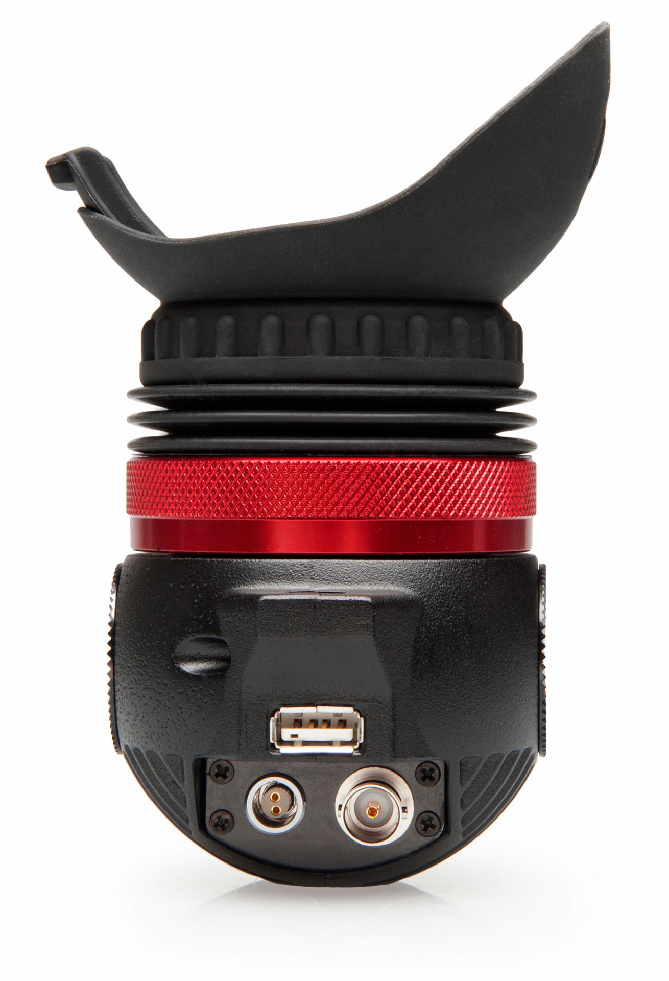

Garug Posted April 14, 2016 Share Posted April 14, 2016 About the USB connector, the connector on the EVF is the same type as on computer? Is there actually a USB cable that has the computer end type USB connector on both ends? Link to comment Share on other sites More sharing options...
Don Kotlos Posted April 14, 2016 Share Posted April 14, 2016 4 minutes ago, Garug said: About the USB connector, the connector on the EVF is the same type as on computer? Is there actually a USB cable that has the computer end type USB connector on both ends? That is a type A USB 2.0 female connector in order to plug in usb thumb drives. You can download files into the drive that can: a) update the firmware b) Update the LUTs that you can use Link to comment Share on other sites More sharing options...

yoclay Posted April 22, 2016 Share Posted April 22, 2016 Frankly, I still don't understand why this posting of Andrew's has not been amended. He is quick to attack manufacturer's for their sloppiness, but man this is a glaring error. The crux of his original post clearly presents this viewfinder as working with DSLR's which only have HDMI out, yet it is an SDI only EVF. The only way to deal with this is some kind of conversion box, which defeats the whole purpose of a smaller EVF. Link to comment Share on other sites More sharing options...
jcs Posted April 22, 2016 Share Posted April 22, 2016 The Gratical Eye will be used with some kind of rig for a DSLR, which will have an external battery and power (to run the Gratical and camera). Something like this little guy won't add much weight (though extra weight can be helpful for balance): http://www.gearbest.com/cables-connectors/pp_304334.html?currency=USD Link to comment Share on other sites More sharing options...
