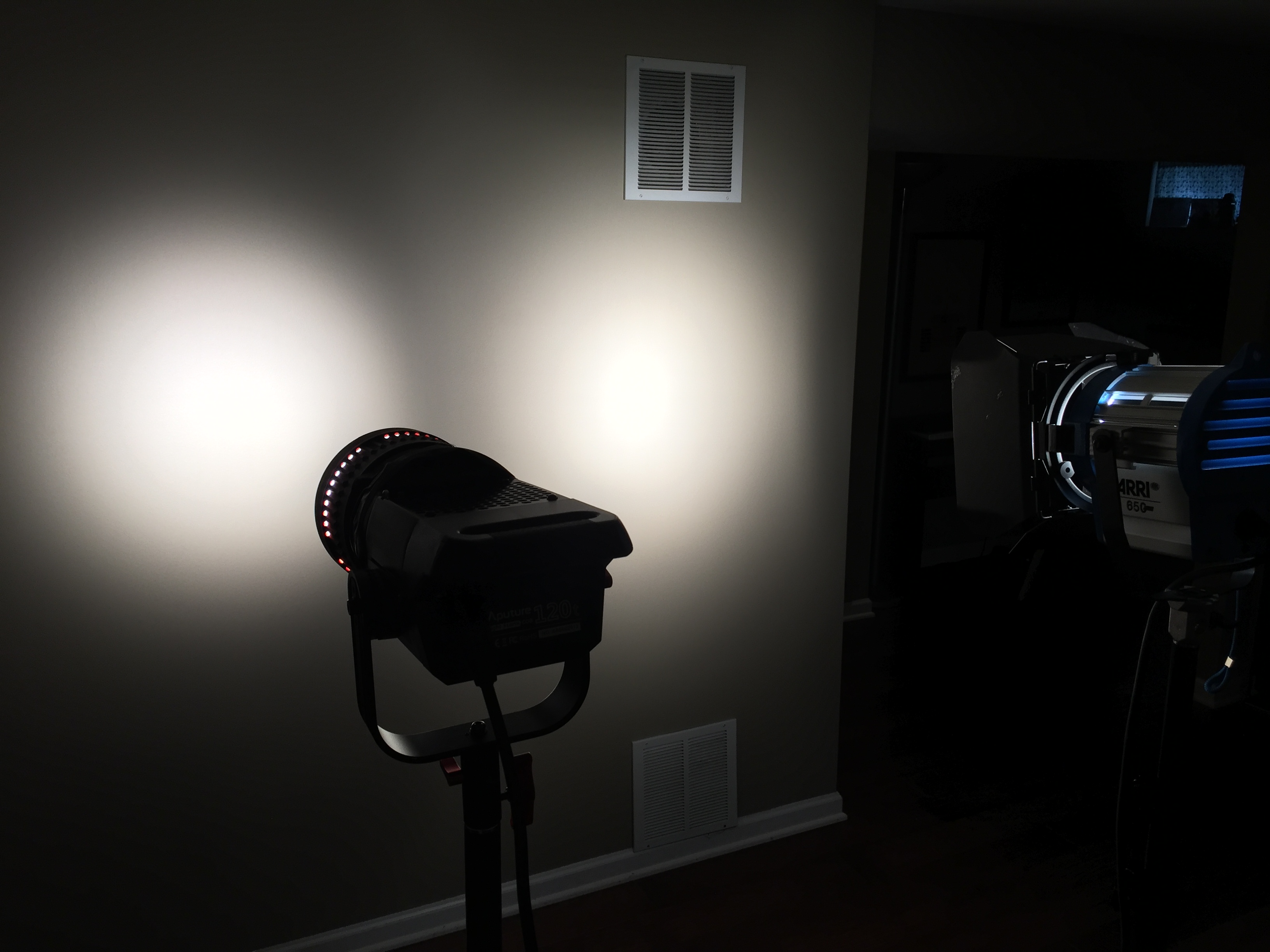

AaronChicago Posted June 22, 2016 Share Posted June 22, 2016 Okay, here is an update after I got a fresnel lens attachment for the Aputure 120t. The Aputure light is brighter than the Arri 650, by eye. I used my CineMeter II app to take some Lux measurements. (Keep in mind that the app isn't 100% accurate but it is extremely accurate relatively. In other words comparing 2 readings will give a correct interval.) At 2 ft. away it was reading Aputure 120t: 15,000 Lux Arri 650: 11,000 Lux At 5 ft. away things started to even out. Aputure 120t: 4,000 Lux Arri 650: 3,800 Lux Color temps: Aputure 120t: 3050 Arri 650: 3150 I'm still not convinced that this is hitting a 1K equivalent. I'd say more like 800 watt. Link to comment Share on other sites More sharing options...

squig Posted June 23, 2016 Share Posted June 23, 2016 On 6/22/2016 at 6:56 PM, AaronChicago said: Okay, here is an update after I got a fresnel lens attachment for the Aputure 120t. The Aputure light is brighter than the Arri 650, by eye. I used my CineMeter II app to take some Lux measurements. (Keep in mind that the app isn't 100% accurate but it is extremely accurate relatively. In other words comparing 2 readings will give a correct interval.) Expand I noticed you've got the fresnel lens attached in that shot. Where those measurements taken with the fresnel? And does that fresnel actually focus to 40 degrees with the 120T? On the 100D it only goes to about 20 degrees on the wide end. Link to comment Share on other sites More sharing options...

AaronChicago Posted June 23, 2016 Share Posted June 23, 2016 On 6/23/2016 at 1:12 AM, squig said: I noticed you've got the fresnel lens attached in that shot. Where those measurements taken with the fresnel? And does that fresnel actually focus to 40 degrees with the 120T? On the 100D it only goes to about 20 degrees on the wide end. Expand Yeah the measurements were done with the fresnel. Beam angle claims 10-40 degrees but I'm not sure if it goes all the way to 40. I had both fresnels about 1/2 way down (guessing around 25). On 6/23/2016 at 1:54 AM, rotgg said: can you get barn doors for that fresnel attachment Expand Unfortunately no. Link to comment Share on other sites More sharing options...
