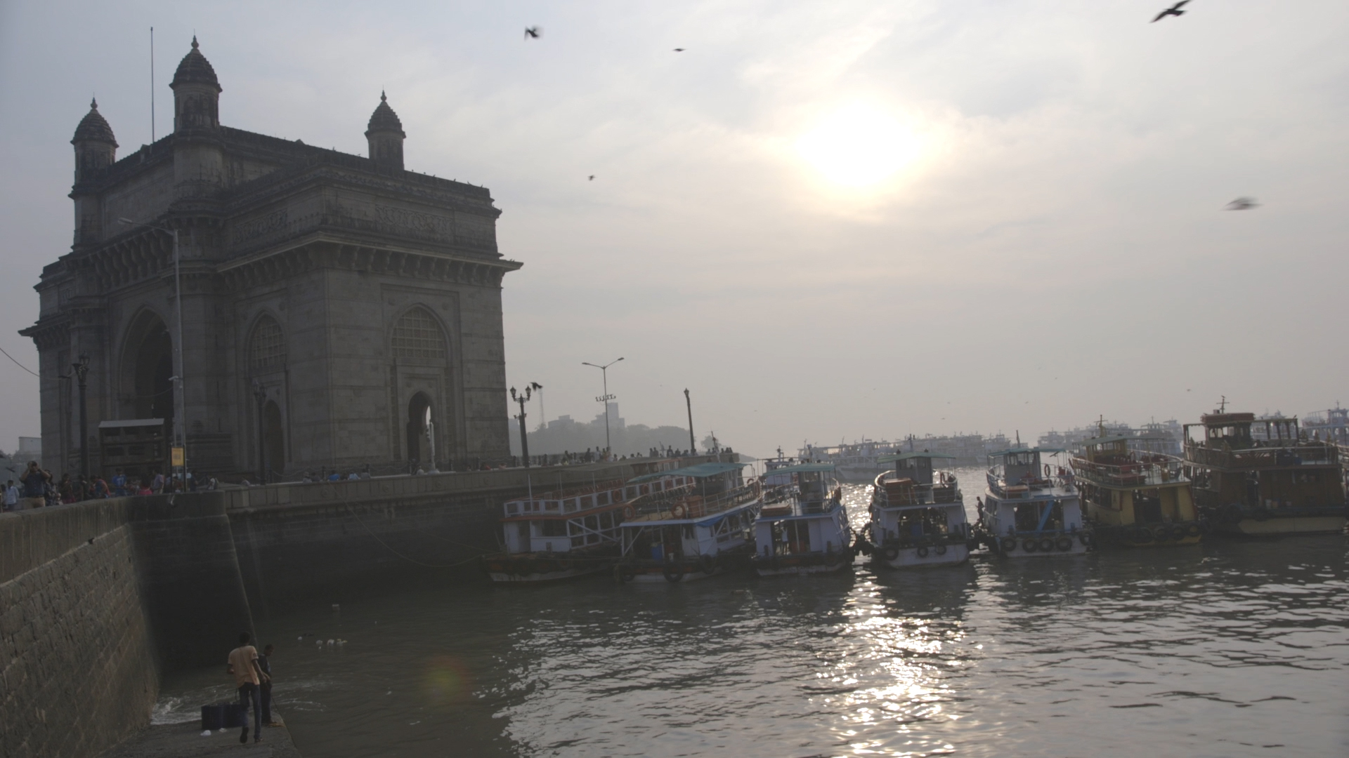

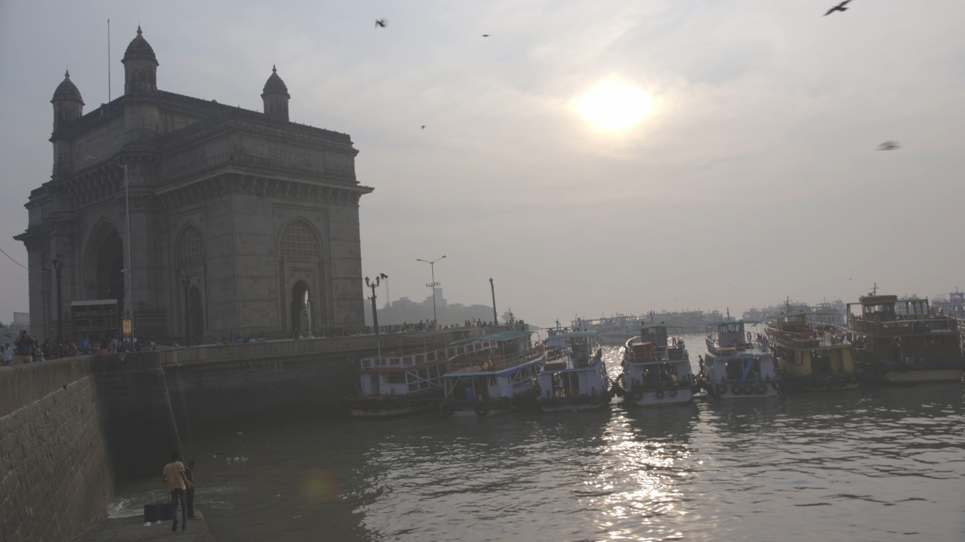

User Posted May 4, 2016 Author Share Posted May 4, 2016 Transcode example using 5DtoRGB Both jpegs were exported from PPro CC2015. No grading/ correction. 1st jpeg: Original AVCHD 2nd jpeg: Original AVCHD transcoded to ProRes using 5DtoRGB using 'Full Range'. 3nd jpeg: Original AVCHD transcoded to ProRes using 5DtoRGB using 'Broadcast Range'. The difference between jpeg 1 and jpeg 2 is easily discernible. The only perceivable difference between jpeg 2 and jpeg 3 is seen in the YC Waveform. Broadcast Range brings the 110 IRE down to 100 IRE. Comments? Link to comment Share on other sites More sharing options...
Policar Posted May 4, 2016 Share Posted May 4, 2016 7 hours ago, User said: I'm about to start the process of transcoding the C100 MkII AVCHD material using 5DtoRGB. My settings will be: ProRes 4.2.2 Rec709 Full Range No Post Processing. Gamma 1.0 The C100 MkII material was shot in WDR picture profile so it won't be as 'flat' as C-log. As such, do you still recommend 'Full Range?' Like you said earlier, after transcoding, the material can still be tweaked to broadcast norms. Correct? Cooling fans about to kick in... Based on your above example, I got it backwards. I'd go with whatever pushes down the super whites so you can keep them when you go to After Effects etc. Link to comment Share on other sites More sharing options...
User Posted May 4, 2016 Author Share Posted May 4, 2016 3 hours ago, Policar said: Based on your above example, I got it backwards. I'd go with whatever pushes down the super whites so you can keep them when you go to After Effects etc. Why, does After Effects not see anything above 100 IRE? Link to comment Share on other sites More sharing options...
Policar Posted May 4, 2016 Share Posted May 4, 2016 46 minutes ago, User said: Why, does After Effects not see anything above 100 IRE? In my experience it sees it in float mode but not 8 bit or 16 bit. But float mode is quirky. Something to do with YUV to RGB conversion. Not sure. Not important if you're not using it, either. Link to comment Share on other sites More sharing options...
User Posted May 4, 2016 Author Share Posted May 4, 2016 18 minutes ago, Policar said: In my experience it sees it in float mode but not 8 bit or 16 bit. But float mode is quirky. Something to do with YUV to RGB conversion. Not sure. Not important if you're not using it, either. Hmmm. I almost never use After Effects... though someone might bring these skills to the film down the road and I hope they wouldn't be limited as I have transcoded a fairly large chunk of material since beginning the render. I guess it can always rendered again. I guess at the end of the day, I'm happy to see that with the 'Full Range' setting the IRE is touching 110 IRE and in PPro I've seen in the past that there is a percentage of highlight detail in that range retained. Maybe at 'Broadcast Range' (100 IRE) that detail may not be so easily accessible anymore. I don't know... ya know? Link to comment Share on other sites More sharing options...
jgharding Posted May 5, 2016 Share Posted May 5, 2016 C100 appears to capture over 100 into super. Using it in Premiere you can just pull it back, it's not a hard clip, that's probably the float engine at work. It's really useful. You'll probably lose that when you transcode I'd guess. I wonder if "full range" in 5D2RGB is pushing that down into a 0-100 file, hence the look? 32-bit in AE sees it all, slows working down though. I often work in 8-bit, occasionally check 32, and render in 32. On 04/05/2016 at 0:55 PM, User said: Sorry if it wasn't clear, and thanks for the insight, but as mentioned twice in this thread, I am on CC. I went ahead with the transcode to ProRes because of the 4.2.2 space and because I will grade and add effects. Moreover, I have had issues with the Mercury Playback Engine while using 8.2.0 (Creative Cloud 2015). Also because another member suggested that it makes round-tripping between other programs easier. Ah I missed that, sorry. Yes if you're having trouble with Mercury I'm sure ProRes will be easier on the system. User 1 Link to comment Share on other sites More sharing options...
User Posted May 5, 2016 Author Share Posted May 5, 2016 5 hours ago, jgharding said: C100 appears to capture over 100 into super. Using it in Premiere you can just pull it back, it's not a hard clip, that's probably the float engine at work. It's really useful. You'll probably lose that when you transcode I'd guess. I wonder if "full range" in 5D2RGB is pushing that down into a 0-100 file, hence the look? 32-bit in AE sees it all, slows working down though. I often work in 8-bit, occasionally check 32, and render in 32. Thanks JG. Appreciate the tips. When I look a the ProRes transcodes done using 'Full Range' on the YC Waveform, the super whites riding up to 110 IRE. So I think that must be a good thing. Link to comment Share on other sites More sharing options...
