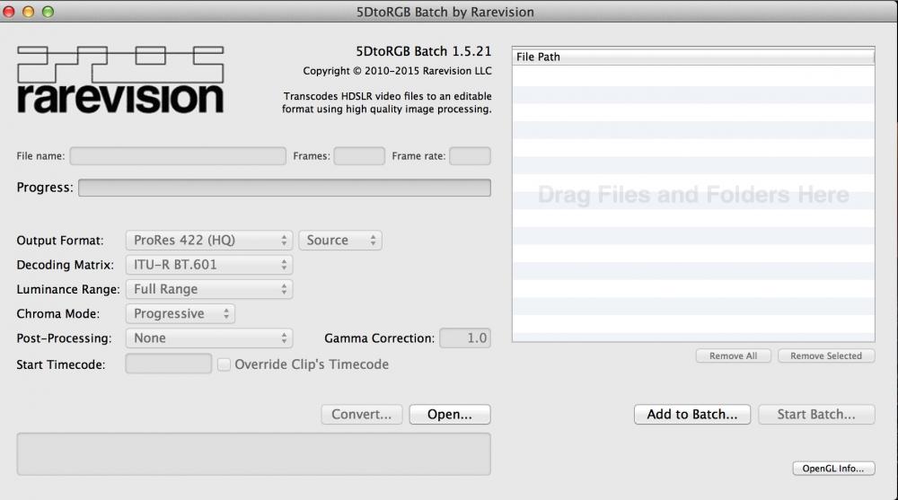

My understanding is that 5DtoRGB 'Full Range' uses the full 0-255. So everything that was recorded by the C100 MkII is retained in the transcoded ProRes material. This is what I'm sticking to until I hear otherwise.

Let me quote from the 5D2RGB manual:
Quote
Luminance Range: This setting tells 5DtoRGB whether to interpret the color range in your footage as full range (0-255) or broadcast range (16-235). The correct setting will depend on the camera used. Some cameras, like Canon HDSLRs, shoot using full-range color. On the other hand, the Panasonic DMC-GH2 shoots using broadcast range color. If you select "ITU-R BT.709" as your decoding matrix, "Broadcast Range" will be selected automatically.
But even if "full range" is the correct setting for your camera and profile, you should think about what they say here:
Quote
It also recognizes Canon's full range 8 bit YCbCr values (0-255), avoiding clipping and the resulting loss of picture information. The resulting files are the absolute highest quality you'll ever get out of the camera. In fact, you could argue that they're even better than the camera originals since they've undergone high quality chroma smoothing.

Yes, Full Range in 5DtoRGB is usually the safer way to go with footage from cameras that record a greater range than Legal / Broadcast Range of 16-235.
The trouble is that most modern cameras record using neither Full Range (0-255) nor Broadcast Range but instead use Extended Range (16-255) (and increasingly both Extended aa well as Broadcast depending on the setup and picture profile used) and 5DtoRGB has no option for correctly mapping values for footage that uses Extended Range.
If your camera is one of the many now that sometimes produces these 16-255 values (also known as super-whites) then by setting 'Full Range' in 5DtoRGB you will avoid highlight clipping that using the 'Broadcast Range' setting risks, but your luma values usually will still be shifted a little, which is generally thought not an ideal thing to do to master 8-bit video recordings that are going to be graded etc.
