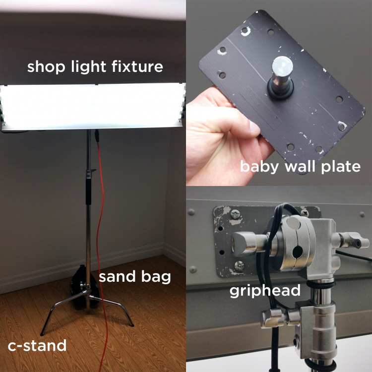

andrgl Posted May 10, 2016 Share Posted May 10, 2016 Parts List: 4ft Fluorescent Shop Light, Ballast Included: On Sale $20 4 x T8 Bulb, 5000K, 98 CRI: On Sale $20 C-Stand: Used $100 Grip Head: Used $20 Baby Wall Plate: Used $5 Sandbag: Used $5 Total Cost: $170 By comparison, a 1 light Kino kit would cost around $1,100 sans Lamps or C-Stand. Cons: Ugly as **** Non-Dimmable (However: You can pop out lamps to have 4 levels of light.) No Barn Doors Heavy (10lb total = Fixture 8lb + Bulbs 2lb) Geoff CB, Zach Goodwin and Cinegain 3 Link to comment Share on other sites More sharing options...

andrgl Posted May 10, 2016 Author Share Posted May 10, 2016 50 minutes ago, M Carter said: You'd be amazed at how many 4-bank and 6-bank biax Kino knockoffs are out there for $200 or less... LOL not really. There's a lot of trash gear online. But I prefer not having to swap out garbage, <90 CRI, osram bulbs. I also like to being able to use 4' lamps instead of those little itty bitty ones: they're ubiqitous, infinitely cheaper and more useful for interior ambient and keying. But each to his own I suppose. I didn't think anyone actually used the lights you talk about. Fuck, I can imagine how nasty that shit looks with 8-bit cams. Would be a nightmare to correct in post. Maybe just YouTubers? Can't fathom a client paying for that sort of light. Link to comment Share on other sites More sharing options...
