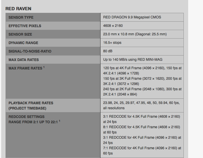

Cinegain Posted May 15, 2016 Share Posted May 15, 2016 Quote Is the RED DRAGON sensor the same for SCARLET DRAGON and EPIC RED DRAGON? Yes. What lenses can I use with the RED DRAGON sensor? You can use any lens designed for Full Frame 35mm formats btw... WEAPON 6K (Carbon Fiber) SENSOR SENSOR TYPE RED DRAGON 19.4 Megapixel CMOS MAX FRAME RATES (EPIC) 175 fps at 6K Full Frame (6144 x 3160), 100 fps at 6K 2.4:1 (6144 x 2592) 96 fps at 5K Full Frame (5120 x 2700), 120 fps at 5K 2.4:1 (5120 x 2160) 120 fps at 4K Full Frame (4096 x 2160), 150 fps at 4K 2.4:1 (4096 x 1728) 150 fps at 3K Full Frame (3072 x 1620), 200 fps at 3K 2.4:1 (3072 x 1296) 240 fps at 2K Full Frame (2048 x 1080), 300 fps at 2K 2.4:1 (2048 x 864) Sure, it shoots at 1.17x crop compared to 35mm (not like the full frame DSLRs don't like to crop in on video). Still called a full frame camera. Link to comment Share on other sites More sharing options...
Jimmy Posted May 15, 2016 Share Posted May 15, 2016 They can call it what they want.... It is simply not a full frame camera (36mm x 24mm) When they say Full Frame on that spec sheet, they just mean "non windowed"... eg, it uses the full frame of the sensor... They have been (mis) using that term since day one. I guess Raven is full frame too? jax_rox 1 Link to comment Share on other sites More sharing options...
