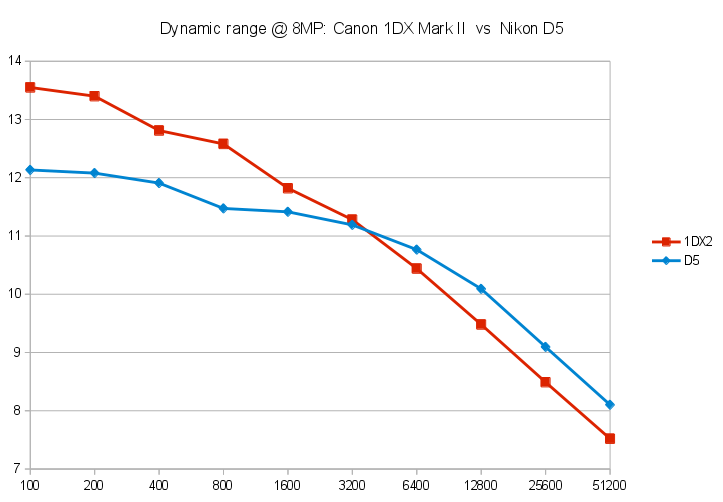

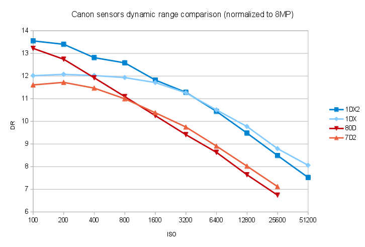

Where are you getting these DR numbers for the 1DX II and why would you assume that the 1DC has a "weaker sensor"? In fact, most of the tests we have seen show equal performance, if not an edge for the older sensor as in the DPreview article already cited on this forum:
http://***URL removed***/news/8090146652/canon-eos-1d-x-mark-ii-studio-tests
After all, the 1DX/1DC sensor has larger photosites than the second generation (6.95 vs. 6.65 microns) and can theoretically achieve a greater signal-to-noise ratio. Perhaps processing advancements and the gapless micro-lens sensor technology can make up for the smaller photosites of the 1DX II so as to even out the noise performance between the cameras, but it is doubtful that it could be much better.
From what I have seen, the 1DX II video footage performs exactly the same as the 1DC in neutral no matter what you do with those superficial picture profile settings, which means that it has 9 stops of DR and a lot of crushed blacks and nearly-clipped highlights:
The 1DC on the other hand will give you a very different look with better DR, smoother roll-off, and much lower contrast, not to mention the wider and richer color gamut that goes with C-Log when grading the footage in post:

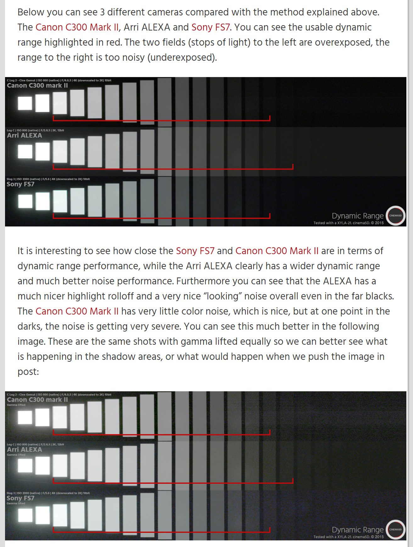

Cinema5D's testing methodology is a joke. Every reputable source has rated the C300 Mk II as 14-15 stops in Canon Log 2 but with the caveat of noisy shadows. Apples-to-inaccurate-apples, what's that site's rating on the 1DC? I'd guess 10-11 stops. What's their rating of the C300 (a legit 12)? Or the 5D (8-9)? I'm guessing something inaccurate. Granted, the Alexa's current generation sensor and firmware has well surpassed 15 stops and Arri reps will privately confirm it, so the Alexa does have better DR and cleaner shadows than anything else. A friend just picked the Alexa Mini over the C300 Mk II and his DR tests just blow my mind. I dropped out of my math major so all the bits and stuff don't really mean anything to me, just not my strength. What does 14 stop with RAW recovery mean? How does a RAW recovery relate to a stop of DR? I never studied image formats.
Accurate comparisons of the C300 Mk II and Alexa show that the Alexa has a worse SNR in the highlights, slightly better in the mids, and far better in the shadows, but that despite very noisy shadows relative to the Alexa, the C300 Mk II (which is also far far cleaner at high ISOs than the Alexa, a common trade off) technically captures nearly as wide a spread of information. It's just not as pretty in the shadows, much more noise there. But a properly exposed image wouldn't emphasize this part of the curve in either camera, so the difference in noise would be minor, but the detail still present in most properly shot and graded material.

http://www.fredmiranda.com/forum/topic/1421137
"Weaker" in the sense that the new sensor is ADC design, and having less noise in the shadows.
Anyway, until we see some direct comparisons and see some footage that hasn't been sharpened either in camera or post we won't really know for sure. Numbers are in some cases meaningless.

This so-called "source" is a member on a fredmiranda.com forum who posted his own chart to the forum with the following caveat:
"Note: all the RAWs (except for the 1DX2) come from Imaging Resource ISO series (the 1DX2 have been received from another source which I won't disclose; please do not ask me for these RAWs)."
This is not a like a publication by DPreview with transparent examples for everyone to see. Moreover, I wouldn't put too much value in that chart until I could see the 1DX II examples for myself. DPreview's test of the 1DX II is fairly damning and is there for everyone to see.
Another test with examples showed that the 1DX II and 1DX are actually identical in performance:
Just like DPreview, he provides concrete examples to prove his point: the 1DX II offers no improvements on DR or noise performance. I also believe they are identical for reasons I stated above in that the 1DX II is starting out with a signal-to-noise disadvantage with its smaller photosites that it has to overcome through more advanced sensor tech and processing (Digic 6+).
From dpreview: Like the EOS 80D there's a big improvement in the camera's dynamic range. Canon's move to a design using on-chip analog-to-digital conversion ensures less noise is added before the signal is converted into digital values, meaning it's easier to distinguish between captured information and background noise. In turn, this means more malleable Raw files with more useful information available when you try to process them.
Same chip ???

The C300 II Trick Shot video is actually a pretty amazing demonstration of DR and color. It just shows you what you can do with C-Log2 even in a compressed 10 bit 4:2:2 codec. This is why it is so important that the 1DC has C-Log. It makes an 8 bit camera act like 10 bit, while a 10 bit camera acts like 12 bit. That's the magic of a good Log implementation.
Cinema5D's methods certainly leave something to be desired as they switch between talking about "visible DR" and "usable DR" in the same review or across reviews. They never posted a 1DC Xyla, but claim that both the C300 I and 1DC achieve around 10-11 stops of "usable dynamic range," without noting whether they employed C-Log (I would imagine they did):
https://***URL not allowed***/dynamic-range-sony-a7s-vs-arri-amira-canon-c300-5d-mark-iii-1dc-panasonic-gh4/
Personally, I find Hurlbut's over-and-under tests of the 1DC and C500 to be a far more valuable indication of DR. His series of tests with the C500, the Alexa, and RED Dragon are also very impressive in terms of what they reveal about the C500 as a camera that surprises with great color and low-light performance:
What I mean by "RAW recovery" is simply what happens when you go into Resolve and use highlight and shadow recovery to extract more DR in the RAW file that you otherwise would not see if you are just looking at the ungraded image. Xyla tests such as the one used by Cinema5D do no represent that extended range, so we could add at least an estimated 2 stops to their results for RAW-capable cameras like the C300 II. Note that there is nothing scientific here about how many stops you can recover. It's just an estimate, but that is certainly the way it works with the CinemaDNG files from my BMPC-4K when I take them into Resolve. I recall that Cinema5D rated the BMPC-4K at 9 stops whereas using Resolve you can lift the shadows at least one stop and recover highlights by at least a stop. Thus, the recovered DR is closer to 11 stops.
As for the Sony F5/F55, it outputs true 16 bit linear RAW . . .  no contest there. It's pretty much the king when it comes to RAW bit depth. Even RED R3D files offer only "16-bit precision" while Alexa and Ursa 4.6k use Log to achieve greater a bit depth that they don't actually record.

You will notice that I made the distinction between visible and usable DR. The Xyla test reveals the entire "visible range," but Cinema5D's conclusions on DR are generally based on the "usable range," which can be reduced by 1-2 stops (especially with RAW). That's what I'm referring to as the recoverable DR that Cinema5D does not include in its DR ratings. You can see this on their Xyla tests as the difference between all the steps the camera records and the red line that marks what they accept as "usable" DR. They even lift the gamma to expose this expanded range that is accessible in post. On the C300 II, they counted only 12 steps (13 bars) of usable DR, whereas the visible DR range goes beyond that by several stops.
Also, the C300 II was tested in its internal 10 bit 4:2:2 codec, where it achieved 12.3 stops of DR on IMATEST. However, using 12 bit RAW one would assume a slightly greater DR and a more usable range. They did not test the camera using its 4K 12 bit RAW output. They claim to have tried it out on 2K 12 Bit RAW but do not post the results as, according to them, it was no different from the 10 bit file.
Ultimately, a Xyla test is just another test with variables that can affect the outcome, including the acceptable level of noise or clipping that one interprets when counting steps. Using IMATEST just guarantees that all camera results are treated equally and can be compared against one another. IMATEST is not some higher standard of DR "precision."  It still has to make a quantitative assessment of acceptable noise and clipping levels. Yet there is no universal or scientific standard for noise performance. What is acceptable to one person may not be to another.
