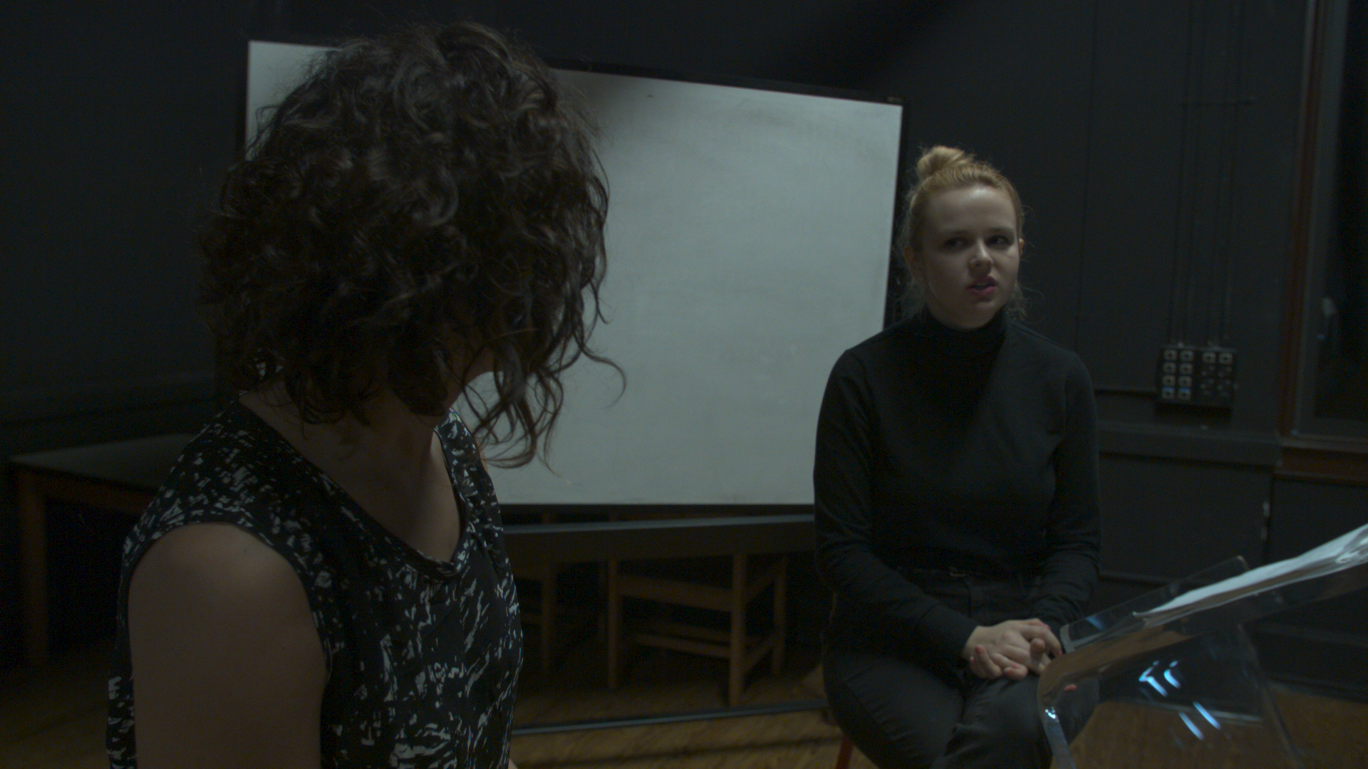

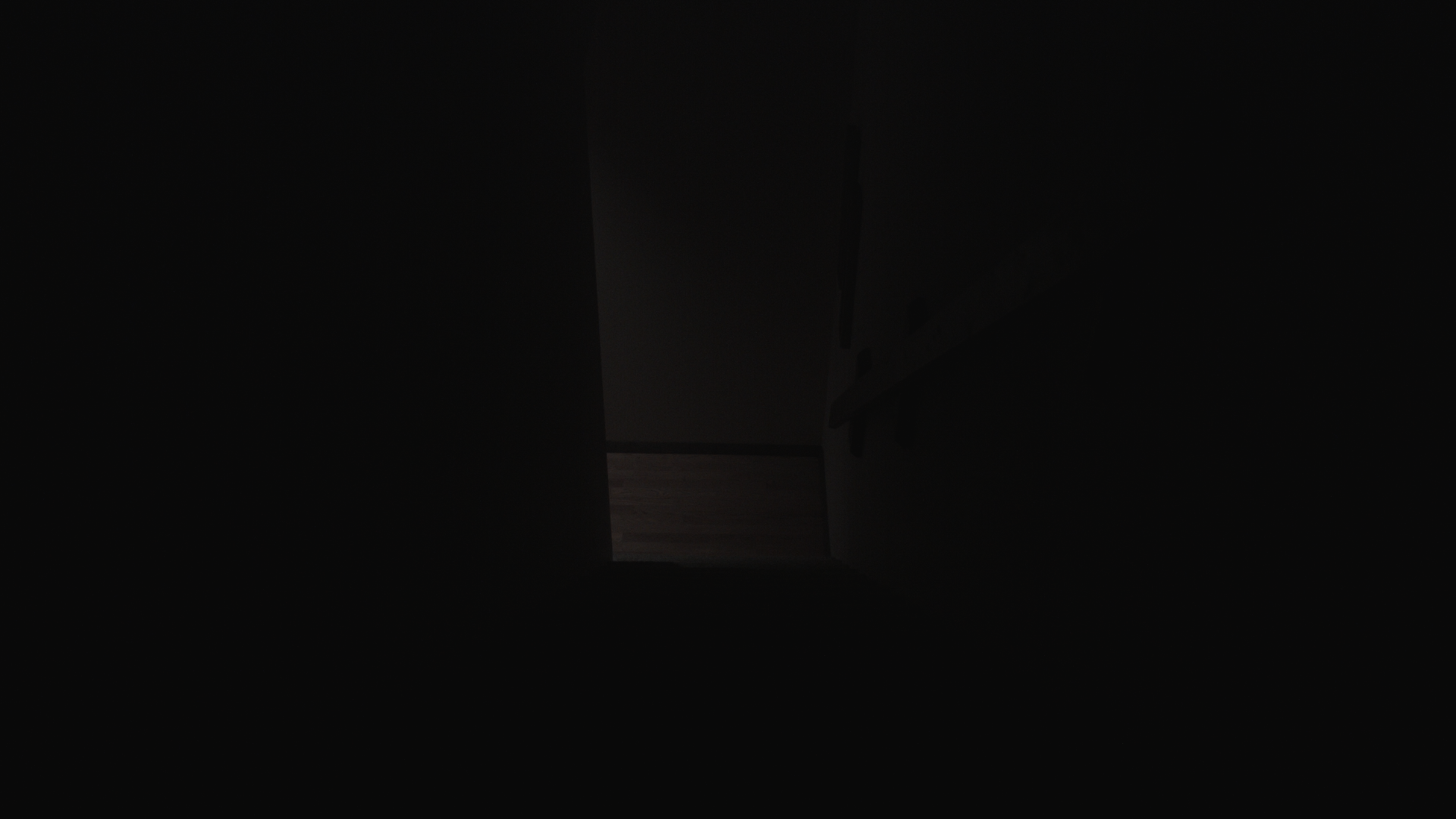

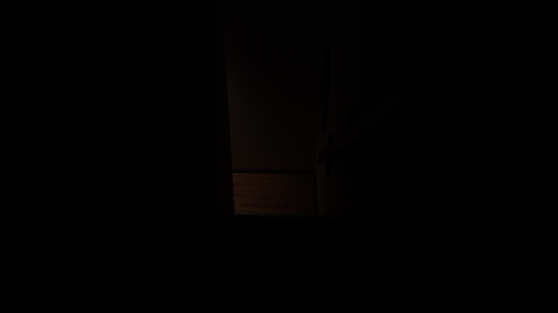

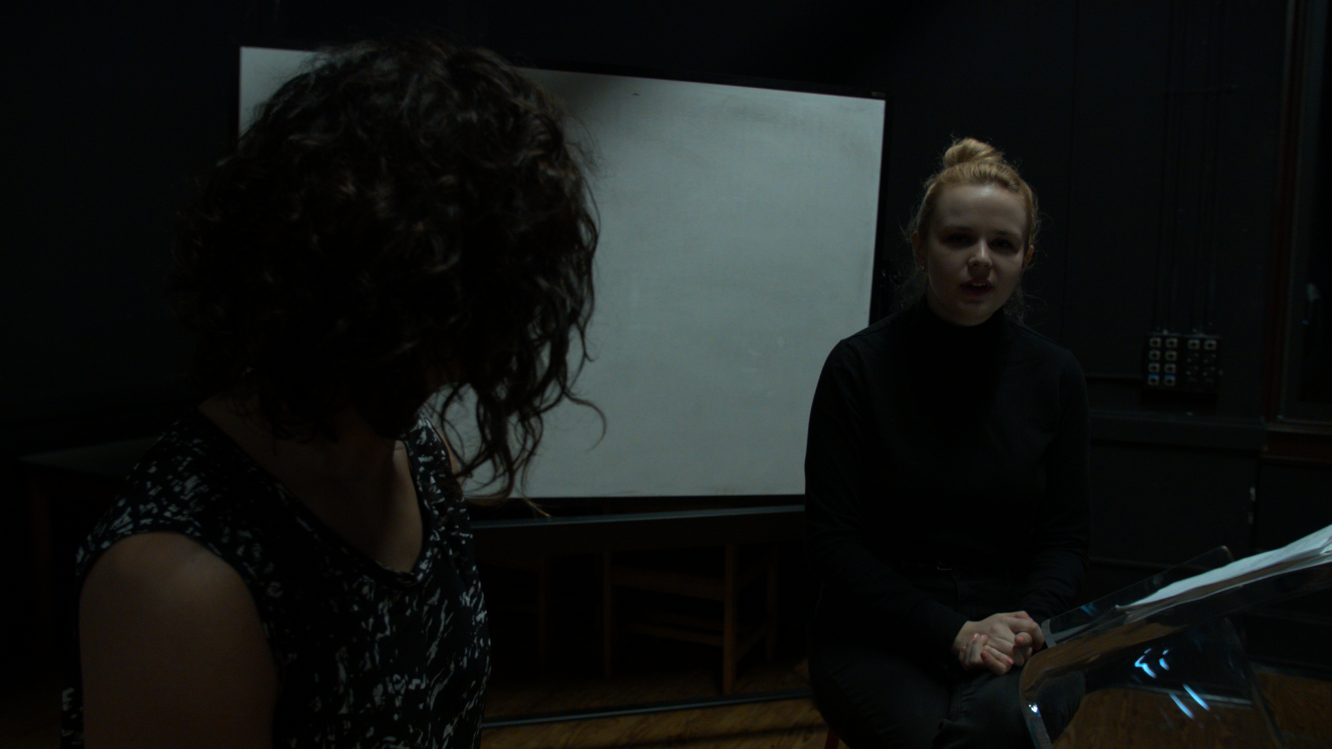

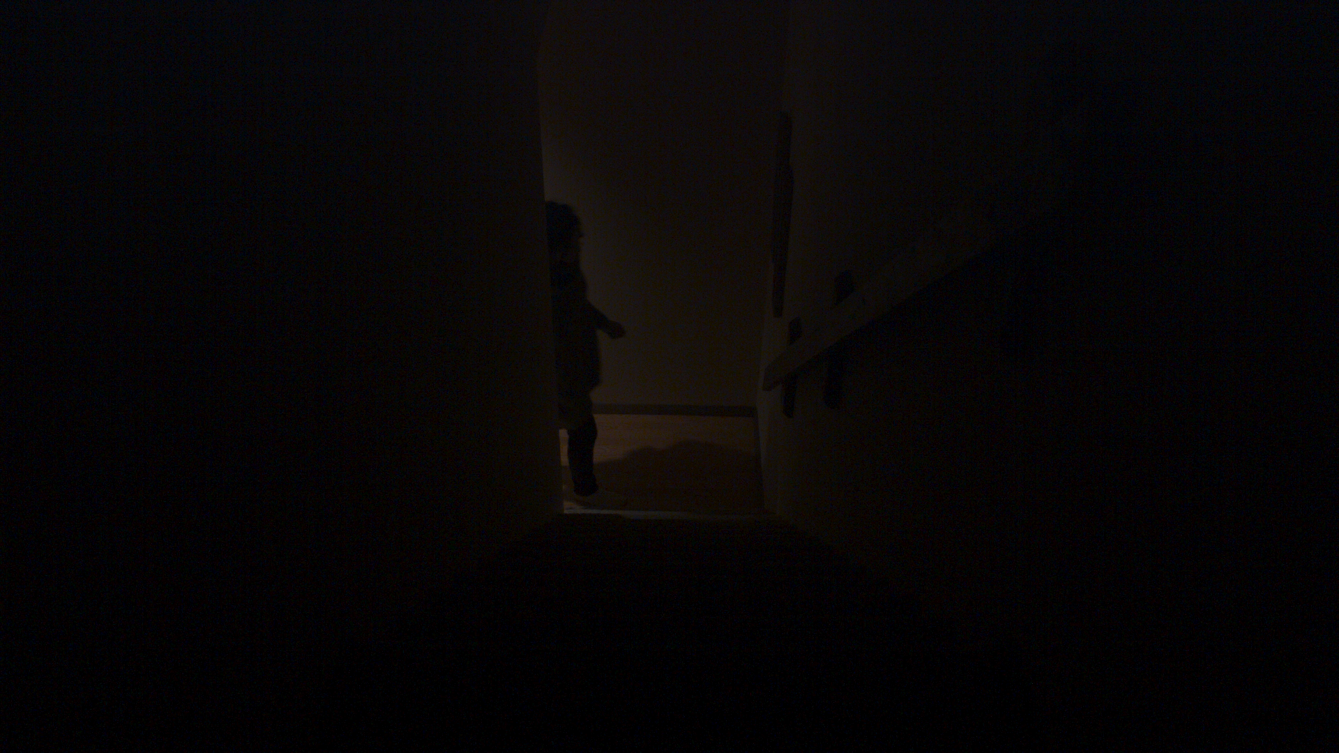

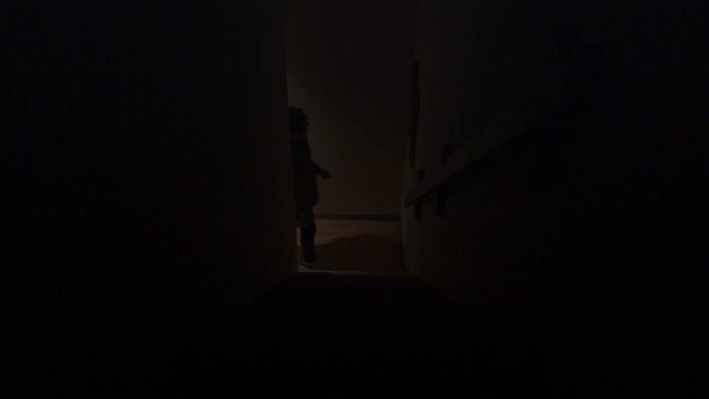

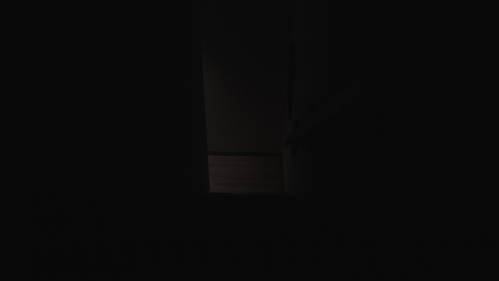

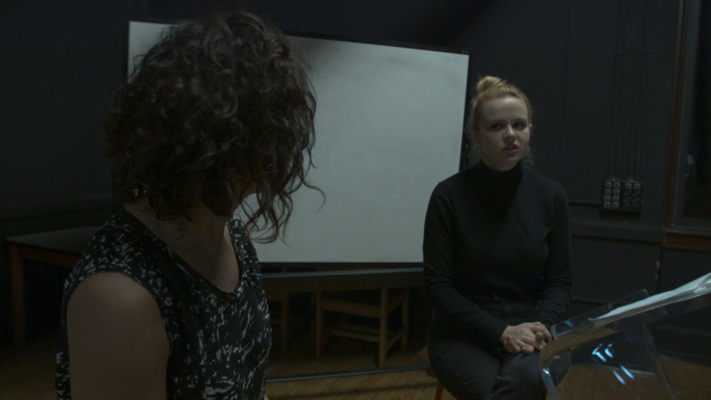

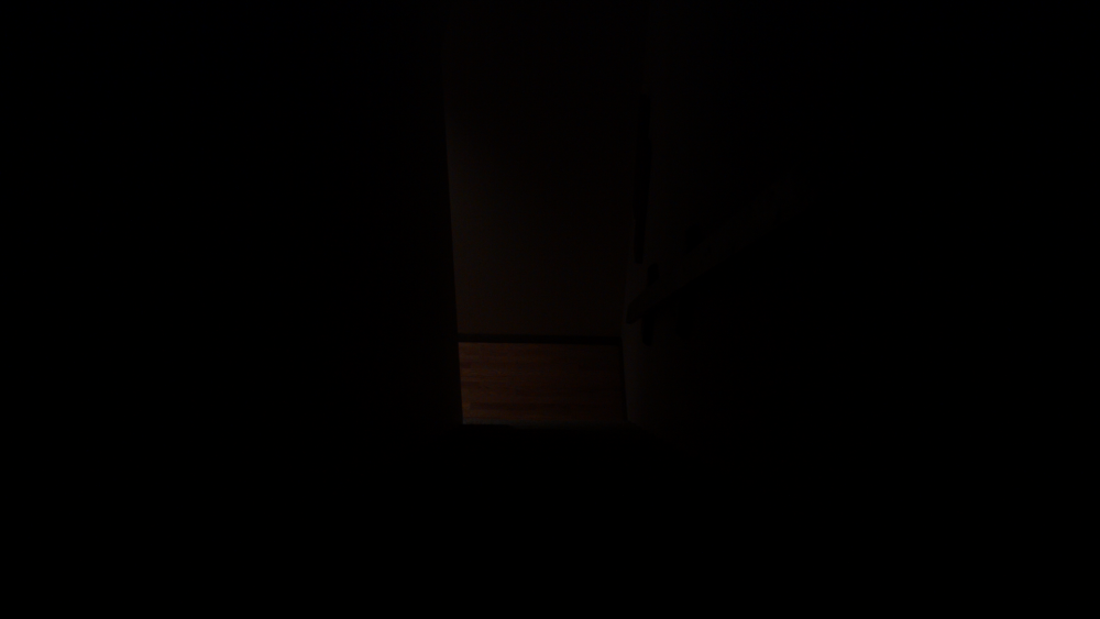

Turboguard Posted May 20, 2016 Share Posted May 20, 2016 So again, I'm coloring some stuff at the moment, and during my initial rough cut edit in Premiere all footage looks good, except for an interior scene. In premiere, it looks totally useable, but when I open it up in DaVinci, it's completely f***ed, BOTH BMD color space and REC.709 shows the same kind of underexposed, crushed black phenomenon. I understand that REC.709 handles the contrast, but again, it's in BOTH. Why is this happening? DNG RAW in Premiere untouched. RAW set to REC.709 in DaVinci Here's another example; BMD in DaVinci DNG in Premiere REC.709 in DaVinci I feel like, when I push exposure in DaVinci to achieve same exposure as in Premiere, I just introduce extreme grain. Ugh, I'm so confused. Link to comment Share on other sites More sharing options...

Turboguard Posted May 20, 2016 Author Share Posted May 20, 2016 On 5/20/2016 at 7:13 PM, Inazuma said: Doesn't Davinci have a noise reduction control for raw files though? Expand I only have resolve, not Studio... What's confusing is how I can get a better picture with PP than DaVinci for the extreme low light scenes. Link to comment Share on other sites More sharing options...
iaremrsir Posted May 20, 2016 Share Posted May 20, 2016 Premiere defaults to sRGB which is brighter than BT.709. Adobe also has a default curve it uses before conversion to sRGB if I remember correctly. BMD Film also has a relatively low middle gray point and black point at 392 and 36 respectively on a 10b scale. So BMD Film's middle gray is actually lower than sRGB and BT.709. Also, because each program uses different methods to do color conversions, you'll find that each program can produce a different results. Adobe uses the DNG SDK while Resolve uses libraw which is based on dcraw. DNGs are not like ARRIRAW, Sony RAW, or REDCODE. All of those have specific SDKs and using those are the only way you can process those raw files. In order to use a different method, you'd have to reverse engineer the formats. But since the DNG/TIFF is an open standard it's not hard for programmers to put together their own processing pipeline. It just comes down to programmers using different methods to process the same data. sudopera 1 Link to comment Share on other sites More sharing options...
Turboguard Posted May 20, 2016 Author Share Posted May 20, 2016 On 5/20/2016 at 7:27 PM, iaremrsir said: Premiere defaults to sRGB which is brighter than BT.709. Adobe also has a default curve it uses before conversion to sRGB if I remember correctly. BMD Film also has a relatively low middle gray point and black point at 392 and 36 respectively on a 10b scale. So BMD Film's middle gray is actually lower than sRGB and BT.709. Also, because each program uses different methods to do color conversions, you'll find that each program can produce a different results. Adobe uses the DNG SDK while Resolve uses libraw which is based on dcraw. DNGs are not like ARRIRAW, Sony RAW, or REDCODE. All of those have specific SDKs and using those are the only way you can process those raw files. In order to use a different method, you'd have to reverse engineer the formats. But since the DNG/TIFF is an open standard it's not hard for programmers to put together their own processing pipeline. It just comes down to programmers using different methods to process the same data. Expand Got it. I could find a pretty similar range with Rec.709 and Gamma 2.4. BUT so much noise now Link to comment Share on other sites More sharing options...
iaremrsir Posted May 20, 2016 Share Posted May 20, 2016 You can try using the luma v sat curve and keep the saturation low in the deep shadows. That will reduce the appearance of color noise while retaining the texture. Link to comment Share on other sites More sharing options...
