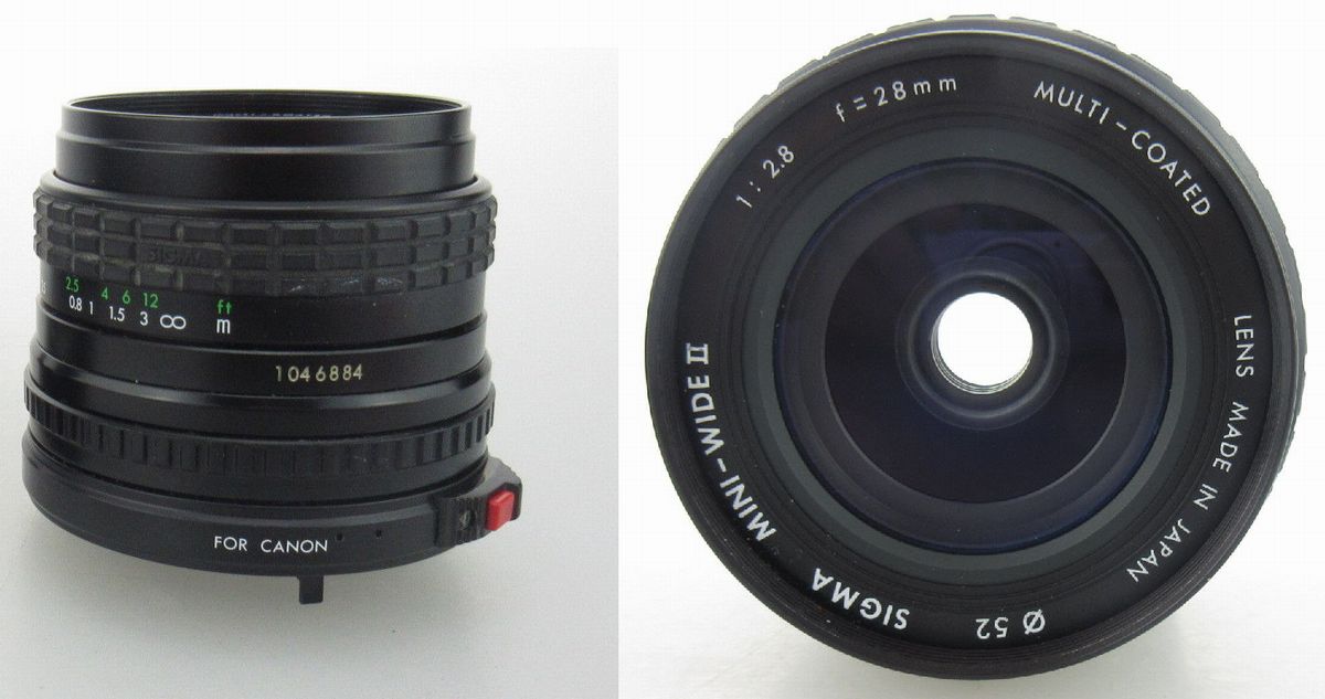

Michael Coffee Posted May 24, 2016 Share Posted May 24, 2016 My Vivatar f2.8 (rebranded Sigma super wide II) has about 270 degree focus throw.. PannySVHS 1 Link to comment Share on other sites More sharing options...

PannySVHS Posted May 25, 2016 Author Share Posted May 25, 2016 13 hours ago, Michael Coffee said: My Vivatar f2.8 (rebranded Sigma super wide II) has about 270 degree focus throw.. Hey, great! Which one of the Vivitars is the rebranded super wide II? Unfortunately on the Sigma Focus throw between 3m and infinity is also ultra short, 7 hours ago, Liam said: Sorry if that was wordy Hey Liam, not wordy at all, great points! 1 hour ago, Justin Bacle said: Minolta Rokkor 28/3,5 -> Nice image quality, quite contrasty. Decent focus throw and well damped. Hey Justin, how much is the focus throw, half turn, 360, 270, how much in inches between 3m(9ft) and infinity? On the nFD 28mm it´s only half an inch between 3 and infinity. 12 hours ago, TheRenaissanceMan said: Iirc, the Contax Zeiss 28mm lenses and the 28-85 f/3.4-4 all have really nice big focus throws. I would guess the Leica R 28mm elmarit is similarly good, but I haven't used it and don't have a good enough connection here at work to Google it. Hey, pricey, pricey:) The Elmarit seems to have a short throw between 3 and infiity as well, might be stell difficuilt to do focussing changes while recording video within that distance range. Link to comment Share on other sites More sharing options...

Michael Coffee Posted May 27, 2016 Share Posted May 27, 2016 My Yashica 28mm also has about 270 degrees throw On 5/25/2016 at 7:08 PM, PannySVHS said: Hey, great! Which one of the Vivitars is the rebranded super wide II? Unfortunately on the Sigma Focus throw between 3m and infinity is also ultra short, Hi, just looked and it is actually a Promaster 28mm f2.8 - not a Vivitar! Its supposed to be a rebrand of the Sigma mini wide II ... Good long focus throw PannySVHS 1 Link to comment Share on other sites More sharing options...
