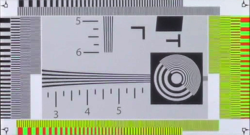

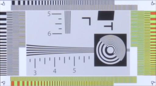

Vesku Posted June 4, 2016 Share Posted June 4, 2016 I think the Canon XC10 has quite soft 4k video. Here is comparison charts for 4k sharpness (Sony RX10 II vs Canon XC10 from Slashcam. https://www.slashcam.de/artikel/Test/Canon-XC10---geschrumpfte-C300---Sonstiges---Aus-dem-Messlabor.html#Aus_d CANON SONY Jn- and vasboz 2 Link to comment Share on other sites More sharing options...

Guest Ebrahim Saadawi Posted June 4, 2016 Share Posted June 4, 2016 Not this conversation again. C-log disables all and ANY kind of in-camera sharpening even the one that happens beforr the debayer stage. The XC10 4K C-LOG is SOFT, lacks sharpness, it doesn't lack RESOLUTION. While the Sonys and nx1 and such add a ton of in-camera sharpening that cannpt be turned off, hence why some are saying until now everywhere the xc10 is below 4k nd soft, while it actually resolves 3100 TV lines horizontally and 1700 lines vertically, hitting the limit of UHD resolution from a bayer-pattern camera. if you own the xc10 and find it soft, switch to Standard picture profile and it turns into a sony/samsung clarity/sharpness wise, try it. Or of course better yet use post sharpening to the c-log 305mbps 422 footage. Link to comment Share on other sites More sharing options...

Administrators Andrew Reid Posted June 4, 2016 Author Administrators Share Posted June 4, 2016 Sharpness: digitally applied Resolution: number of megapixels on the sensor Final image: a combination of sensor readout, image processing, compression, noise and all sorts of things - and yes digital sharpening in-camera or in-post People need to start noticing when an image has been sharpened so they don't mistake this for better resolution. Because it is preferable NOT to have it done in-camera. Nathan Gabriel, Mat Mayer and kidzrevil 3 Link to comment Share on other sites More sharing options...
