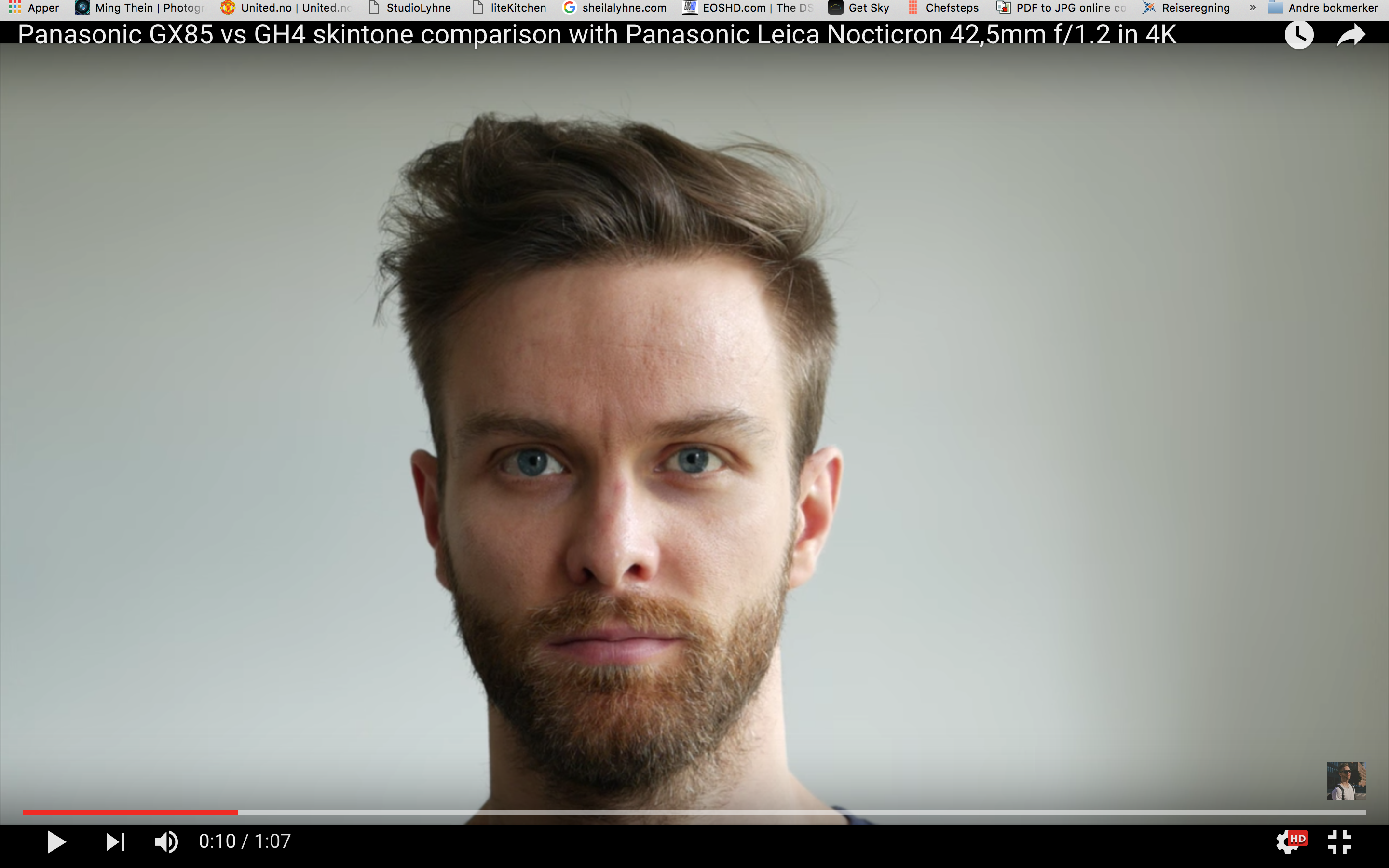

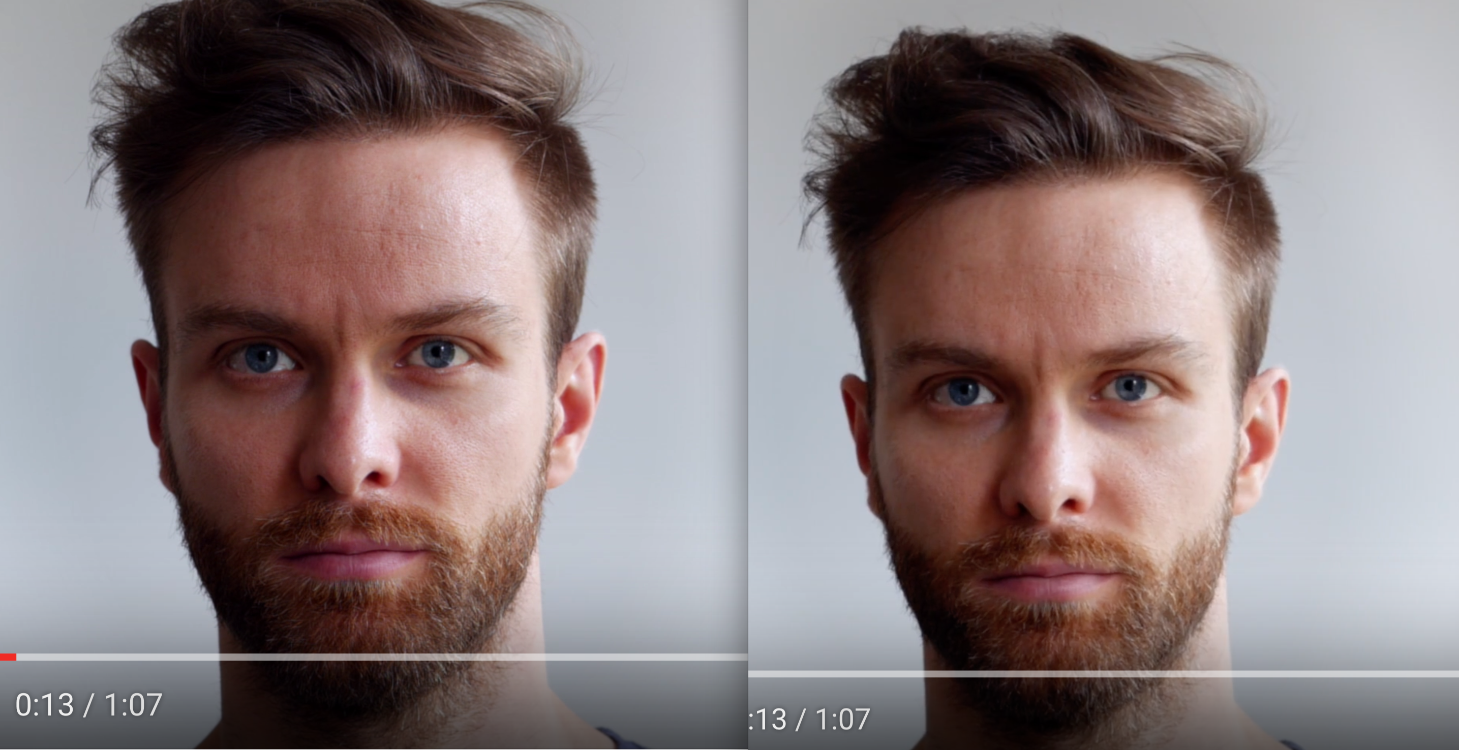

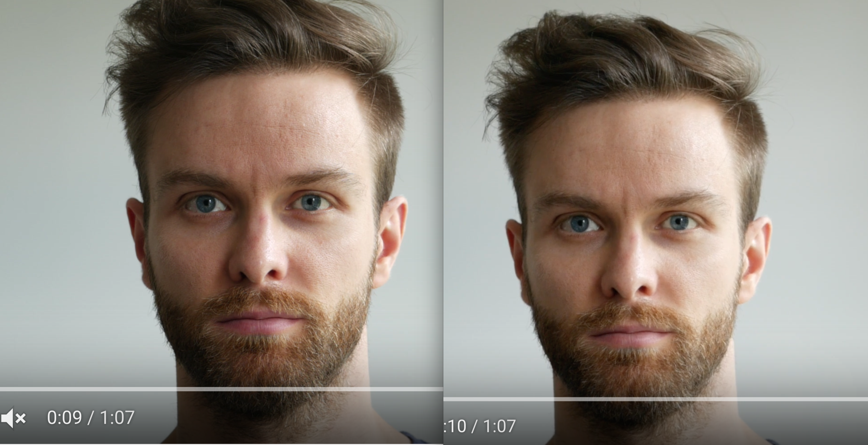

Fredrik Lyhne Posted June 19, 2016 Share Posted June 19, 2016 Some of you saw my skin tone comparison with the GX85 and GH4 that I uploaded last week and most people seem to prefer the ungraded image from the GX85 . That's fine with me as both grades were a little off. But I obviously had to take a closer look to see if I agreed. I suspected that youtube is doing something with the colors when I upload in 4K and it seems I was right. I uploaded a 1080p version and made a side by side comparison. For some reason youtube seems to add magenta when uploading in 4K. The result is that the ungraded footage of GX85 looks better and the graded image (which was a little too much in the first place) looks a lot worse. Has anyone else noticed this and is there a way to avoid it? 4K is on the left and 1080p on the right. Blue Fox 1 Quote Link to comment Share on other sites More sharing options...
Cas1 Posted June 19, 2016 Share Posted June 19, 2016 Interesting discovery! What I notice is the colour in the back ground. Checking the colours in a photo editor, I see the following values: top left photo: topside back ground: R 176 - G 180 - B 176 lower side back ground: R 188 - G 198 - B 198 top right photo: topside back ground: R 177 - G 183 - B 177 lower side back ground: R 196 - G 204 - B 204 lower left photo: topside back ground: R 165 - G 166 - B 169 lower side back ground: R 186 - G 192 - B 203 lower right photo: topside back ground: R 175 - G 175 - B 177 lower side back ground: R 192 - G 198 - B 208 If I imagine a flat white back ground, I like the top skin colours a bit too green and warm, and the lower ones much too purple. When I adjust the white balance for the top left face, I can get a very pleasing result. Adjusting the WB on the others I can have good result too. Maybe, to make things comparable, record using the same manual WB settings? Maybe let the talent hold a colour checker, to measure the differences in the colour profiles, and see what has shifted where? Fredrik Lyhne 1 Quote Link to comment Share on other sites More sharing options...

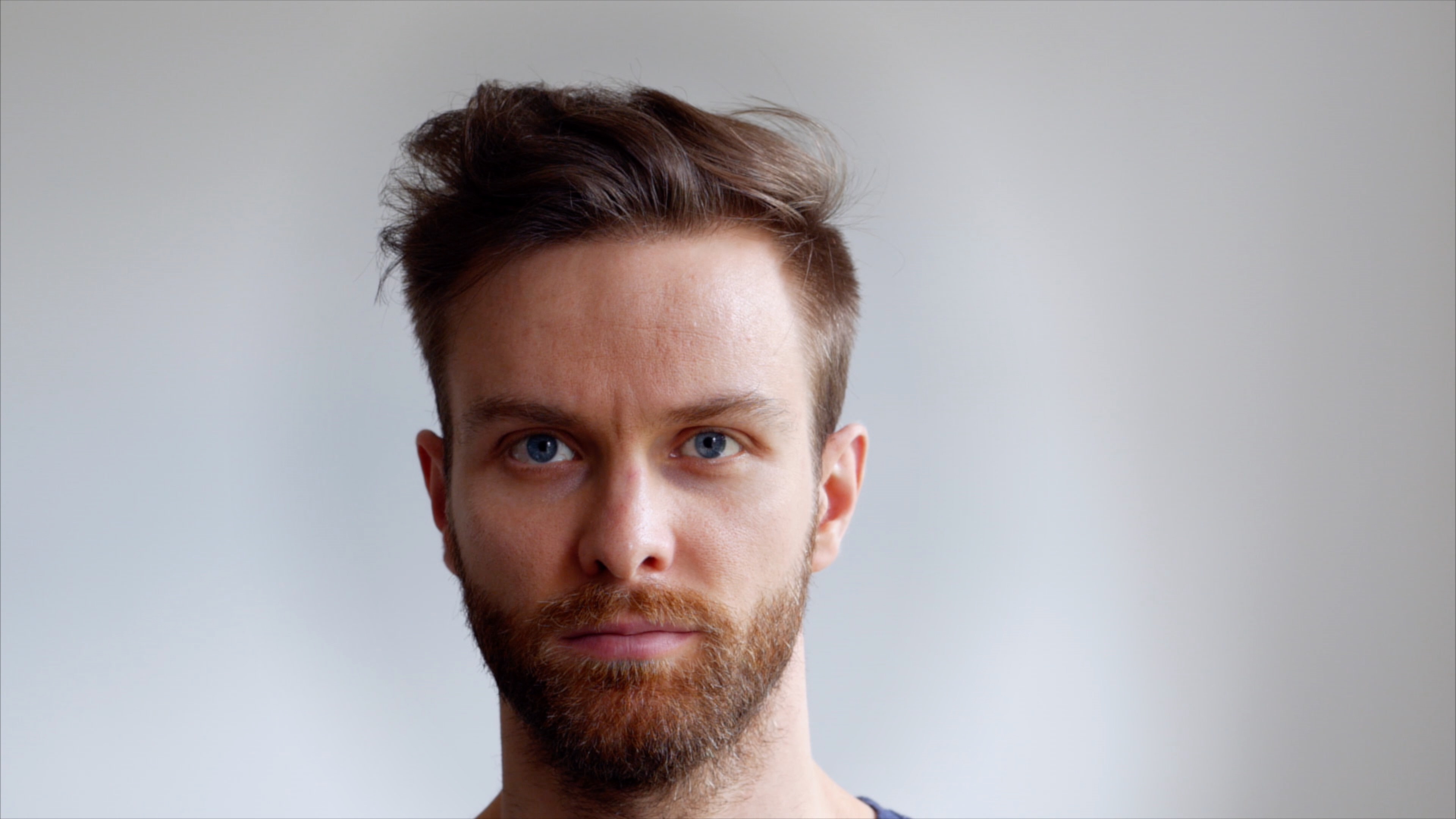

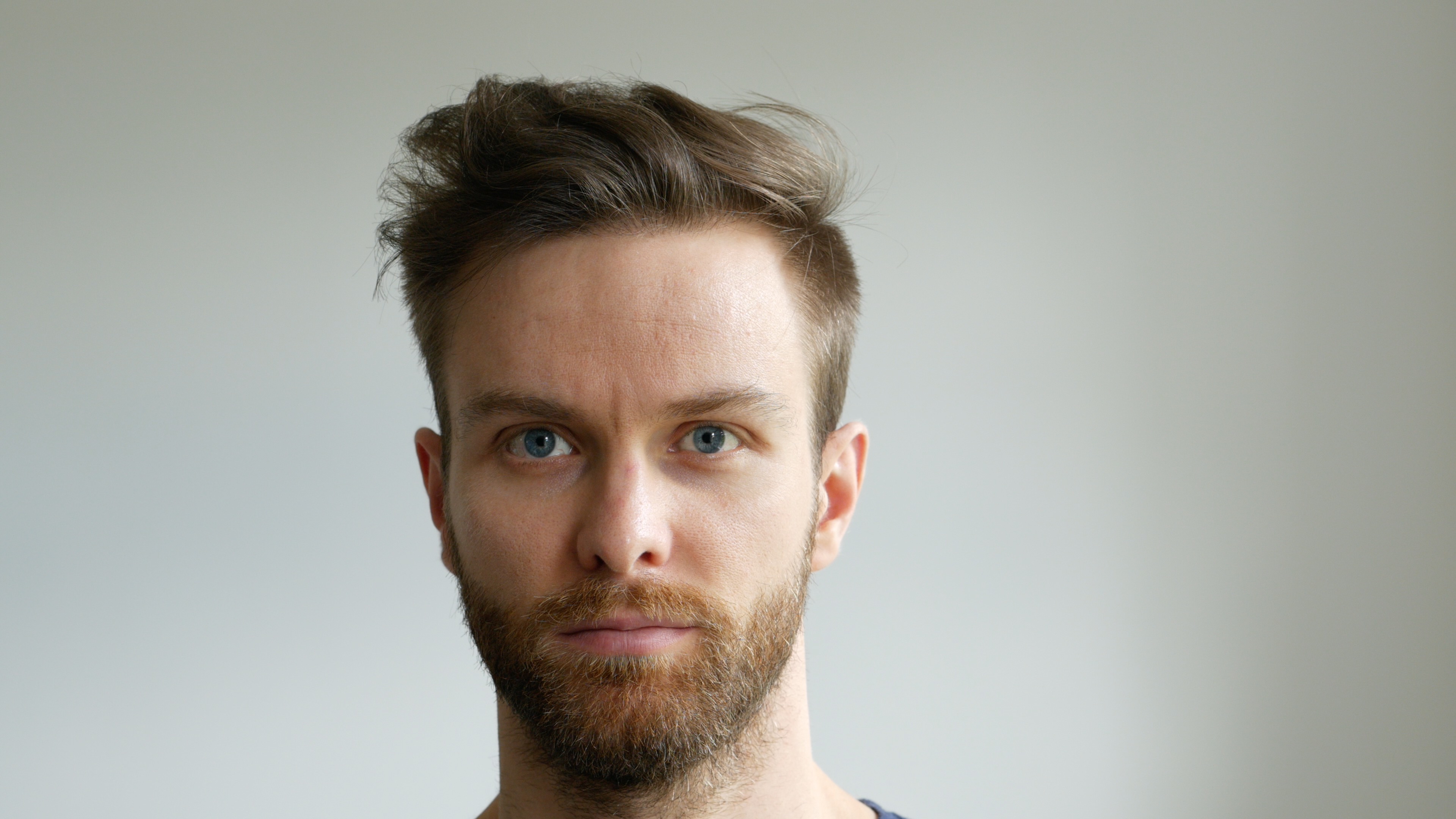

Fredrik Lyhne Posted July 5, 2016 Author Share Posted July 5, 2016 2 hours ago, Orangenz said: Can you post a 4k graded frame from your timeline to compare with the youtube result? I found the video interesting quite apart from the graded parts. Sure. Here is a ungraded grab from FCPX from the GX85: And here is one from youtube: What do you make of it? Quote Link to comment Share on other sites More sharing options...
Orangenz Posted July 8, 2016 Share Posted July 8, 2016 Graded grab, not ungraded Quote Link to comment Share on other sites More sharing options...
Fredrik Lyhne Posted July 8, 2016 Author Share Posted July 8, 2016 Graded GX85 grab. Quote Link to comment Share on other sites More sharing options...
