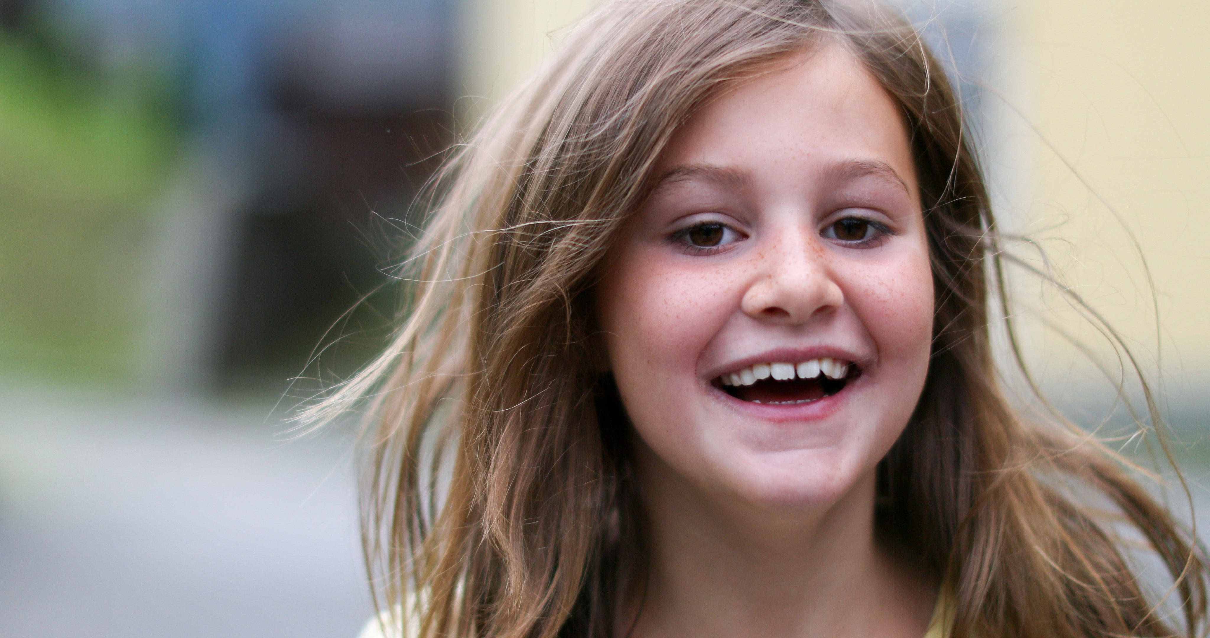

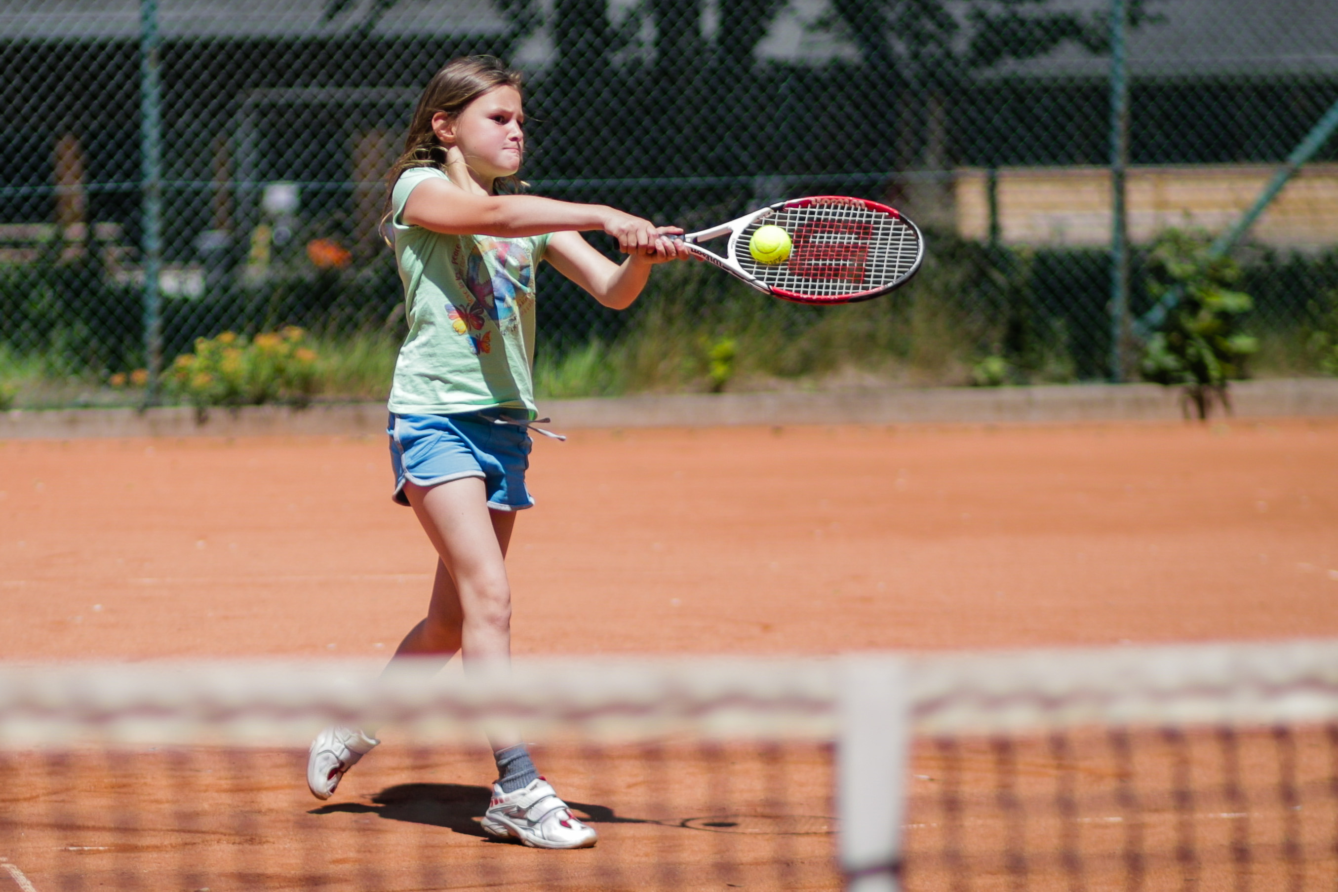

gt3rs Posted July 4, 2016 Author Share Posted July 4, 2016 I did a couple of experiments to see how good is the DPAF in the 1Dx II. Youth girl running in front of me while running with the Ronin M, Face tracking, Canon 50 1.2 at 1.2 (shutter speed was 1/3200 to rule out any motion blur while evaluating frame by frame focus). Screen grab: Youth girl playing tennis from a tripod using Face tracking AF with a Canon 85mm 1.8 at 1.8 (shutter speed was 1/4000 to rule out any motion blur while evaluating frame by frame focus). Screen grab: If the face is visible the AF really sticks to it. In both video the face was in focus for during the whole video length. Naturally face tracking does not work well or not at all for lateral shoots. I will soon test it with an adult athlete but so far I’m quite impressed. jcs 1 Link to comment Share on other sites More sharing options...

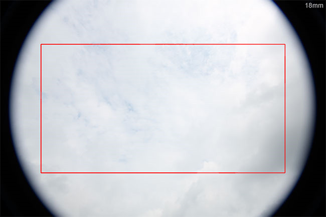

gt3rs Posted July 11, 2016 Author Share Posted July 11, 2016 I don't own any sigma lenses. I did take a look at the 18-35 but as I do a lot of photography too it is not worth for my use case. But if you do mostly video it could work. TDP did a test on the 5D III and as you can see it will probably work on the ca. 1.3 crop on the 4k mode. TDP test: http://www.the-digital-picture.com/Comparisons/Sigma-18-35mm-f-1.8-DC-HSM-Lens.aspx#FULLFRAME 1DX II 4k DCI overlay: Ak Ns 1 Link to comment Share on other sites More sharing options...
