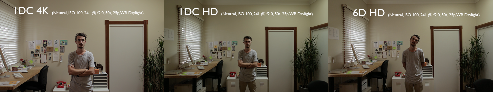

Flameproof Moth Posted March 9, 2017 Share Posted March 9, 2017 It doesn't just happen in the CLOG. I've noticed with mine that even on the neutral picture profile with matching settings the 1DC shifts in the green channel between 4K and HD. Super weird, I compared it with the 6D's HD with matching white balance settings and the HD on the 1DC doesn't match the 6D, however, the 6D does match the 1DC in 4K colour wise. Do you get this aswell or is it just my 1DC?? Hope not : / Link to comment Share on other sites More sharing options...

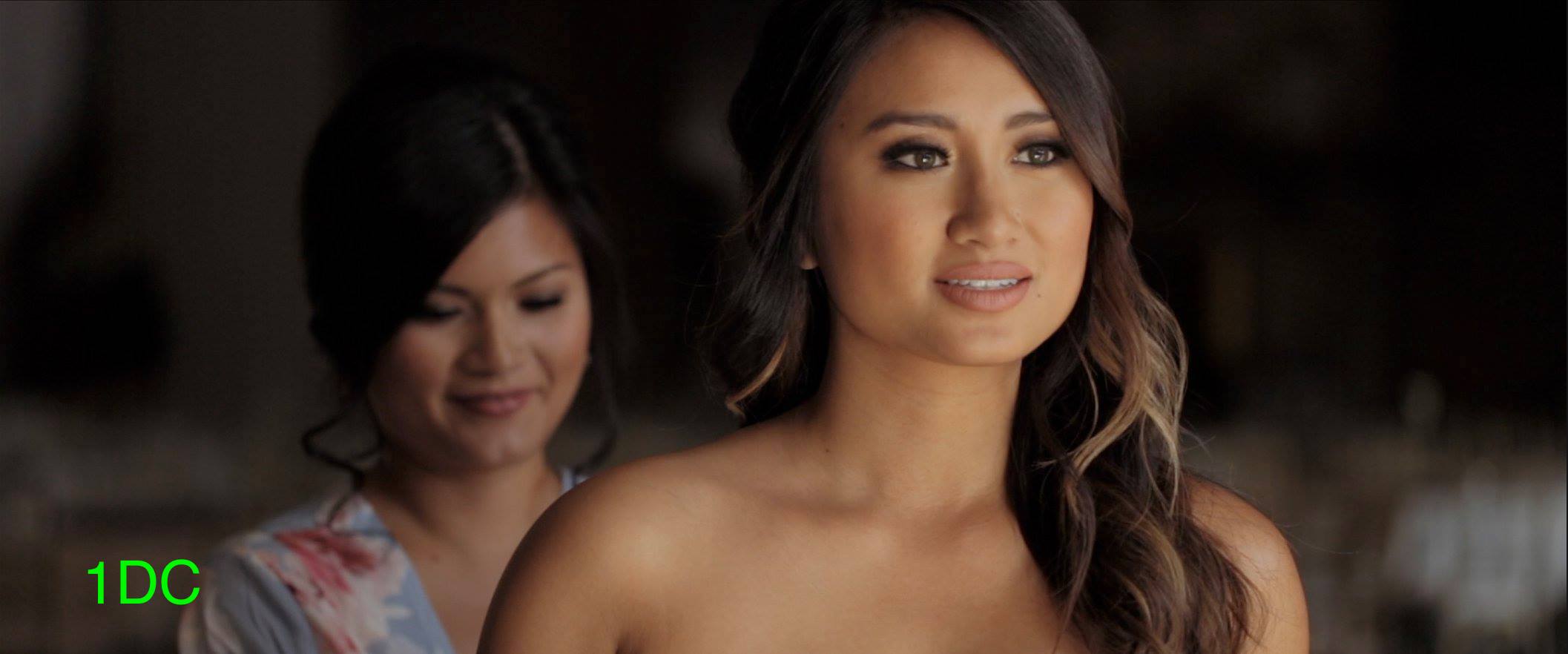

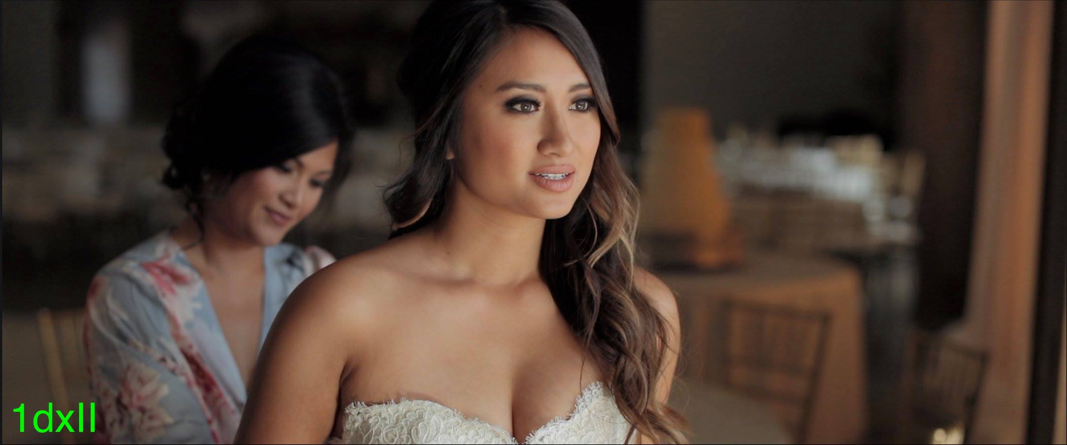

Matthew19 Posted March 12, 2017 Author Share Posted March 12, 2017 On 3/8/2017 at 8:33 PM, Flameproof Moth said: It doesn't just happen in the CLOG. I've noticed with mine that even on the neutral picture profile with matching settings the 1DC shifts in the green channel between 4K and HD. Super weird, I compared it with the 6D's HD with matching white balance settings and the HD on the 1DC doesn't match the 6D, however, the 6D does match the 1DC in 4K colour wise. Do you get this aswell or is it just my 1DC?? Hope not : / Yep my 1DC in HD is more green than my 1dxII. The 1DXII colors are a little nicer IMO - this was same WB same time : Link to comment Share on other sites More sharing options...
