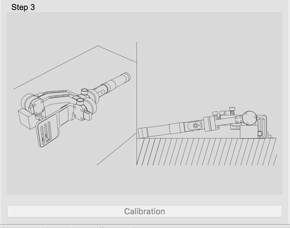

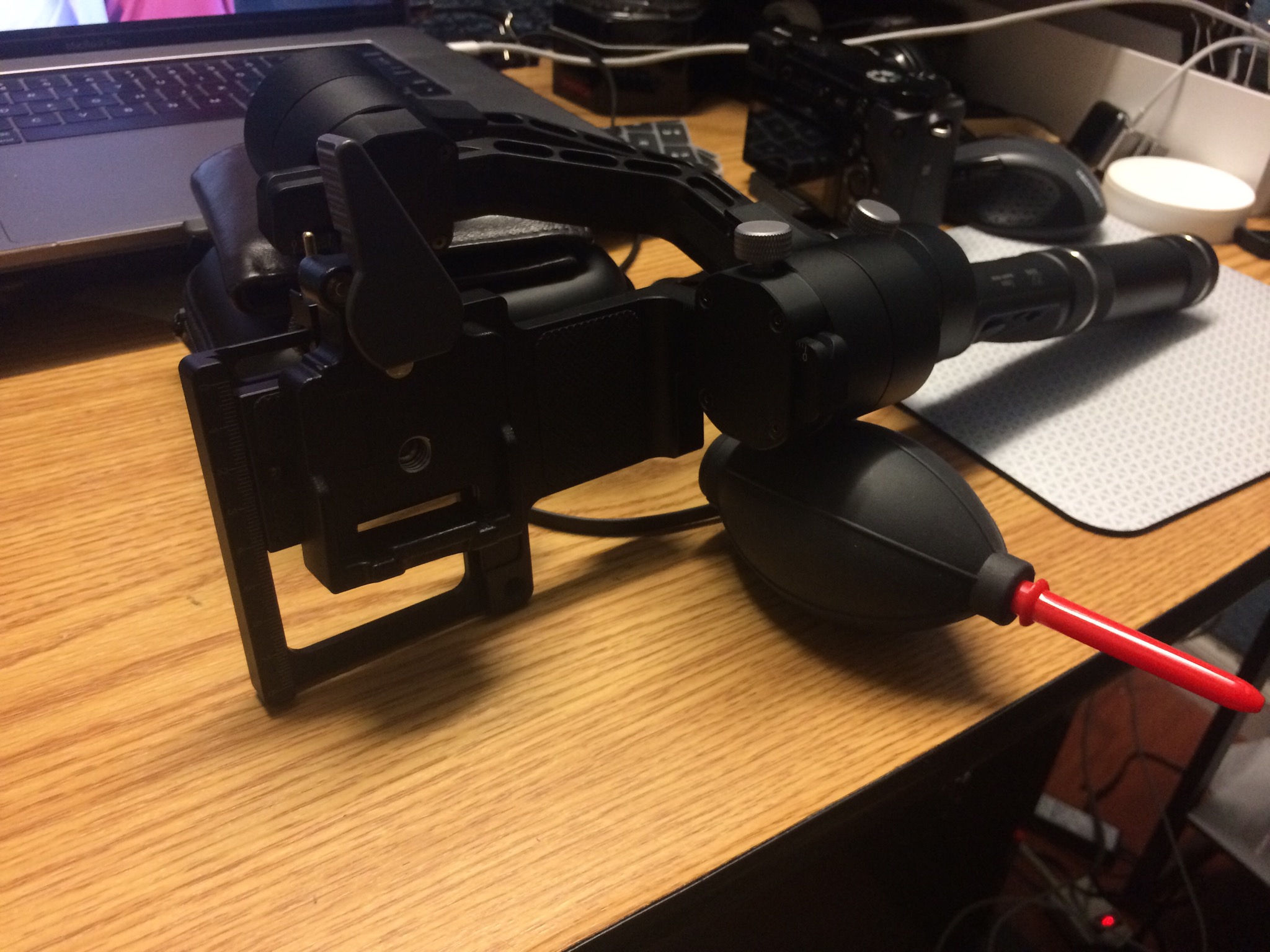

Bukobrandon Posted July 31, 2017 Share Posted July 31, 2017 I have the zhiyun v2 and I've been facing problems recently where when I pan in locking or follow mode and my camera begins horizontal , it starts to roll as I pan it. It use to just pan and stay horizontal but now it's goes diagonally. I've tried to recalibrate but I can't even get past the third step. I've tried with and without release adapter as well and have tried without putting stuff beneath the motors as well. IMG_0890.MOV IMG_0890.MOV Link to comment Share on other sites More sharing options...
