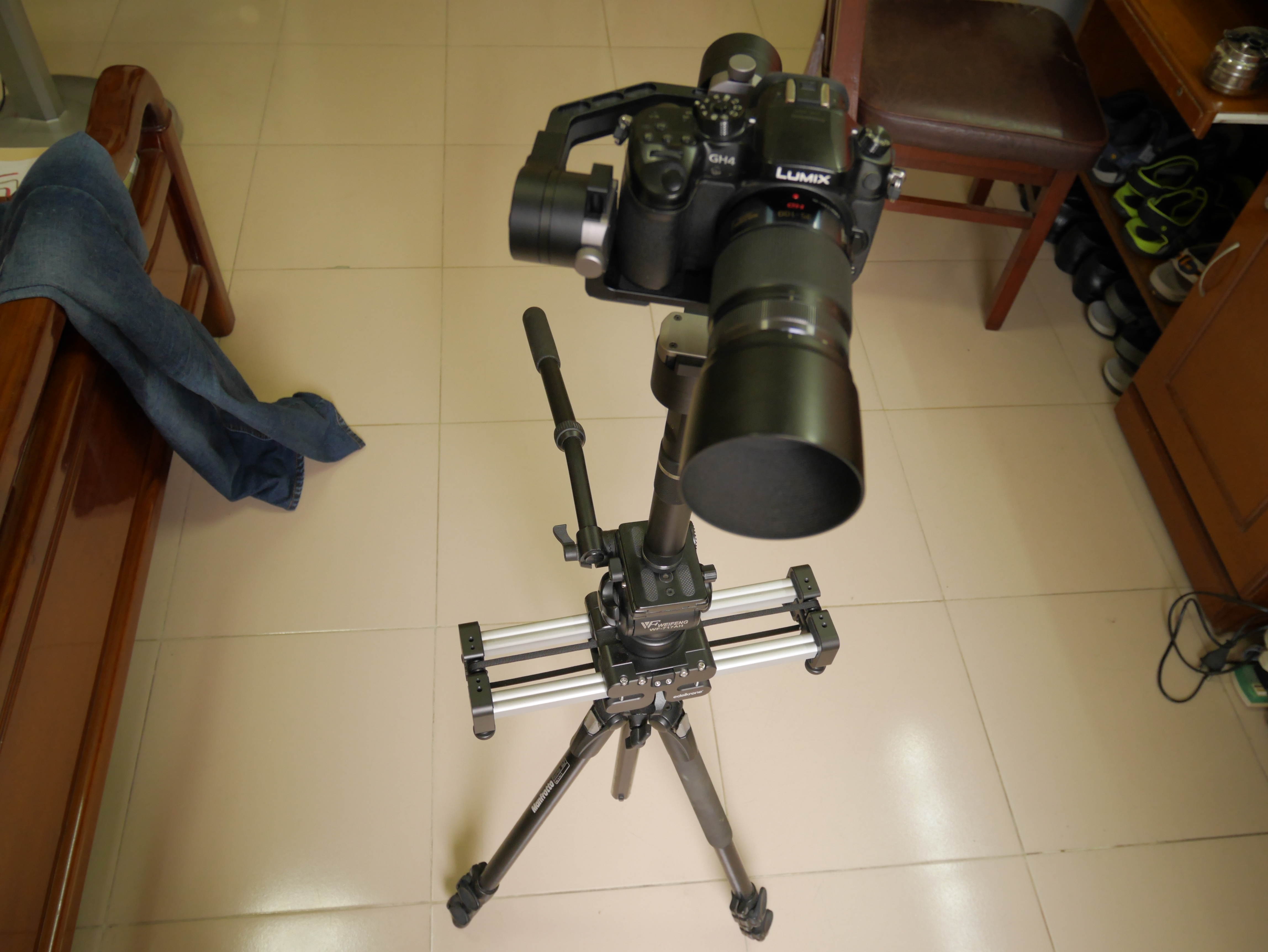

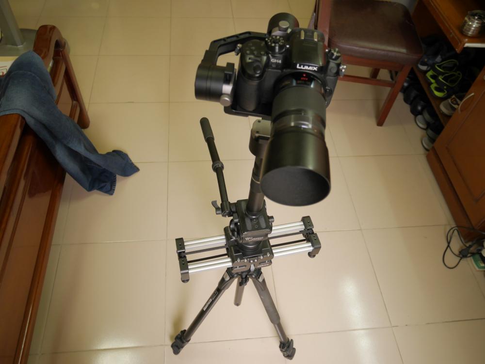

jonpais Posted August 15, 2016 Share Posted August 15, 2016 15 hours ago, Zach Fine said: They should add that slogan to the product brochure! I'm not laughing too loudly -- her English is much better than my Mandarin. I understood the meaning, she's got lots of faith in their product. I could possibly test my GH4 with a Speed Booster and Tokina 11-16mm f/2.8, which comes to 1,288 grams, and isn't front heavy at all, but that would't answer your question about a combination weighing in at around 1500 grams. Not sure how useful that would be anyhow, since I shake like the devil and even if I posted the results, they'd probably look horrible. The other lenses in my collection, such as the Sigma 18-35mm f/1.8 and 50mm f/1.4, would be very front heavy, as are most fast APS and full-frame lenses mounted on a mirrorless camera, and since they greatly exceed the weight limit, I wouldn't be willing to experiment with them, since I can't afford to keep replacing my gimbal. I wonder why Ivanka hasn't responded to your request to see some samples? I could pose for a picture with an Alexa mounted on the stabilizer and post it on Instagram - it wouldn't mean anything at all. No footage on YouTube, either, so color me skeptical. Someone already beat me to it. Looks fine to me. Link to comment Share on other sites More sharing options...
