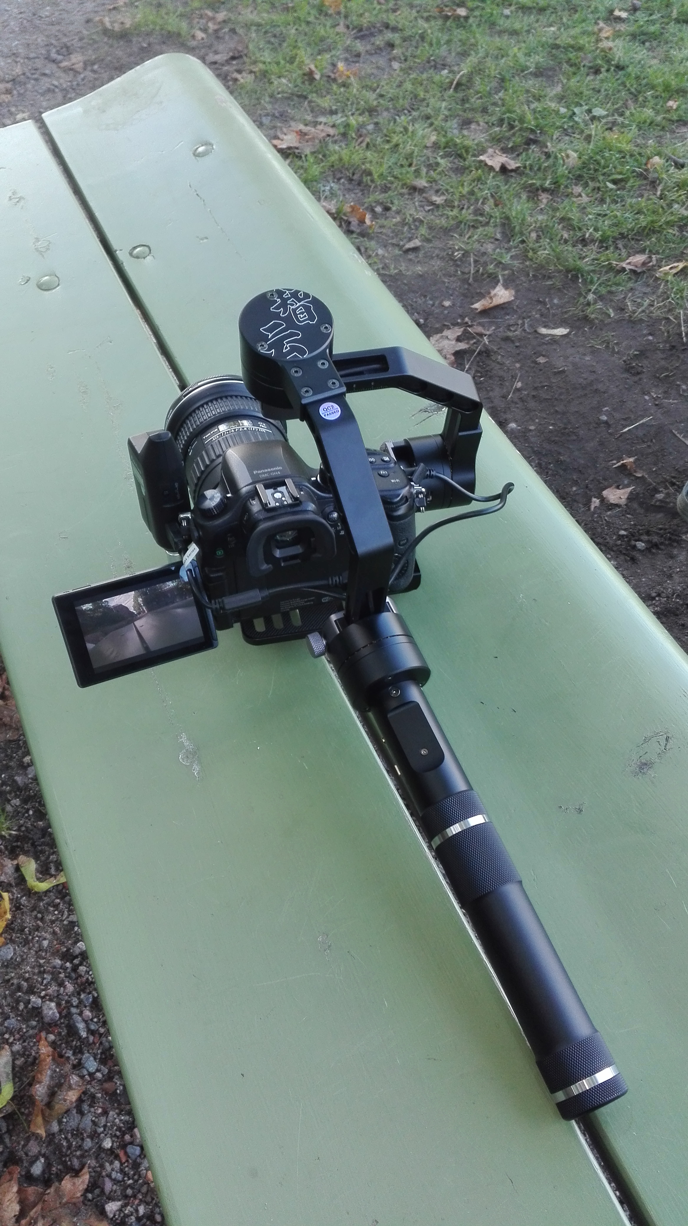

eekamouse Posted August 29, 2016 Share Posted August 29, 2016 I'll try and get a photo of my setup, but I've got the Micro Cinema camera on my crane, necessitating the need of an external monitor(SmallHD DP4). I have a SmallHD articulating arm mounted to the bottom 1/4 20 thread in the handle and a 3ft slim Monoprice HDMI cable plugged into a right angle HDMI adapter into the Micro. To be honest, having come from using Glidecams and Steadicam stabilizers, it's not much different from looking down at a monitor on a sled. With a SLR Magic 12mm(1st gen) and a Fader vari-ND, in conjunction with the Smallrig cage, I'm a little over 1200g but it seems to have no problem with the weight nor having an HDMI dangling downwards. As Mattias mentioned earlier, having an HDMI cable running to an external monitor would prohibit the gimbal from panning 360 degrees, and going to inverted mode will require some adjustment to the noga arm and monitor, but it can be done. Phil A 1 Link to comment Share on other sites More sharing options...

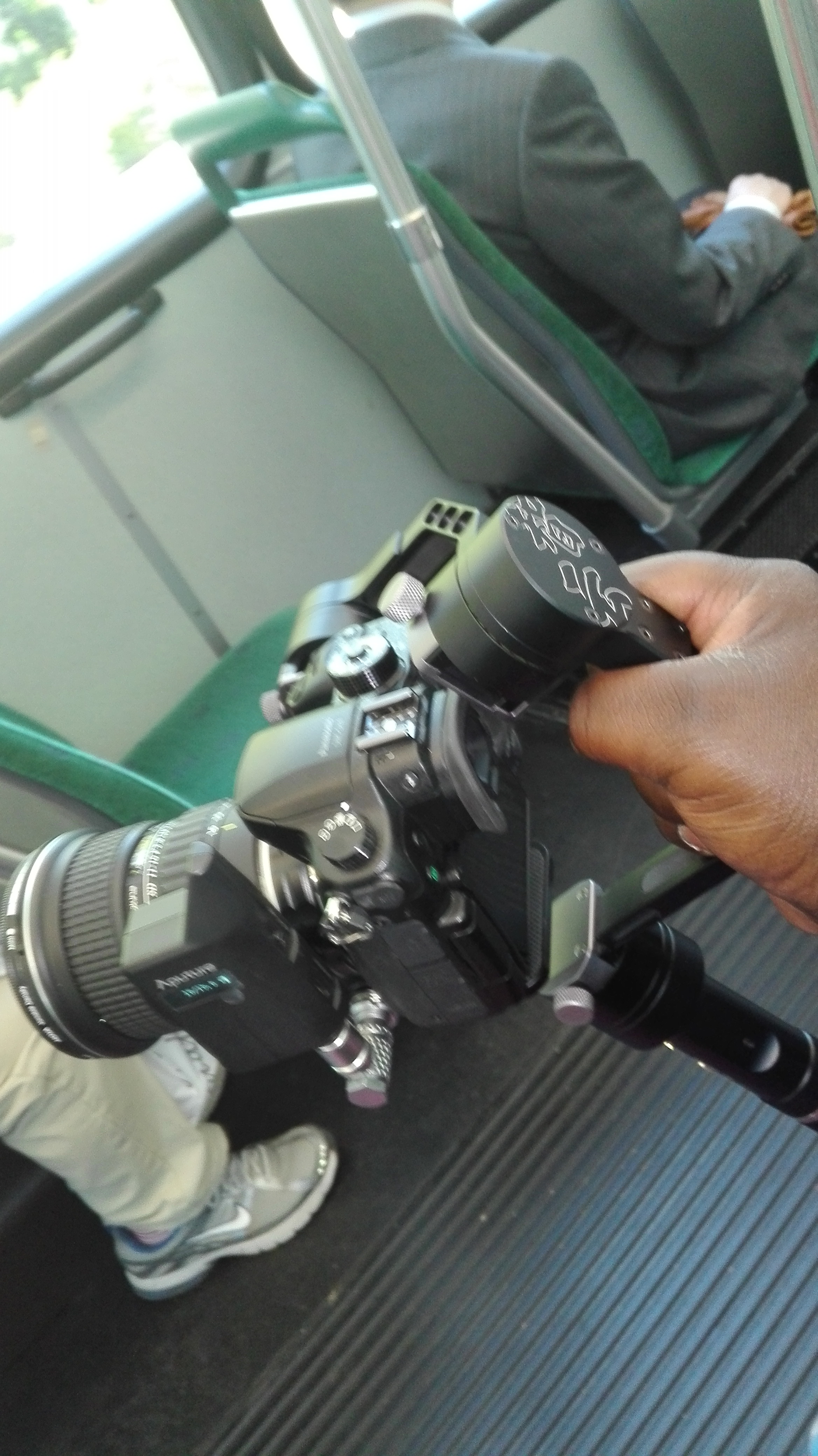

HelsinkiZim Posted August 31, 2016 Share Posted August 31, 2016 I just finished a days shoot with the Zhiyun Crane, and it is impressive. I ha the Came Mini 2 before, an swore to never use gimbals again because it was so cumbursome and finicky that you end up leaving it at home. But I bit the bullet and got the crane because the price was right and I simply need a steady/shot system for some parts of my work. So in summary... The batteries lasted for 4 hours pretty much being constantly on. I would say you are safely within 3 hours of continuous use. Then you pop in the spares and good to go. It is solid and sturdy, and when it goes nuts due to doing something silly, just switch off an on and its like nothng ever happened. Not like the Mini which punishes your horizons for being rough with it. Yes, it can take a Tokina 11 to 16 WITH a speedbooster... in this instance it I used a Aputure LensRegain, so it is a speedbooster with a transmiter where I can control focus and aputure with a grip, and I had a lanc going into the GH4 so the rip can also stop and start recording. You basically never need to touch the camera unless you want to zoom or twst the Vari ND. So tokina with metabones is likely to work as this was a heavy set up. I tried to add a Rode videomic pro Rycote and that tip it over the edge and it started getting jiggy with it. All shots were steady as anyone elses on youtube, but it helps if you have experience balancing more finicky gimbals as you know which axis you will need the most for you shot and you make sure that one has the least resistance, as it never properly balances when switched off. You gotta have faith and switch it on and viola. Anyways, I would recommend... Sorry for the bad grammer but my laptop keyboard is speaking another language and microsoft just shrugs when I ask it for help. Link to comment Share on other sites More sharing options...
