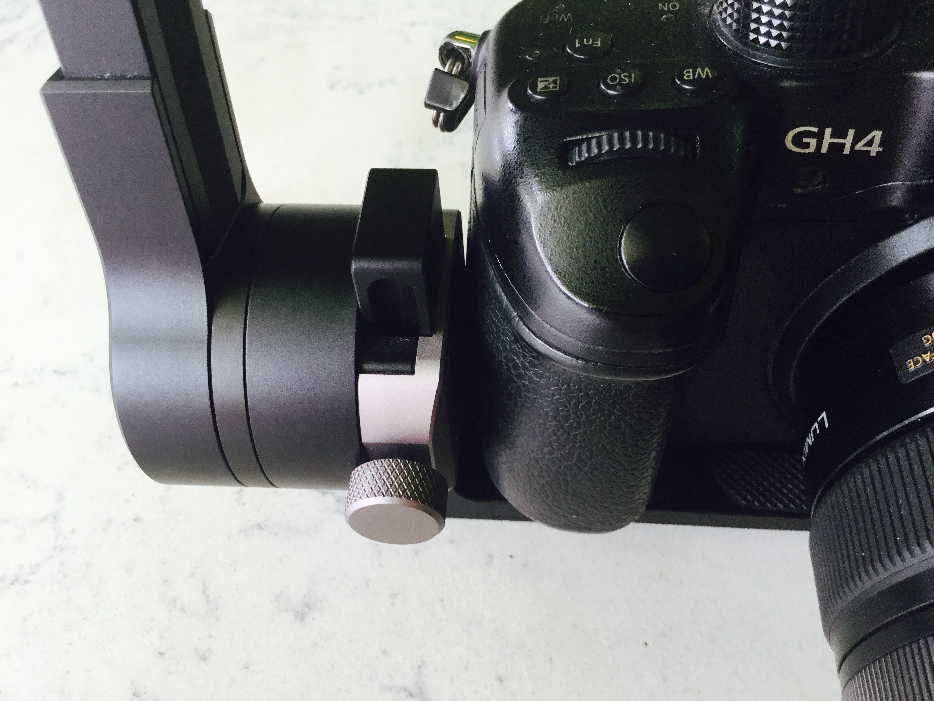

BasiliskFilm Posted September 7, 2016 Share Posted September 7, 2016 2 hours ago, jonpais said: I've seen tests of the Crane with the Samsung NX1 and the Sony A6300, both with 16-50mm zoom lenses, and they look incredible. 85mm, I don't recall ever seeing. You're better off with a compact zoom or prime. And yes, as long as you don't exceed the weight limit, static shots can resemble those made from a tripod. I tried shooting with my GH4 and 35-100mm f/2.8, and even though it's under the capacity of the stabilizer, the shots just weren't steady. I was trying to do tight close-ups. It's possible that part of the problem was the lens itself, which has always been a bit jittery. But even for a camera with 5-axis IBIS, tight close-ups can be a tough challenge. Yesterday, I watched a review of the new Leica 12mm f/1.4 Summilux (no OIS) mounted on a GX85, and even with IBIS enabled, shots of a flower were shaky. So for now, I stick with the 12-35mm f/2.8, always at the wide end. Also, if I'm doing a static shot for longer than, say, 30 seconds, I'll often rest the handle of the gimbal on my knee, a table, a chair, or whatever's handy, since my arms tire quickly. In the following, unedited, ungraded shot, I wasn't going out of my way to hold the camera still, just tried to keep it pointed in the right general direction. (GH4, Lumix G X Vario 12-35mm f/2.8, Hoya Pro 1 Digital UV filter, Crane) P1050407.MOV Close up shots will be a problem as the stabiliser is compensating for angular movement, not lateral movement. If you keep your camera level but move it up and down by a few mm, then on a close up of a flower a few mm movement will show. In the distance a few mm makes little difference. What would be interesting is if putting a gimbal on a cheap monopod to stabilise it further would give you the effect with a longer lens of using an heavy duty tripod. Needless to say, not having to carry around a heavy duty tripod with a fluid head is quite a cost and weight saving. Link to comment Share on other sites More sharing options...
jonpais Posted September 7, 2016 Share Posted September 7, 2016 6 hours ago, BasiliskFilm said: Close up shots will be a problem as the stabiliser is compensating for angular movement, not lateral movement. If you keep your camera level but move it up and down by a few mm, then on a close up of a flower a few mm movement will show. In the distance a few mm makes little difference. What would be interesting is if putting a gimbal on a cheap monopod to stabilise it further would give you the effect with a longer lens of using an heavy duty tripod. Needless to say, not having to carry around a heavy duty tripod with a fluid head is quite a cost and weight saving. When I first got the Crane, I did a bunch of shots with it attached to a Gorillapod. Lightweight, you can carry it around in your back pocket. A monopod is also a good idea for locked off shots. Heck, I was even able to mount the contraption on my Edelkrone slider, and the shots were smoother looking. Link to comment Share on other sites More sharing options...
