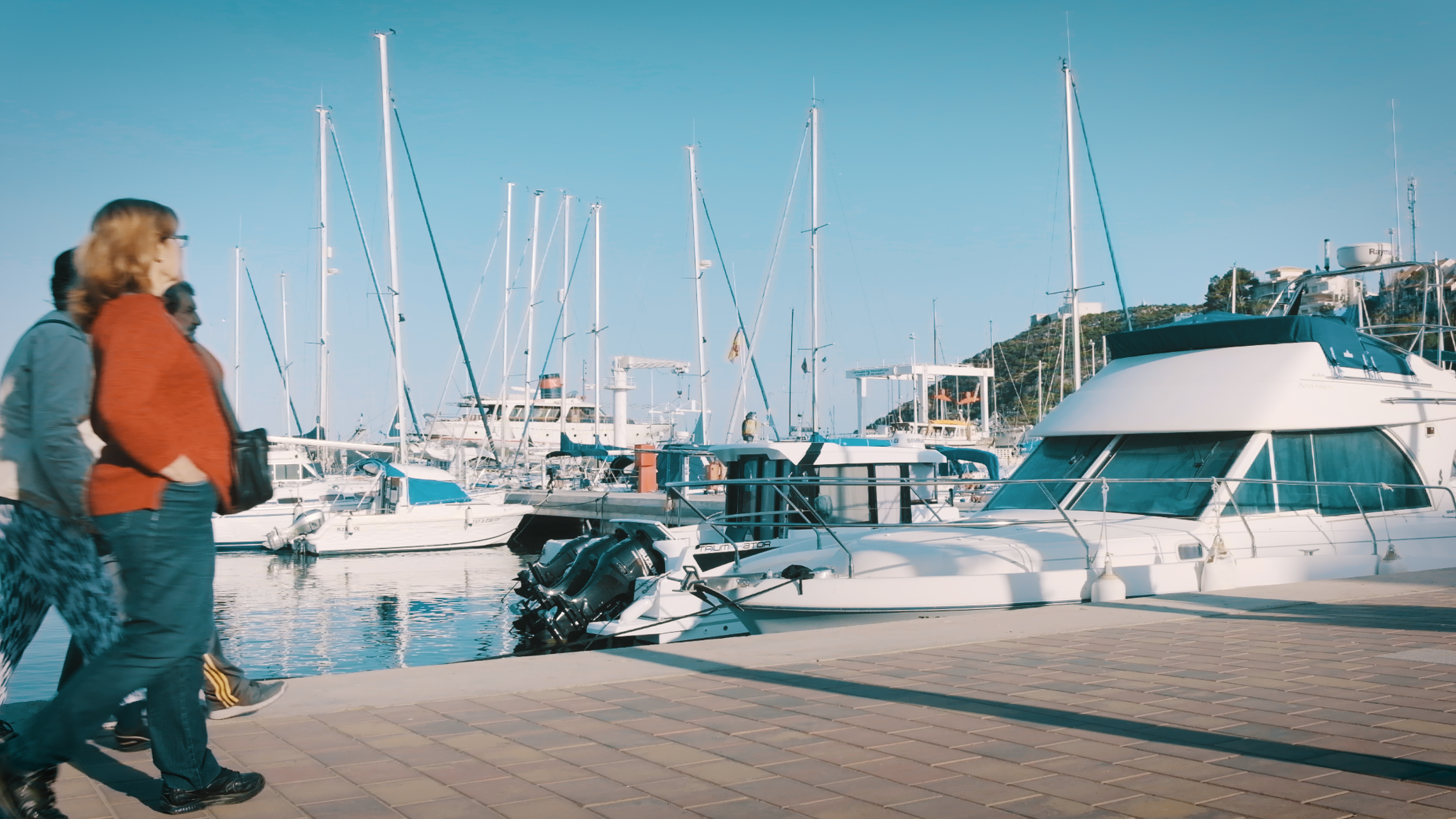

Super Members BTM_Pix Posted April 18, 2017 Super Members Share Posted April 18, 2017 1 hour ago, SuperSet said: Those grades look great. I'm a little unclear on which ones are the FLog + external recorder vs ProNegStd? They are both from the FLOG. OK, so here is one of the source FLOG files. Its 21 seconds complete with random people walking across frame and off camera audio from the internal mics of two ladies having a conversation that may have been fuelled by afternoon cocktails. 4K ProRes 422LT* https://mega.nz/#!RqxBkTbD!dqmFFG4fFjC792nc1Y9yj2EQNIYSm3hpAQRyjHJDG7w *Yes,yes I know. Kubrickian 1 Link to comment Share on other sites More sharing options...
Kubrickian Posted April 18, 2017 Share Posted April 18, 2017 It grades really well. First one is an M31 LUT and the second one is a a straight curve in colorista. BTM_Pix and mercer 2 Link to comment Share on other sites More sharing options...
bunk Posted April 18, 2017 Share Posted April 18, 2017 I like it too. It doesn't break easily. There is chroma smearing/shift as wel but it doesn't jump in your eye. I like the noise as well. Here is a grade The footage is very sensitive to contrast, before you know you're shadows get this burned in look. mercer and Kubrickian 2 Link to comment Share on other sites More sharing options...
Taranis Posted April 19, 2017 Share Posted April 19, 2017 I tried to give it a warmer, sunset type of look. Kubrickian 1 Link to comment Share on other sites More sharing options...
