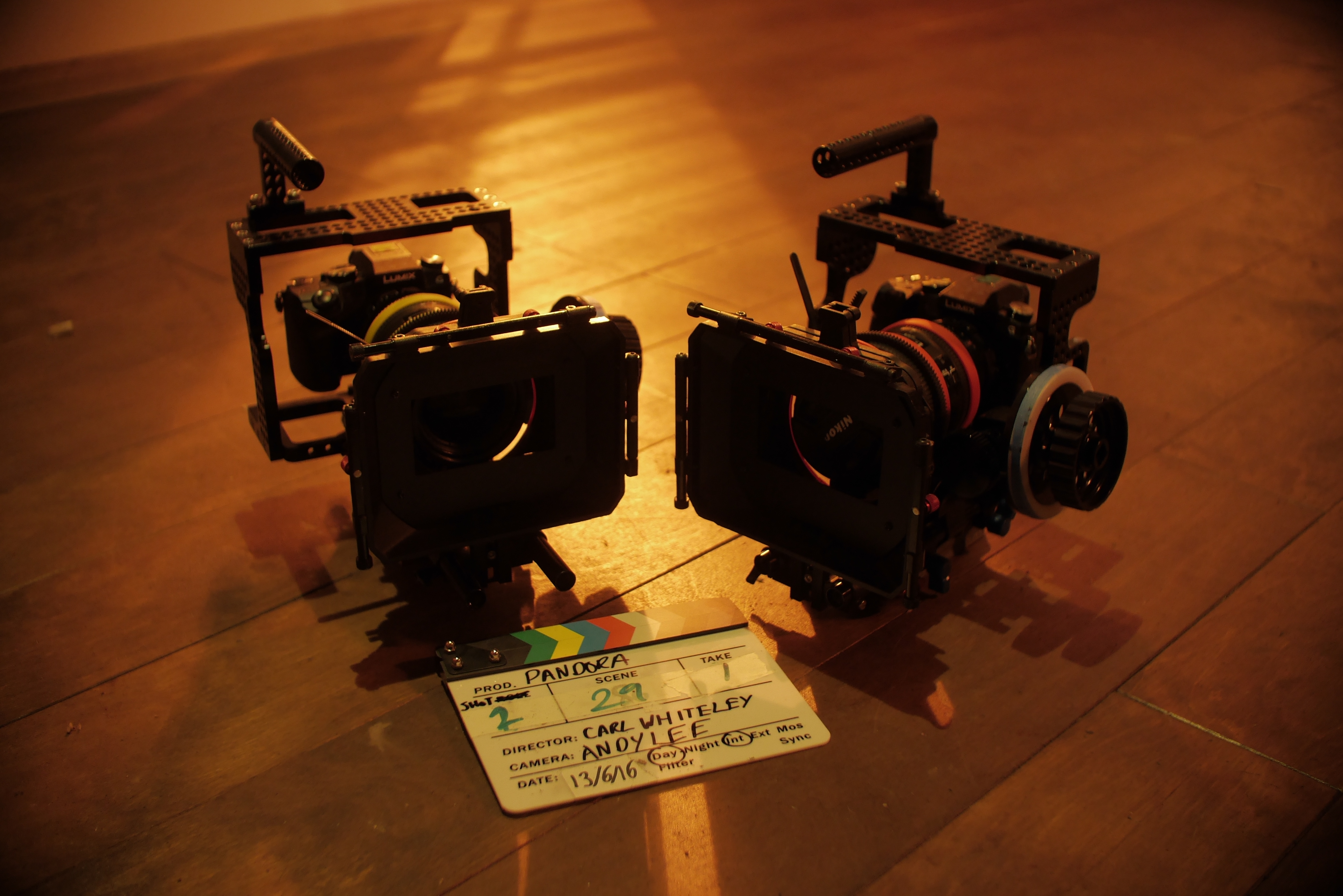

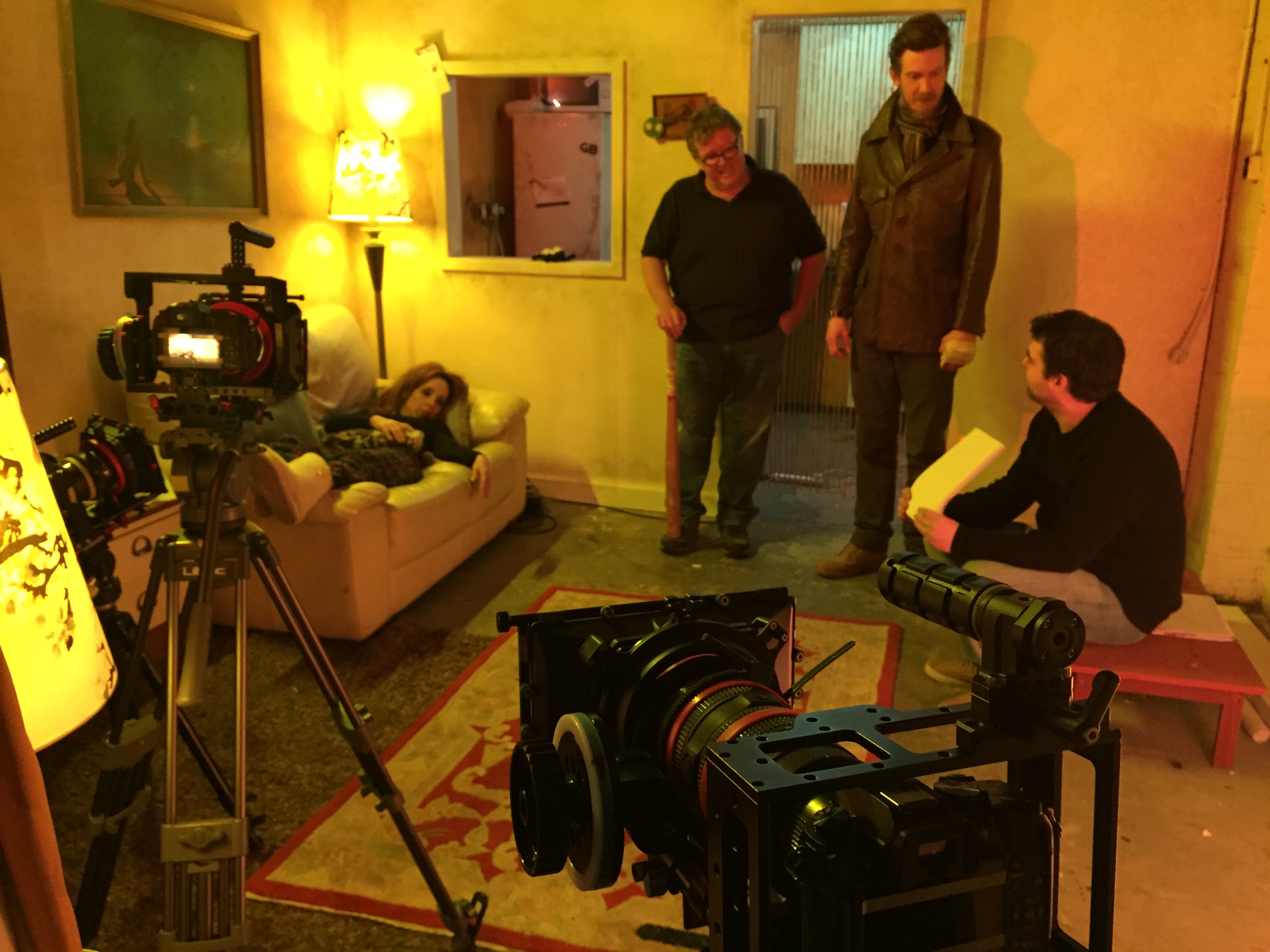

andy lee Posted July 8, 2016 Share Posted July 8, 2016 6 hours ago, IronFilm said: Wow, wow, WOW!! Why did you shoot a feature film with so many cameras at once?? :-o ***SIX***?? I could under stand as many as 3 easily enough, maaaaaaybe even having four, but it boggles my mind as to how come I'd need 6 to shoot a feature?? Was it a documentary perhaps??? Time ! thats why , shooting multi cam saves time and money and lets you get alot more setups done per day , I had 6 x G7's rigged up on Gini Rigs that I custom made , I had 2 rigs with Nikon 80-200mm lenses, 2 with Nikon 28-70mm lenses and one with a Nikon 20-35mm lens the sixth G7 was used on steady rigs and dolly tracks and sliders with various different lenses , all cameras had Metabones XL speedboosters on them to give me a Super 35mm field of view on the lenses , most set ups I would run 3 cameras , a close up, a mid and a wide , the actors loved it as we could do long takes 3 min passes at times and pick off head shots, mids and wides all in one performance . Some set ups I did run 6 cameras at once as we had some complex special FX shots with prosthetic heads and blood and gore etc . Multi cam is the way to go , we shot the movie in 44 days , and if we had done it traditionally with just 1 camera it would have taken maybe 60 days plus . So multi cam saved us alot of time and money , the Panasonic G7s all performened amazing no issues at all and we shot 12 hr days every day , the rigs and camera and lenses got Battle Tested to the limit and all worked beyond my expectations , The G7 is an amazing camera its very very good in low light much better than the GH4 as it has a newer better sensor , I could not have shot this movie without the G7 it let me shoot 3 or 4 stops under for most of the movie , I like that low light Gordon Willis - "Prince of Darkness" look so the G7 let me push that to the limit with no noise and fizz at all in the blacks , its very very good!! JazzBox, Liam, Fredrik Lyhne and 3 others 6 Link to comment Share on other sites More sharing options...

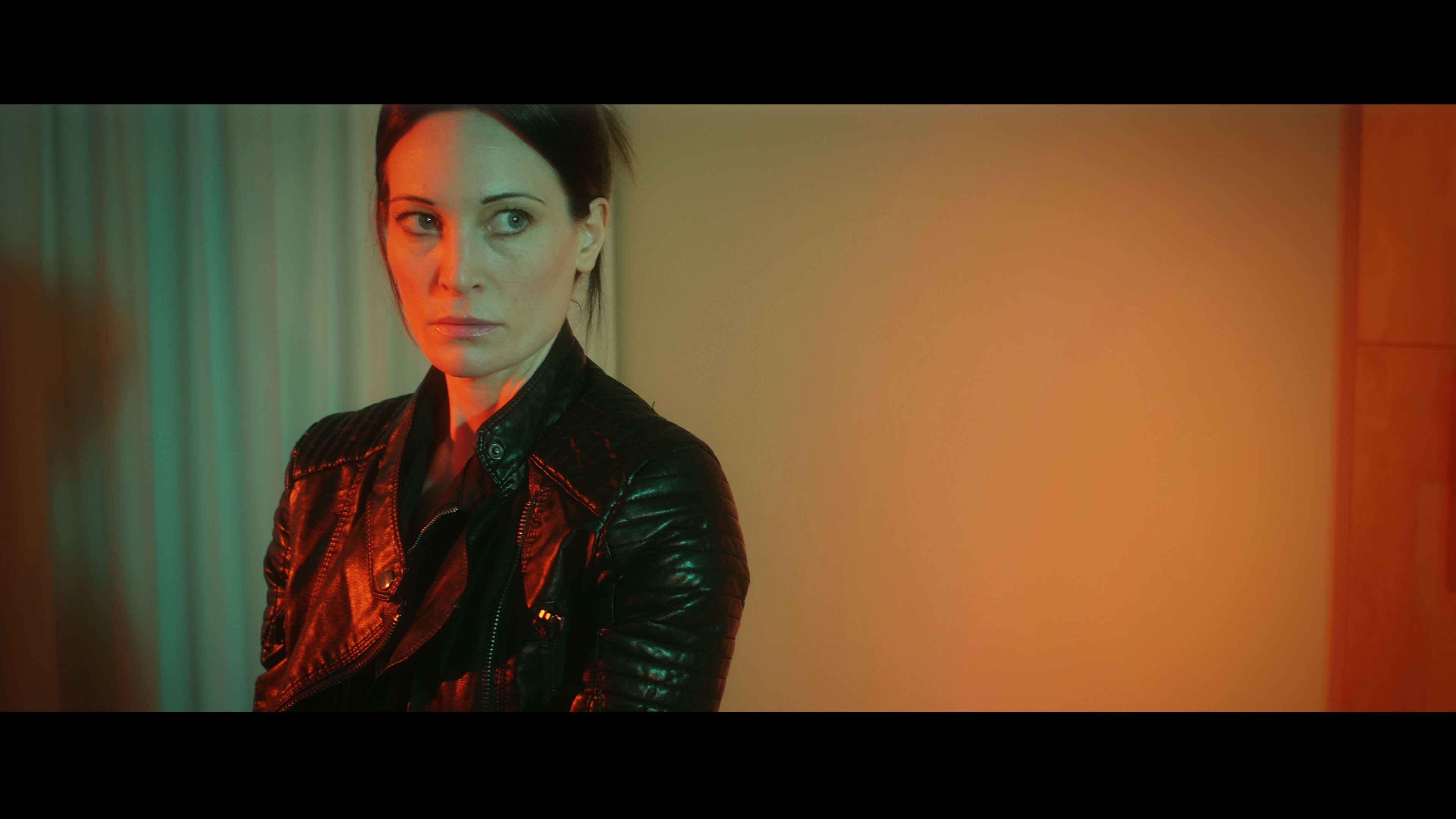

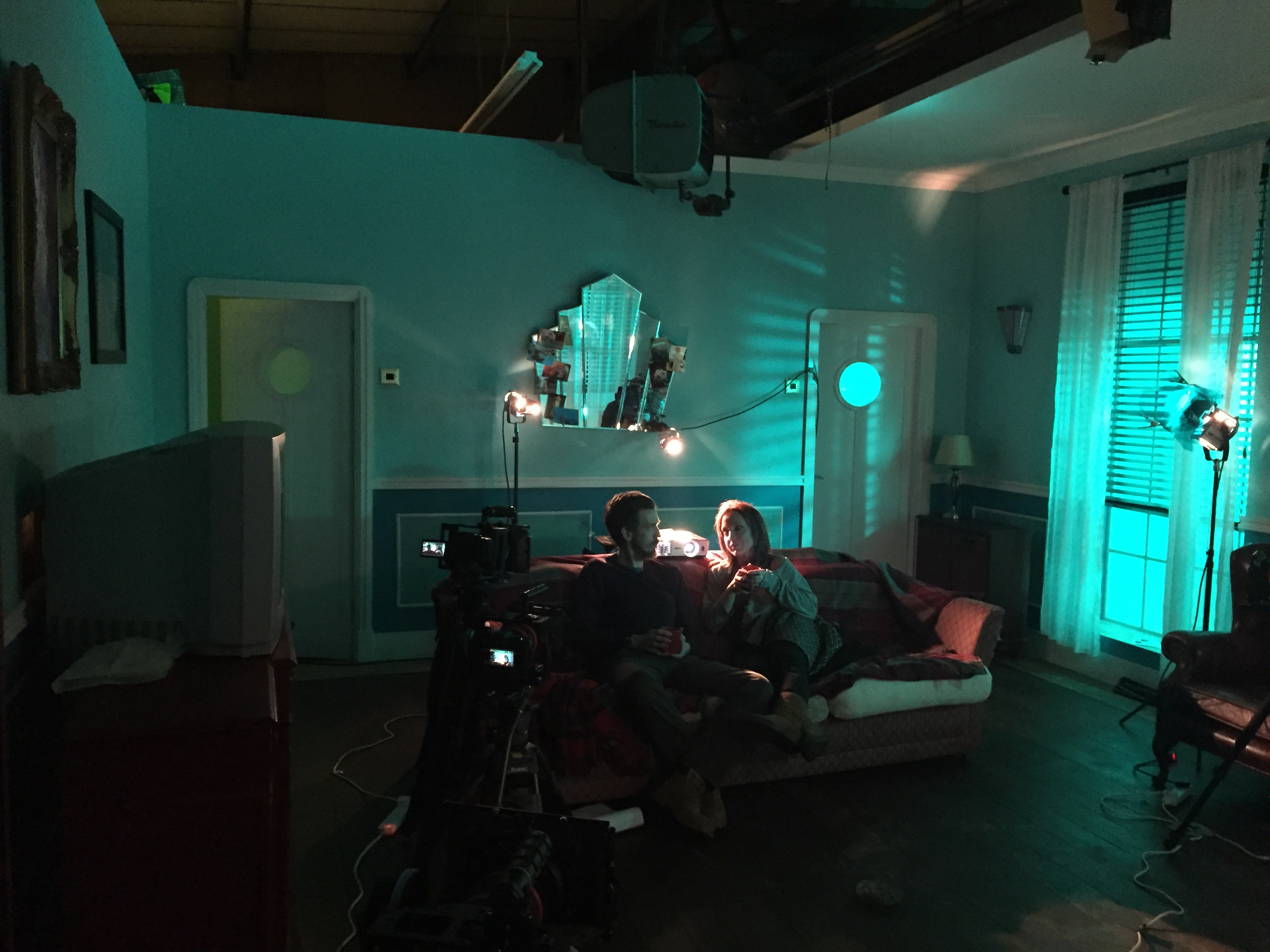

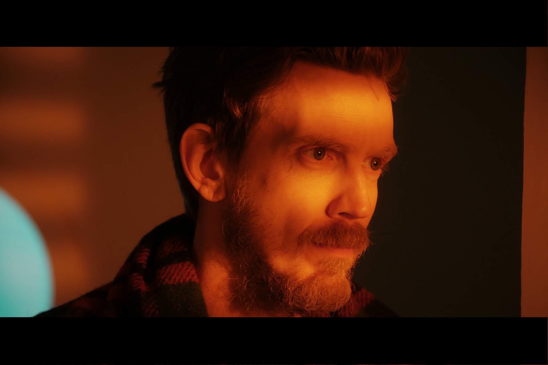

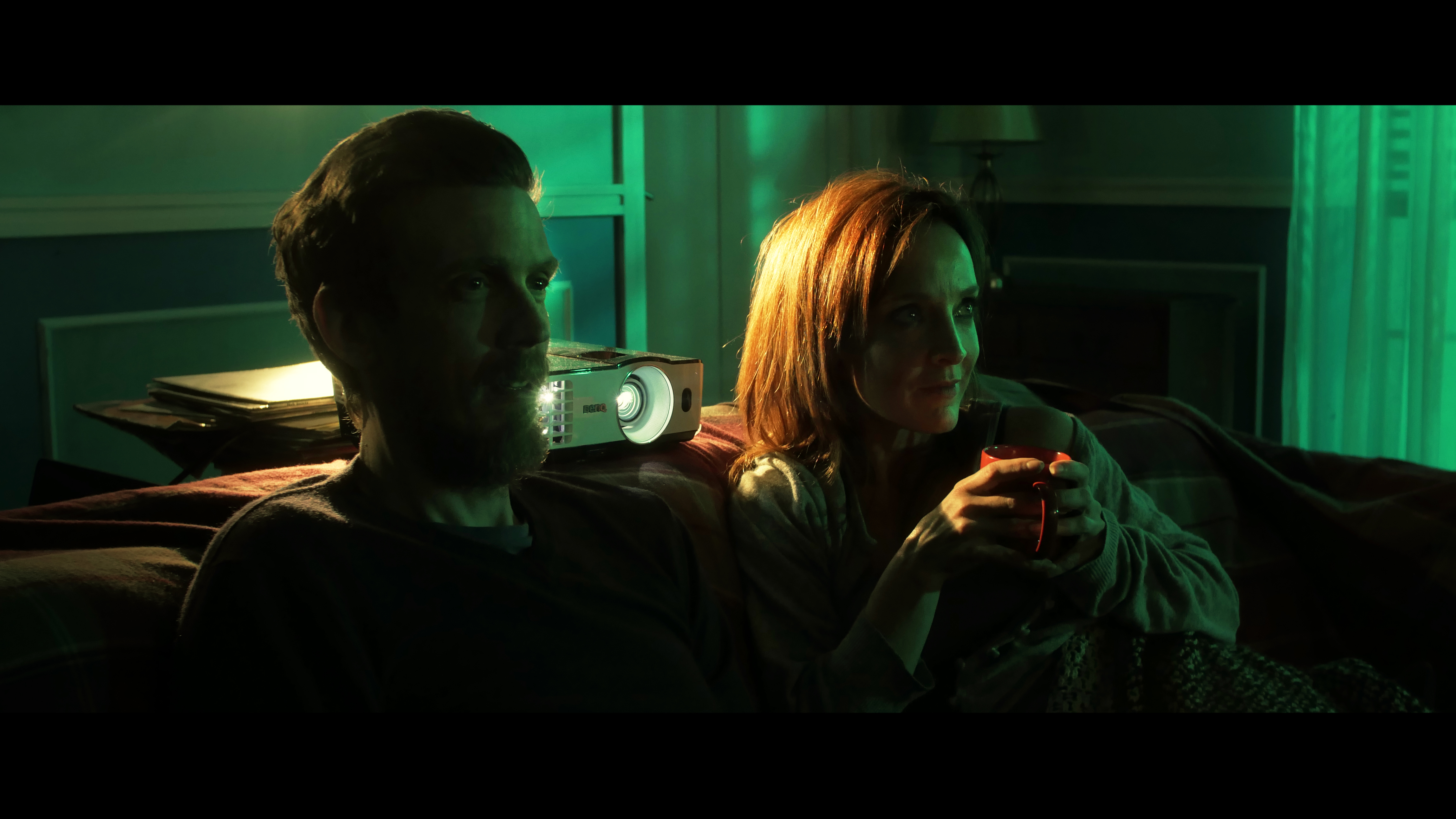

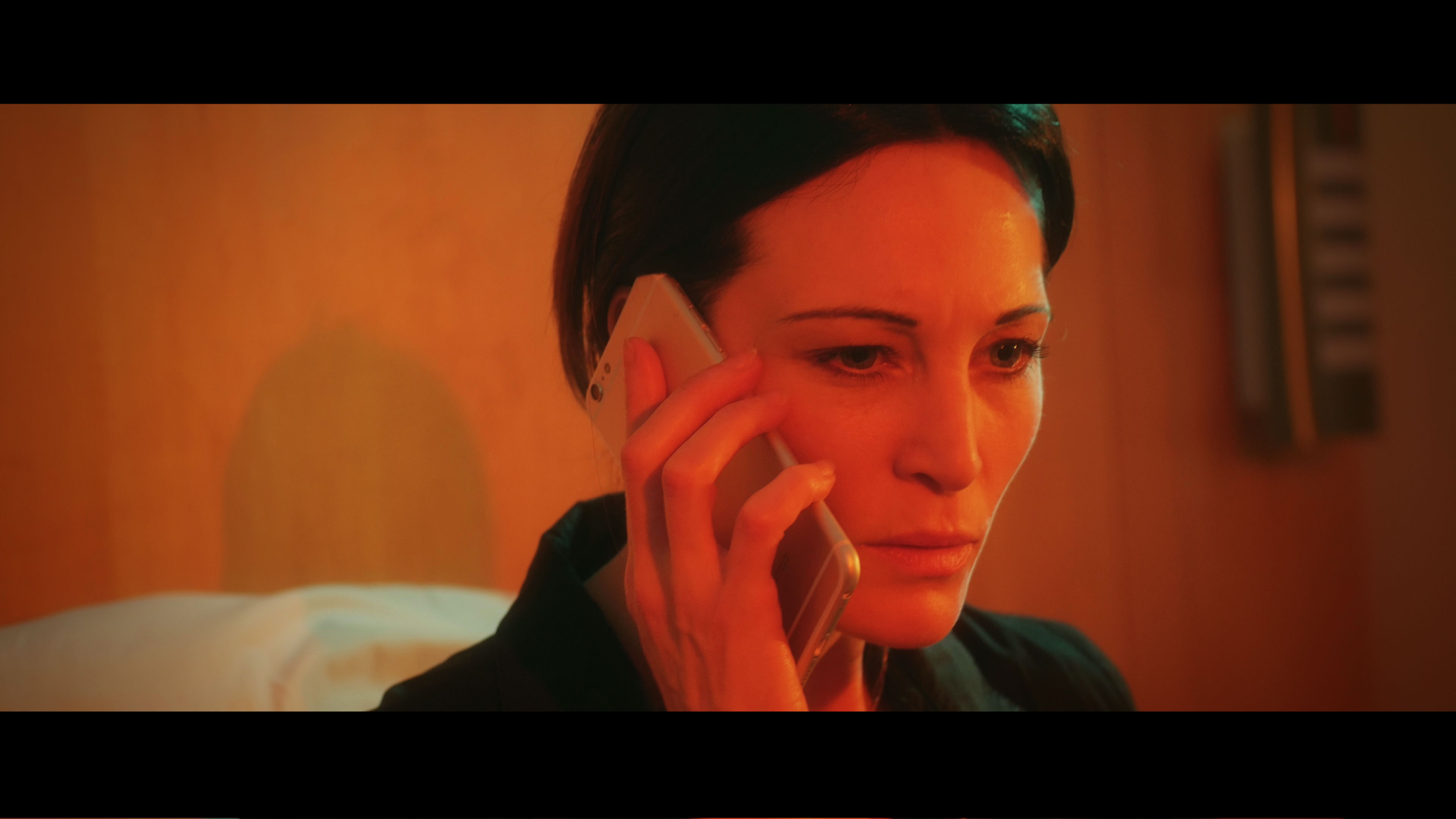

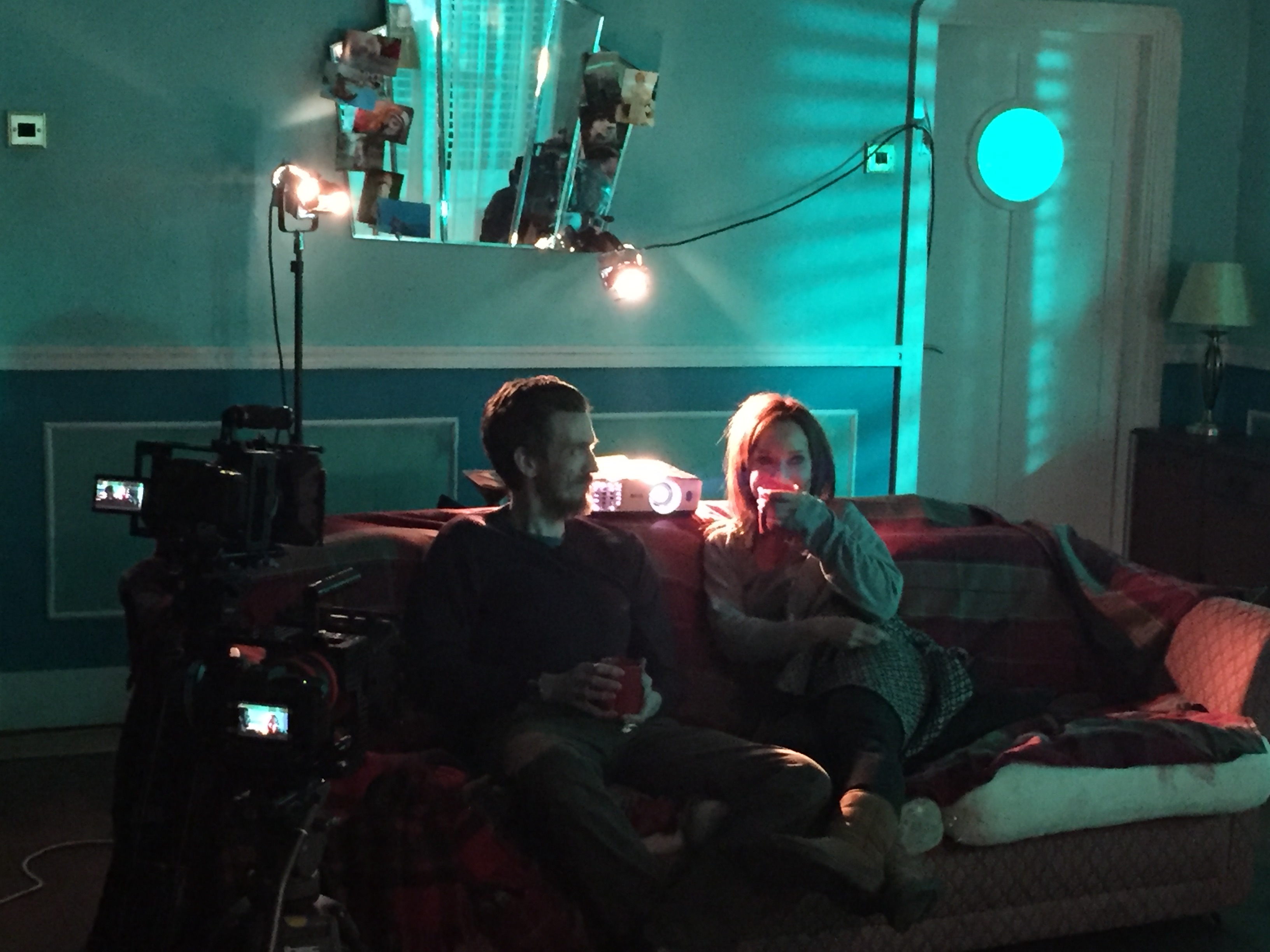

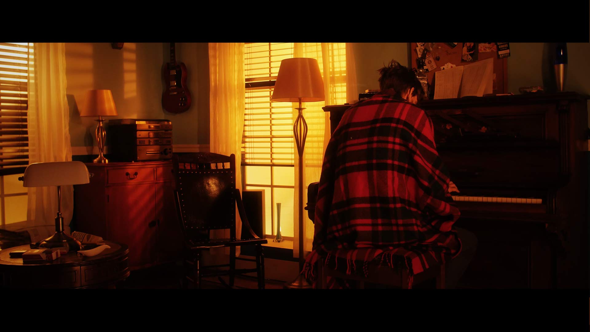

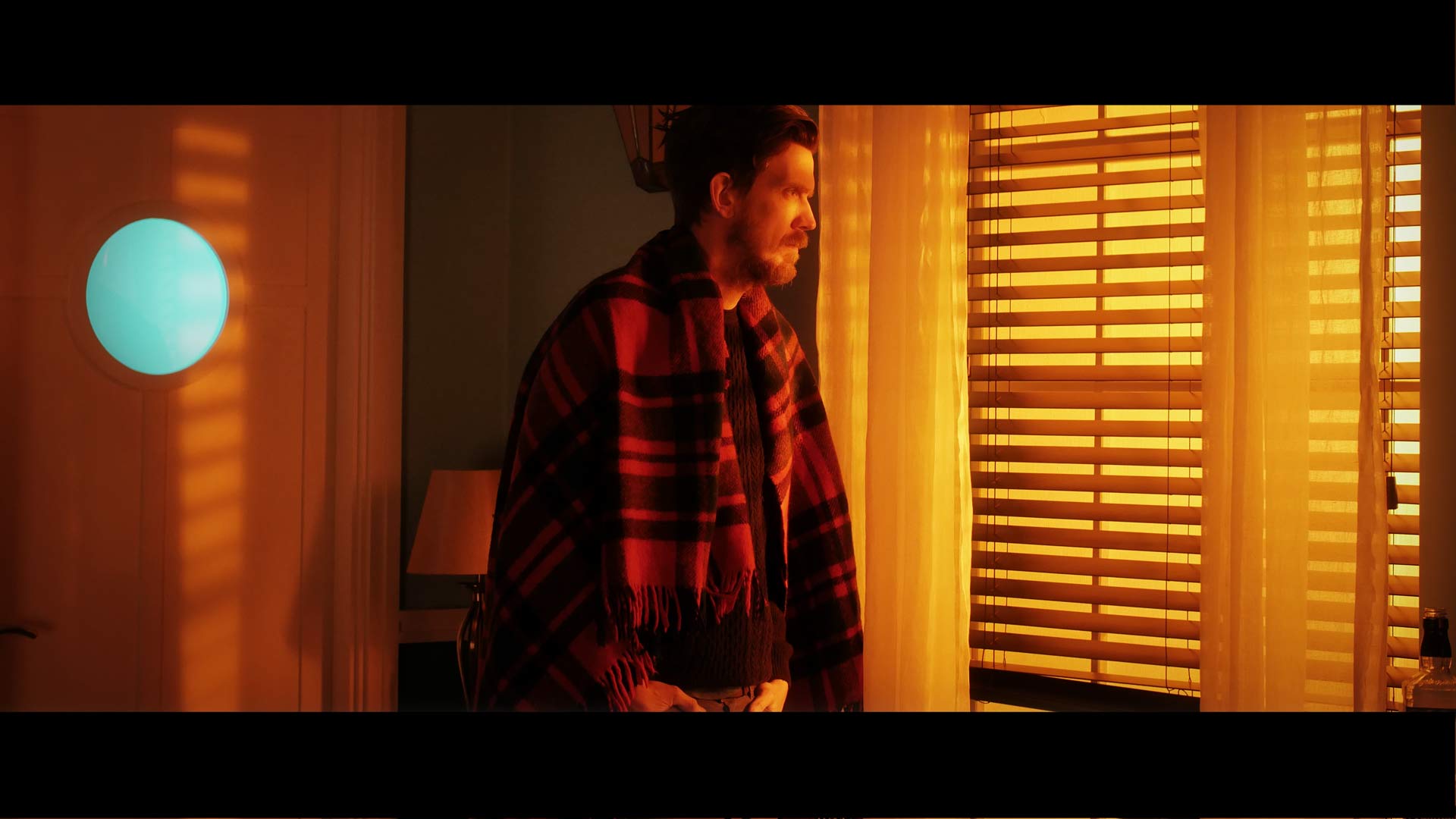

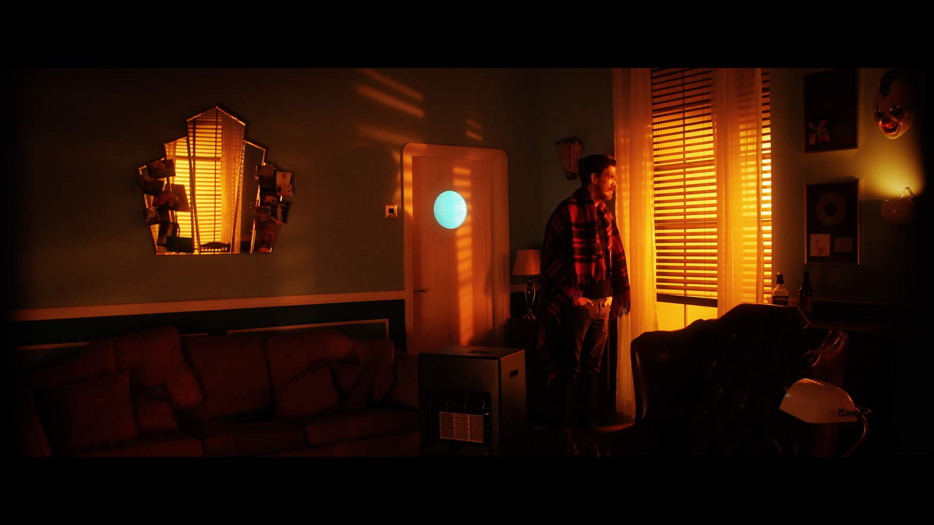

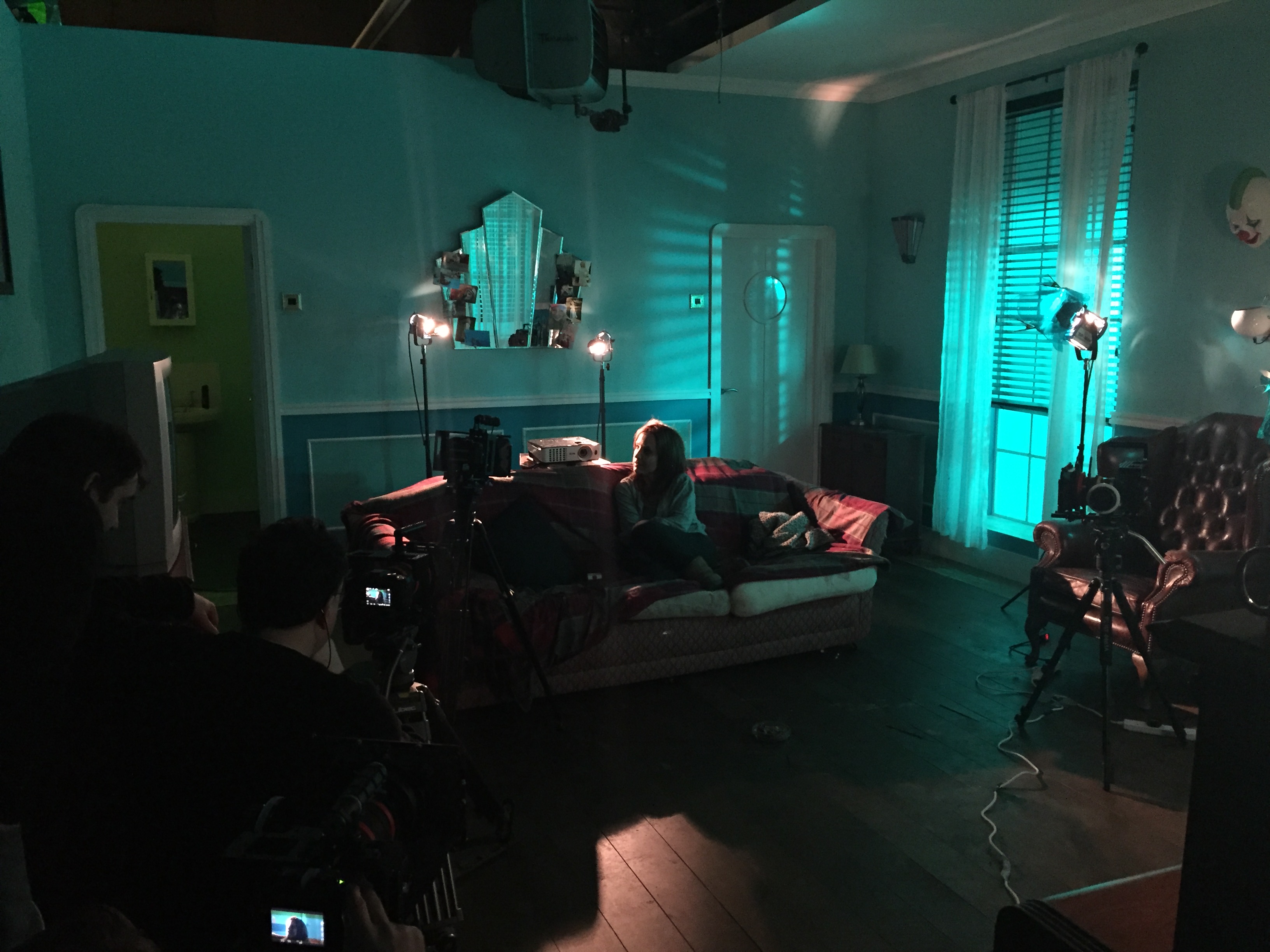

tupp Posted July 8, 2016 Share Posted July 8, 2016 4 hours ago, andy lee said: I like that low light Gordon Willis - "Prince of Darkness" look If Willis was the "Prince Of Darkness," you (and your gaffer) are the "Prince Of Party Gel!" Seriously, the stylized color in your narrative project is fascinating. I really want to see this film! Some of the images that you posted are impressive, textbook examples on how to peg the saturation and on the use of glints of complementary hues. Please post the main gels you used (I would guess that you used Lee, being from the UK). For those that missed Andy's earlier posts on the project, here are more screencaps. I am very curious to see how daytime exteriors will be handled. andy lee 1 Link to comment Share on other sites More sharing options...
andy lee Posted July 8, 2016 Share Posted July 8, 2016 thats why I got hired for the movie!! I come from a pop video background for 20 years ,I always shoot with gels on my lights , the Director wanted a very modern bold stylised use of colour , he came to me to design the whole look and style of the movie , so I have used different colors and contrasts of colours through out each section of the movie so each scene has a look to it , It was a very small crew I was DOP and Gaffer ,so I lit the entiremovie myself as well as shooting it .I have big lighting package I brought to the movie of 25 Arri Fresnels , (1k pups , 650s , 300s 150s etc) and kinoflo tube lights yes I do use Lee gels all sorts of colours plus I shoot alot at 4000k for interiors the Panny looks better at 4000k than 3200k , just that bit warmer , I shoot day exteriors at 6500k and all my night exteriors at 2500k , yes I do try and use contempory colours there is modern colour palatte in the industry I have embraced alot , this movie has no day exteriors in the whole script , all the exteriors are night time so I got to play with the colours alot which was fun gelling all the Arri HMIs at night I used alot of Peacock Blue and 1/4 blue. Lighting is a totally subjective subject , I like to treat it as a completely creative tool to help tell the story and a contast in light and dark is also complemented by a contrast of colour in the lighting , why limit your self to what I call boring plain 'white light' , you dont have to just use your lamps as is , gel them with colour and diffusion , most of my Fresnels have F1 diffusion on them all the time , (I rarely use undiffused lamps) ...along with a gel , if you want to play around with this then just get some full CTO and Full CTB gels and start with that , the possibilities are endless!! get creative...... Michael Coffee, kaylee, mercer and 4 others 7 Link to comment Share on other sites More sharing options...

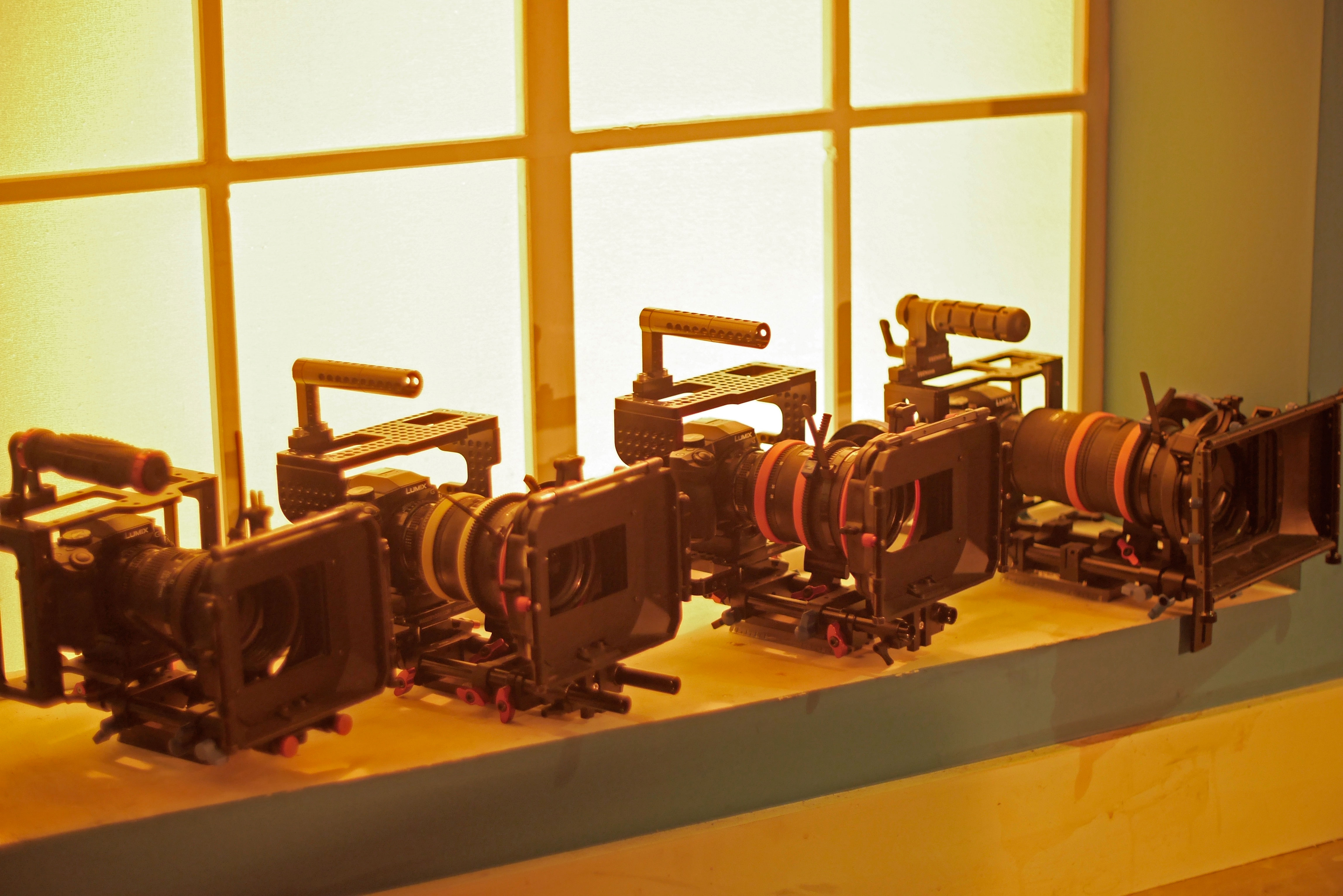

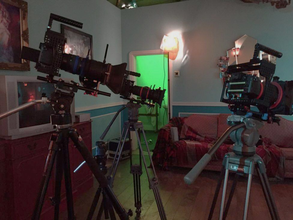

IronFilm Posted July 9, 2016 Share Posted July 9, 2016 21 hours ago, andy lee said: I had 2 rigs with Nikon 80-200mm lenses, 2 with Nikon 28-70mm lenses and one with a Nikon 20-35mm lens the sixth G7 was used on steady rigs and dolly tracks and sliders with various different lenses , all cameras had Metabones XL speedboosters on them to give me a Super 35mm field of view on the lenses , most set ups I would run 3 cameras , a close up, a mid and a wide , the actors loved it as we could do long takes 3 min passes at times and pick off head shots, mids and wides all in one performance . Ah I see, you used "just" 3 cameras for most shots. That makes much more sense. As I'd struggle to see how it makes sense to use six for most shots! andy lee 1 Link to comment Share on other sites More sharing options...
andy lee Posted July 9, 2016 Share Posted July 9, 2016 Lighting for 3 cameras something I did alot on this movie, you just have to think ahead so one angle doesn't take a 'bath' with the lighting, I would often use a Arri 150 as a shadow killer on the C camera angle , so as long as camera A and B are good with camera C I will shoe horn in to get a usable angle, 'coverage' is the word thrown around alot by Directors these days , lots of DOPs say you can only light for 1 camera and thats the traditional way , well its not true you can light for multi cam If you think it through carefully it does work , 6 cameras is possible I did that quite a bit stacking them in pairs a close together like 40mm and 75mm with the 75 slightly higher for a close up head shot , if you have enough light and big enough set you can do , I designed the set with the director so I could put the windows and the practical lights exactly were I wanted them , this helped alot . see pics below of some typical multi cam set ups on the movie tupp, Shepard HS and IronFilm 3 Link to comment Share on other sites More sharing options...

andy lee Posted July 9, 2016 Share Posted July 9, 2016 Multi Cam is great for dialogue scenes as you can shoot over the shoulders in both directions at the same time and sneek in a 2 shot wide side on plus ECU head shots in both directions at the same time too ! 5 cameras for all that and the actors love it as they can play the whole scene in one pass and its all 'real' the performance can be cut for one actual take so it all edits together perfectly , yes you have to light for it and set up the shots but I do highly recomend it ! its so much faster then with one camera . I started shooting multi cam on my pop videos after I stopped shooting on film as its so much more useful to get all that coverage faster, so its not something new to me and when the Director of Pandora embrased this way for filming for this movie it was great to be let free to hunt down cool shots with all the extras cameras I had to use. here you can see a shot from the movie and below it a BTS photo of the set up and how I lit it and shot it multi cam , I used 5 cameras on this sofa scene shooting both sides at the same time. cu head shots, 2 shots and wides all at once - saved loads of time !! kaylee, tupp, Shepard HS and 2 others 5 Link to comment Share on other sites More sharing options...
tupp Posted July 10, 2016 Share Posted July 10, 2016 Thanks for posting all the photos and all the info! Very enlightening! It is really fascinating to see the different colors used, and I would love to see this film! Comparing the BTS shots of the projector scene with the corresponding screencap, the 4000K color temp setting on the G7 is palpable. I do not see any recorders -- did you jettison them? By the way, nice "greeking" on the dumpy apartment set! Link to comment Share on other sites More sharing options...
