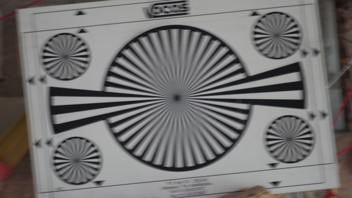

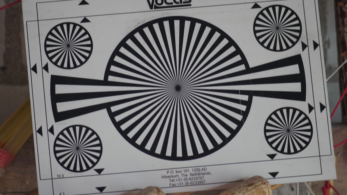

bunk Posted July 16, 2016 Share Posted July 16, 2016 I read the post by JonPais in the Fuji thread where he hopes to get rid of micro jitters with the help of a gimbal. Like him I tried all kinds of solutions and some worked better then others but I never got rid of what seems to be my biggest handicap; a too flexible spine. So the other day I thought why not use a belt to connect a small tripod to my hips and circumvent the spine all together. Sounded cool and it kind of worked, but if you want to use the EVF as well it is not optimal. At some moment I used the belt around my shoulder and it dawned on me I just made a swing, meaning any abrupt move would be absorbed or slowed down …and the seat of a swing always stays horizontal. It's my favorite way of stabilizing now. All jerks, jitters are gone. It's not that you don't move anymore but it's more like you film slowmo. And there are no extra costs. I'm pretty sure everyone already has some kind of lightweight tripod, I use the Sirui T-0005KX. If you want more weight or stability, mount a video head on top of a ball head. Both shots were taken with 1/30 of a second with a 200mm lens on a GH4 with a Speedbooster (0.72). It illustrates the use of the tripod shoulder mount trick vs handheld. Inazuma, Liam, kaylee and 1 other 4 Link to comment Share on other sites More sharing options...

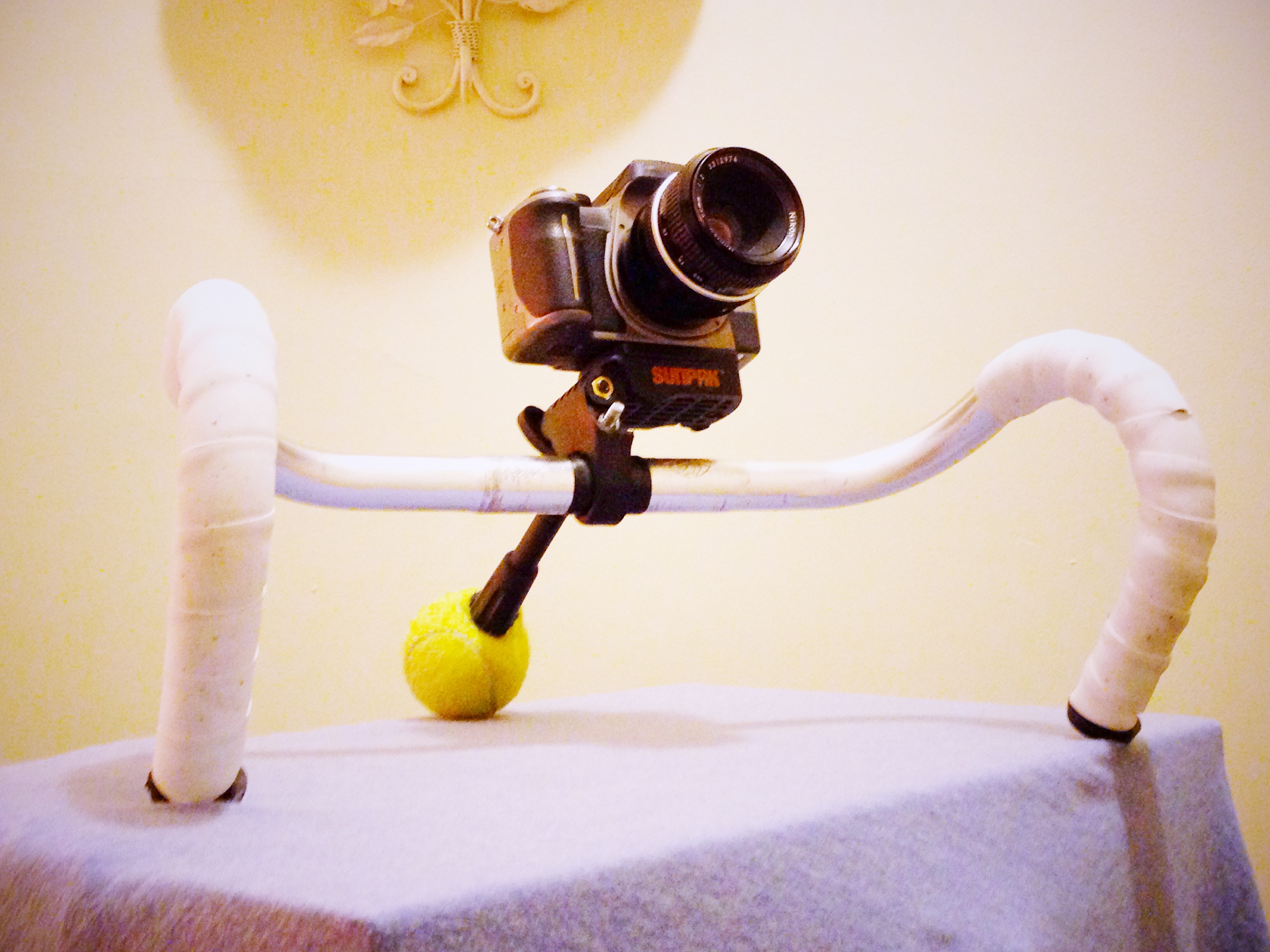

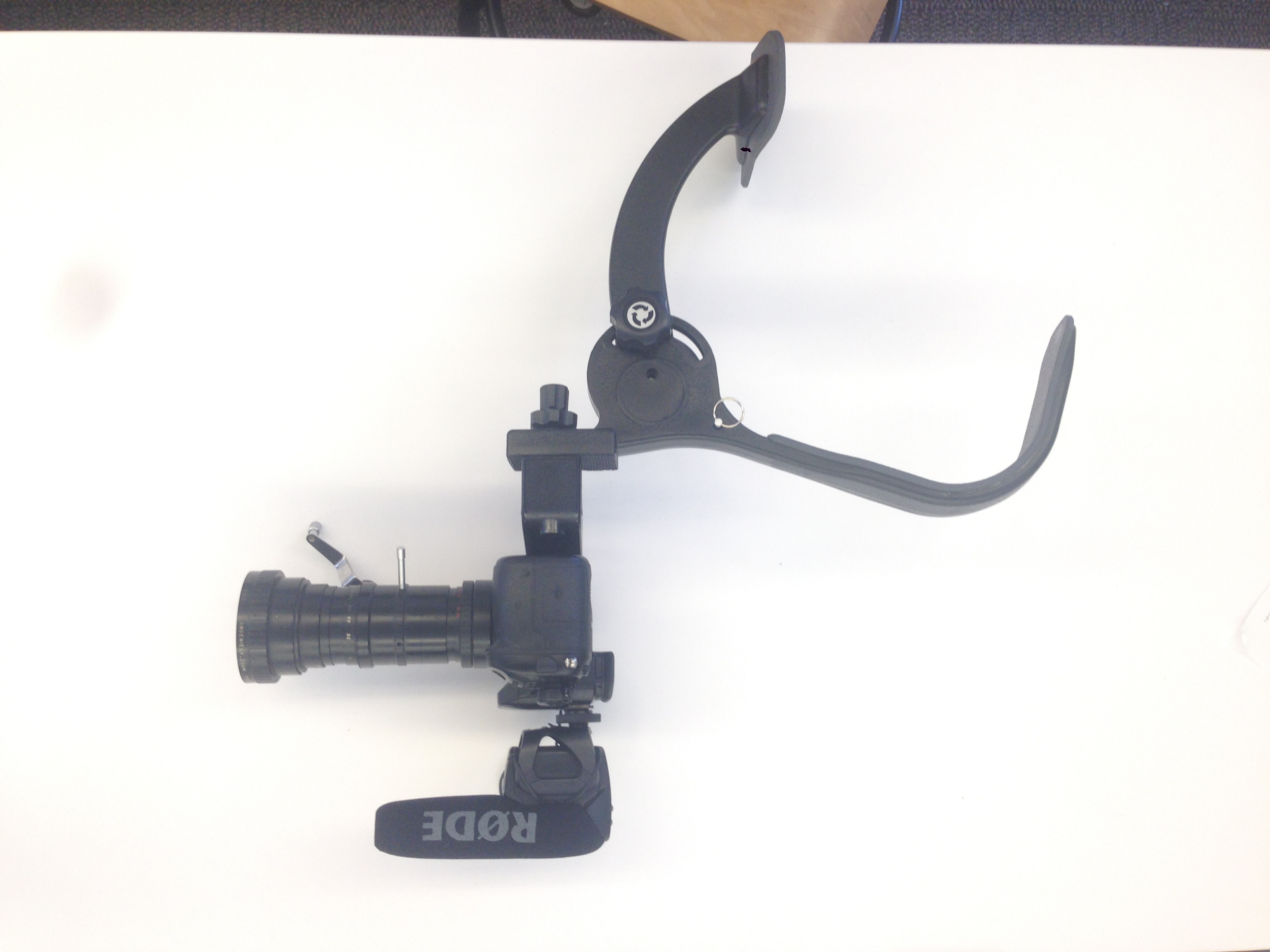

freeman Posted July 18, 2016 Share Posted July 18, 2016 Bunk I've been experimenting with different handheld setups for a little while. This one worked pretty well but actually attracted too much attention when I was trying to shoot documentary footage. Still, it did create a nice conversations and people would smile when they would see me film them with it. Cheap tripod head with a tennis ball on the pan arm and a set of (actually kind of nice) Nitto aluminum road bars from my bicycle spare parts bin. I could put the tennis ball in the crux of my shoulder and handhold that way or down towards my stomach with the screen out. If I didn't need to pull focus I could use both hands. Now my rig looks more like this: it's a very cheap rig from cowboy studio you can readily find on amazon and it really has been great. You can see the top arm that hooks around the back of my shoulder and the bottom arm goes against my stomach/ab area. This thing helps me handheld so much. I also take it off my shoulder, collapse the small arm and kind of handhold it low which for quick shots also do me a lot of good. Matt brings up a good point though sometimes I really hate having the thing "mounted" on my shoulder as I need to physically move and bend my knees to get low angles. I don't own a monopod yet but I think you are really onto something with the loop around the body (or this fanny pack idea) to help anchor something at your waist that can also be removed. Love the challenges of stabilizing these small cameras. Adept 1 Link to comment Share on other sites More sharing options...

bunk Posted July 19, 2016 Author Share Posted July 19, 2016 I love the road bars/ tennis ball/ tripod head stabilizer. Way cool! Thanks for sharing. I have been thinking about the cowboy rig in the past. In the end it looked a bit too much as if you're filming for me. With the tripod I still could be taking pictures. The monopod remarks made me thinking …why not use the third leg with the pocket knife case on my waist belt. And that is how I use it now. Talking about spare parts of a bike. I use an inner tube as an eye cup on the EVF. With careful use I can open the screen without removing the cup. On 18/07/2016 at 5:07 AM, Matt Holder said: Sorry about the disrespectful "looks ridiculous" comment! My feelings weren't hurt. I'm a hobbyist trying to get a more steady shot. If I were a pro I wouldn't come up with such solutions …or maybe I would, just to provoke a bit Link to comment Share on other sites More sharing options...
