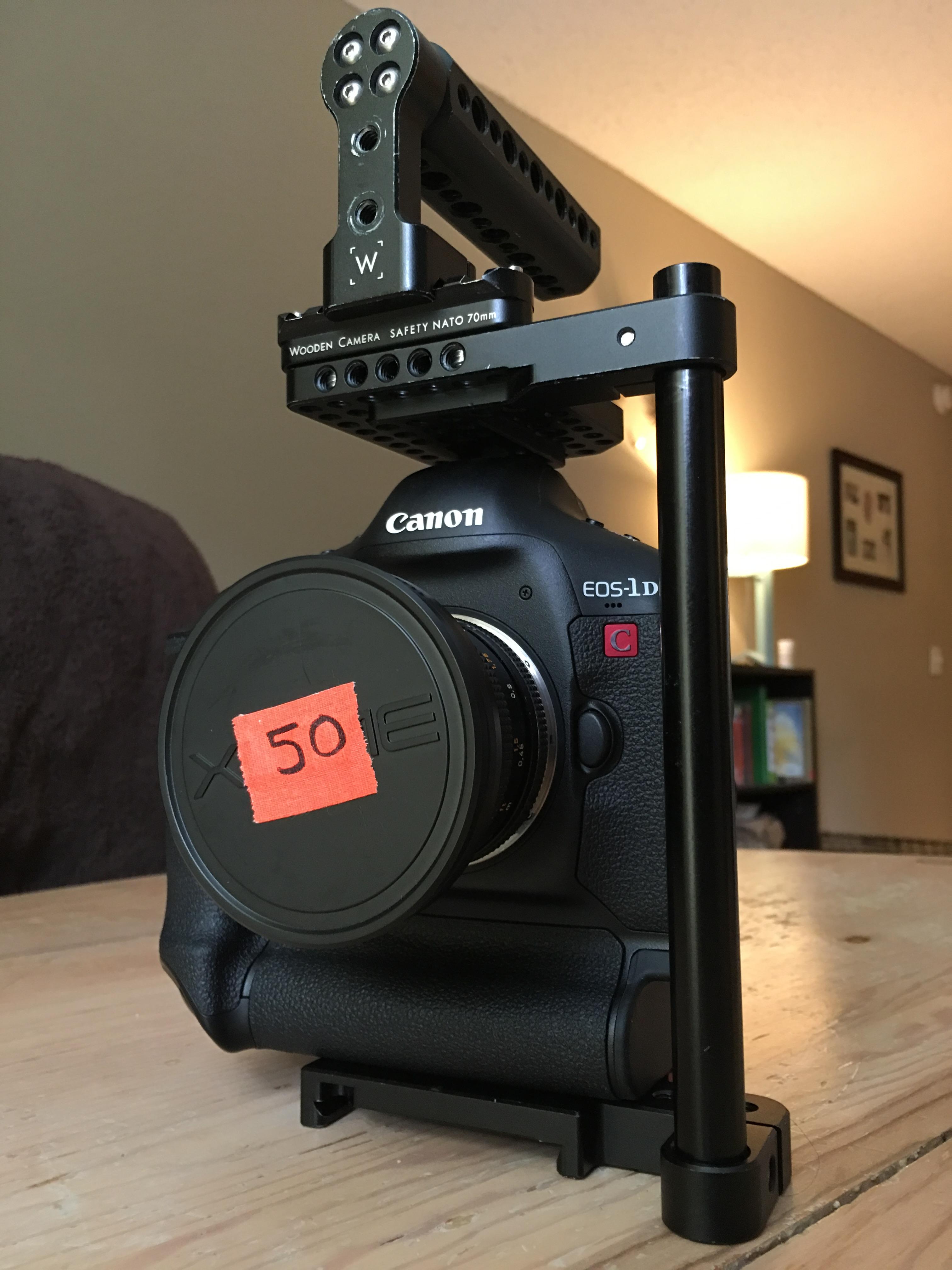

Dave Maze Posted July 20, 2016 Share Posted July 20, 2016 12 hours ago, Jaime Valles said: Hi, all! I just got my new 1DX Mark II, and I would like to use a cage with it for video shoots where I'm attaching a monitor, audio recorder and wireless receivers to it. Any recommendations? Ideally, it would keep the camera from twisting for use with follow focus units. Also, I'm looking for inexpensive if at all possible (I already spent a bunch on the camera itself!) Thanks! I use the wooden camera dslr cage for my 1dc and love it. Smallrig makes one that's really similar but a lot cheaper. All you need to do is get a 15mm rod to replace the small one this comes with. SMALLRIG® Half-VersaFrame Camera Cage https://www.amazon.com/dp/B011NVXP1A/ref=cm_sw_r_cp_api_Lt8Jxb24DJ98Z Link to comment Share on other sites More sharing options...

Dave Maze Posted July 21, 2016 Share Posted July 21, 2016 14 hours ago, Jaime Valles said: Nice find! So I just replace the rod on the side with a longer one to fit the 1DX Mark II? If so, that's a hell of a deal! Exactly. That little side rail thing can be replaced with any 15mm rod. So just measure the length of what you need and buy that rail on Amazon. I did the same for my 1dc and wooden camera cage. Just used a spare 15mm rod for that side rail. Also I'd get the handle they make too with it. https://www.amazon.com/dp/B01B7I25AQ/ref=cm_sw_r_cp_api_bvoKxb552XB22 youll need a nato rail to mount it on the cage: https://www.amazon.com/dp/B00EVG3M68/ref=cm_sw_r_cp_api_MwoKxbESQK7VR Link to comment Share on other sites More sharing options...

Dave Maze Posted July 22, 2016 Share Posted July 22, 2016 7 hours ago, Jaime Valles said: Another question: Can you remove the battery from your 1DC without having to take the camera out of the cage? Yes you can take the battery out. Having the top of the cage screwed into the hot shoe prevents it from twisting. 4 hours ago, Luke Mason said: Movcam makes a 1DC cage as well, it's much cheaper and it is the only one that uses the locating pin hole underneath the 1DC to eliminate twisting. Where do you go to buy that? I can't find it anywhere for sale in USA. Link to comment Share on other sites More sharing options...
