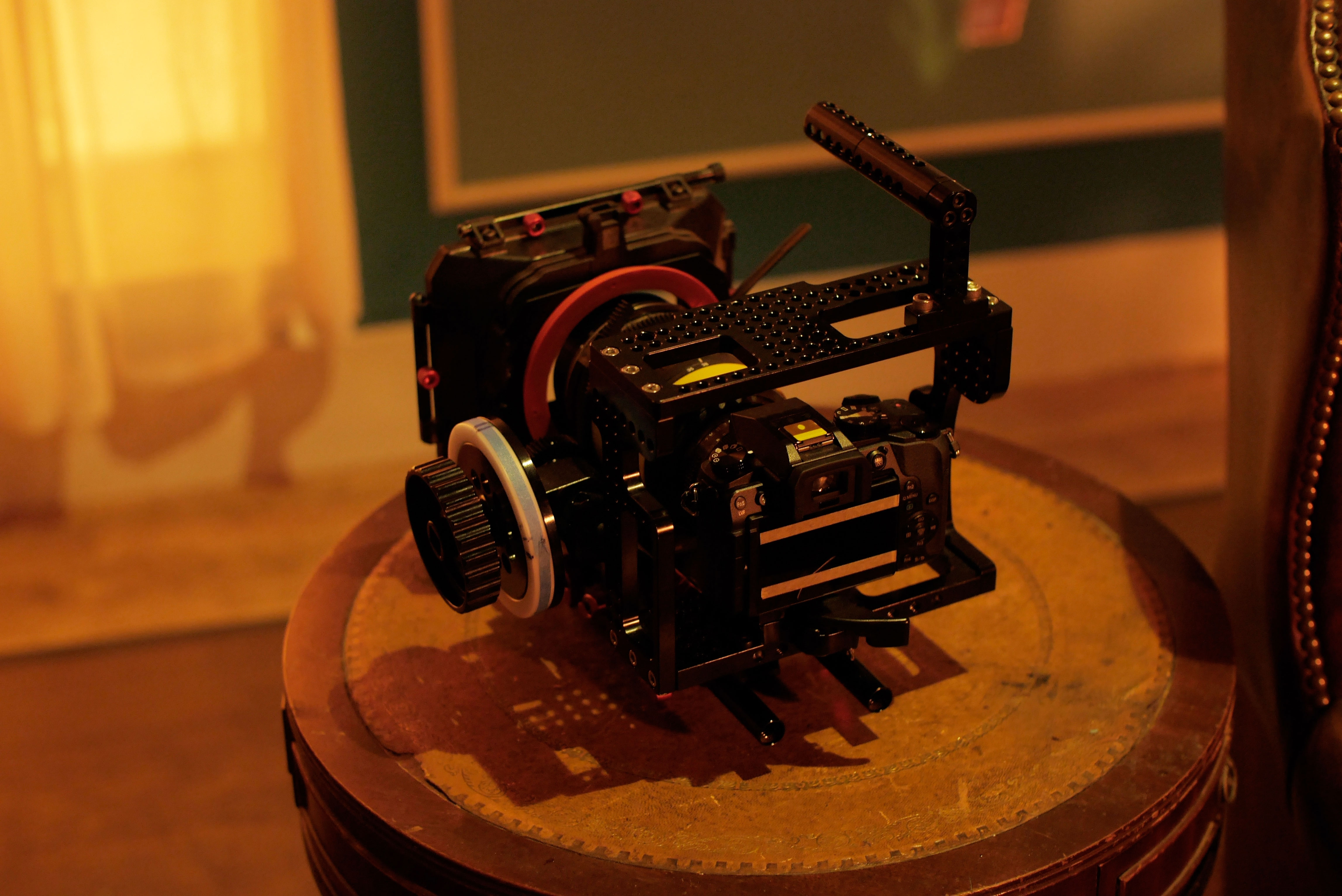

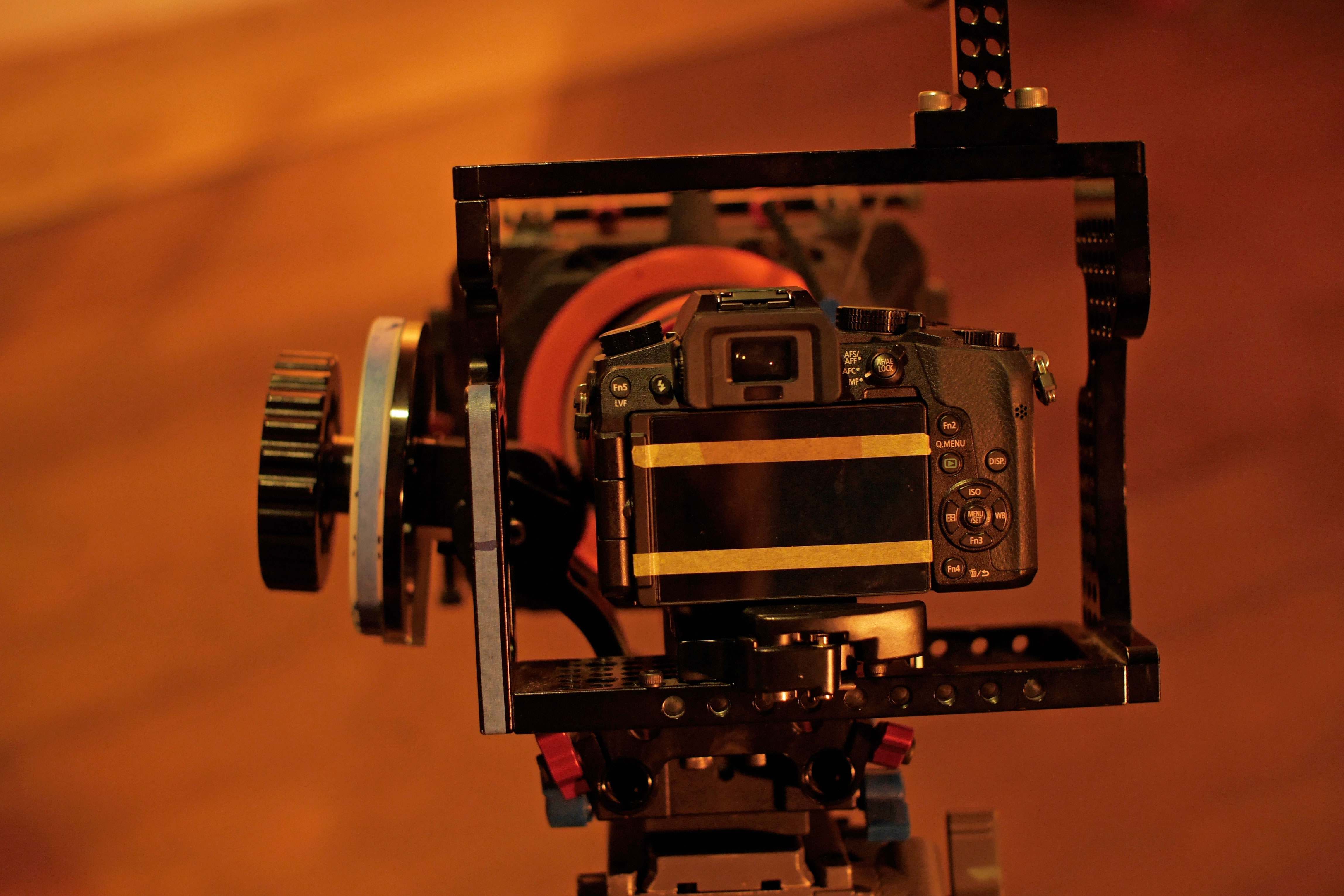

andy lee Posted August 8, 2016 Share Posted August 8, 2016 I use manfrotto RC2 style off ebay on my rigs for that reason I can leave the matte box on the lens and just take the rear of the camera upwards to change battery fast and easily , no sliding plates needed https://www.calphoto.co.uk/product/Manfrotto-RC2-Compact-Rapid-Connect-Adapter-with-3157N-Plate/MN323?gclid=CjwKEAjw26C9BRCOrKeYgJH17kcSJACb-HNAH8-4ixdml7XQ Link to comment Share on other sites More sharing options...
