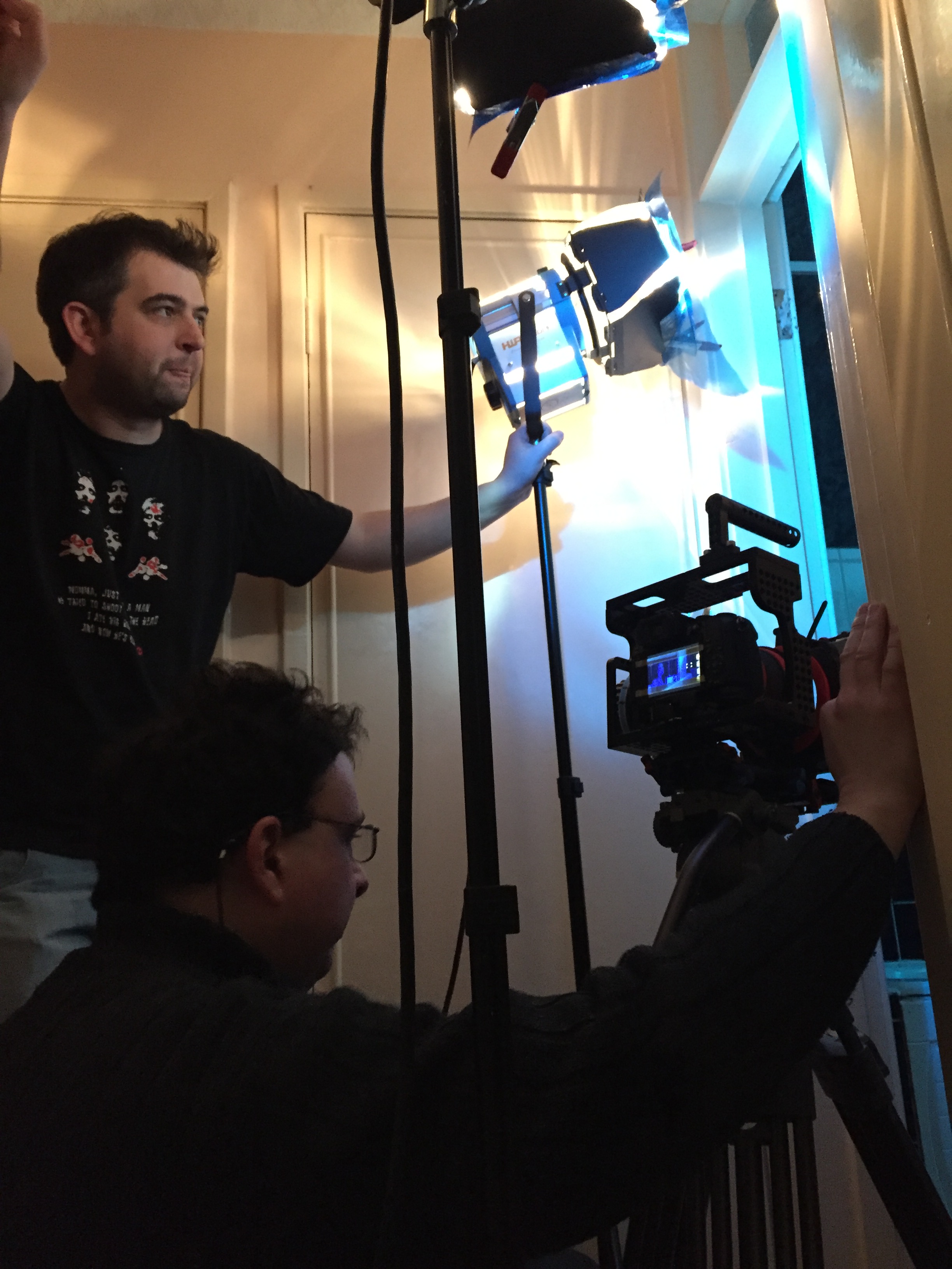

andy lee Posted July 31, 2016 Share Posted July 31, 2016 I have posted this the other day but its relevent here on this thread and some of you may have missed it so here it is again: I use Fresnels most of the time Arri originals and recently I bought a whole bunch of Chinese Arri copy fresnels off ebay for the feature film I just did , I needed to light 3 sets simultaniously and leave the lighting up for weeks at a time (I had 25 fresnels up at once on 3 sets) ,I like Fresnels as you can use them as a hard light or add some f1 Diffussion and use them as a soft light, you cant do that with Kino Flos they are soft all the time , so for me Fresnels are the way I light most of the time , the exception is lighting Women .. where a soft light is more beautiful , so sometimes if I need a very soft look , I use Kinos then or LED tube lights I have made - basically LED Kinos not tube Kinos , The Chinese Fresnels are just as good as the real Arri ones I was amazed , once you have a good globe/bulb in them like Osram - there is nothing in it , I bought 150s 300s 650s and 1K Pups and they are all superb , they worked 40 days for 12 hrs a day no issues . so check these out they are great http://www.ebay.co.uk/itm/Fresnel-Tungsten-Spotlight-150W-Lighting-Studio-camera-Video-/331687239451?hash=item4d3a199f1b:g:x8AAAOSw-zxWoXQS http://www.ebay.co.uk/itm/Pro-1000W-Movie-Fresnel-Tungsten-SpotLight-Studio-Camera-Video-/252322910892?hash=item3abf9e12ac:g:lP8AAOSwAuNW6hii http://www.ebay.co.uk/itm/On-Sales-UK-Fresnel-Tungsten-Spotlight-300W-Lighting-Studio-camera-Video-/252134887278?hash=item3ab4690f6e:g:0k0AAOSwqYBWp0Dk http://www.ebay.co.uk/itm/Pro-Studio-650W-Tungsten-Spot-light-Dimmer-globe-Compatible-arri-bulb-/231722293457?hash=item35f3b998d1:g:0nUAAOSwKtlWp0A4 they are all amazing prices , I do recomend these lamps . 300w Fresnels in action on the movie Pandora with diffusion and gels on the front - standard stuff for me IronFilm and mercer 2 Link to comment Share on other sites More sharing options...
