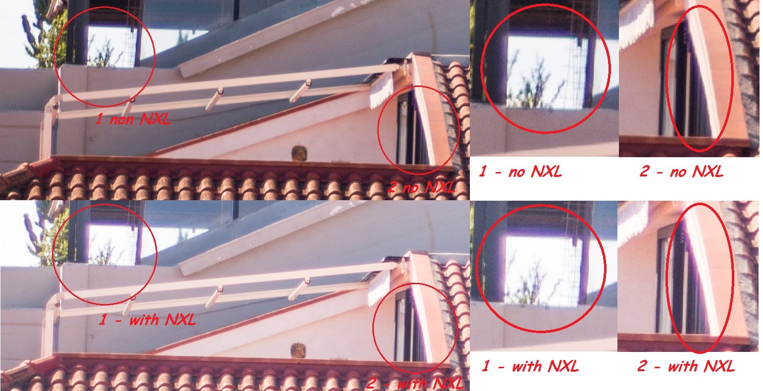

carlic Posted October 9, 2016 Share Posted October 9, 2016 14 hours ago, lucabutera said: NXL comparision test: 1) Bokeh - with and without NXL; 2) flare - with and without NXL; 3) sharpness - with and without NXL. Camera, Samung nx1 - lens, Canon 50mm 1.8 - model Bubu. raw files included. Great job, thanks! As expected for a wide aperture it is soft with lots of chromattic abberations. For the sharpnes edge to edge, I meant a shot at the sharpest aperture like f8, you can even use a sharper lens if you have one. As for purple fringing I was suprised how much more promemant was with the booster (right), why do you think that is? Link to comment Share on other sites More sharing options...

Sten Posted October 9, 2016 Share Posted October 9, 2016 5 hours ago, carlic said: As for purple fringing I was suprised how much more promemant was with the booster (right), why do you think that is? substandard glass used - quality focal reducers, such as Vixen, use ED glass - for a DIY project, you can try fitting the front element of ZEN ED2 7x36 Binoculars inside an Nikon-NX adapter for use with FF ED lenses from Nikon or Samyang Link to comment Share on other sites More sharing options...
lucabutera Posted October 9, 2016 Author Share Posted October 9, 2016 14 hours ago, carlic said: Great job, thanks! As expected for a wide aperture it is soft with lots of chromattic abberations. For the sharpnes edge to edge, I meant a shot at the sharpest aperture like f8, you can even use a sharper lens if you have one. As for purple fringing I was suprised how much more promemant was with the booster (right), why do you think that is? Thank you Carlic, what you see is only a perception caused by an increase in brightness, picture 1 (without NXL) and picture 2 (with NXL) have the same purple fringing, no sane photographer would shoot to 1.8 (1.4 with NXL) in the midday sun! Remember that I am using a Canon 50mm 1.8 cheap lens, it created the purple fringing. I today took a picture at 10:30 morning, when the sun is back my shoulders , always f1.8, no purplue fringing and excellent sharpness. Raw file : SAM_0616.dng Marco Tecno, SMGJohn, Kisaha and 1 other 4 Link to comment Share on other sites More sharing options...
