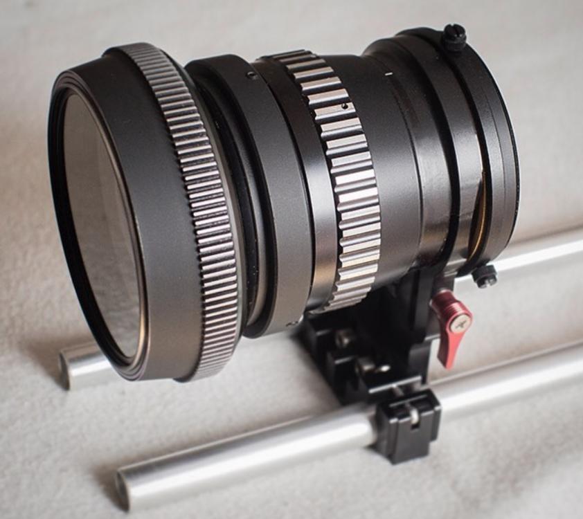

Hans Punk Posted August 12, 2016 Share Posted August 12, 2016 2 hours ago, victorshoots said: Thanks for the reply Hans. Do you have a Core DNA yourself? Could you speak of it's optical/mechanical quality at all? Yes I have one. It's optically great, mechanically poor IMO. But It's probably the best solution out there at the moment for use with the Kowa Inflight 35, You will probably need some modification to make it work at its best. DM me if you need specific pointers (it can be a lengthy process). Here it is on my Inflight PA-35, with configured rail mount and custom clamps. Ian Edward Weir 1 Link to comment Share on other sites More sharing options...
Laurier Posted August 12, 2016 Share Posted August 12, 2016 1 hour ago, Hans Punk said: Yes I have one. It's optically great, mechanically poor IMO. But It's probably the best solution out there at the moment for use with the Kowa Inflight 35, You will probably need some modification to make it work at its best. DM me if you need specific pointers (it can be a lengthy process). Here it is on my Inflight PA-35, with configured rail mount and custom clamps. Is that a black painted rectilux core dna ? Link to comment Share on other sites More sharing options...
Hans Punk Posted August 12, 2016 Share Posted August 12, 2016 29 minutes ago, Laurier said: Is that a black painted rectilux core dna ? Yes, reworked internals and more durable matte paint finish on exterior. Link to comment Share on other sites More sharing options...
Laurier Posted August 12, 2016 Share Posted August 12, 2016 3 minutes ago, Hans Punk said: Yes, reworked internals and more durable matte paint finish on exterior. I m about to do the same thing , what did you reworked ? there a bit of play on mine , I m getting better screws . Link to comment Share on other sites More sharing options...
Hans Punk Posted August 12, 2016 Share Posted August 12, 2016 Teflon replacement collars for the guide screws is a good start. (Replacing the brass collars with Teflon ones will reduce friction noise when focusing) - I also reworked the internal focus mechanism to have a better strength and tolerance - that eliminated wobble. A bit too many other details and tweaks to list here without hijacking the thread topic. valid and IshootbeforeItalk 2 Link to comment Share on other sites More sharing options...
victorshoots Posted August 12, 2016 Author Share Posted August 12, 2016 Thats great info thank you. Would you say now with those mods the unit is production useable? Would you attach a Fiz motor to the dna? How close to the front element do you have the dna? I noticed the rear is 75mm on the dna which is a bit too small to fit the kowa inside unless some machining is done to either lens or the dna? Link to comment Share on other sites More sharing options...

Hans Punk Posted August 12, 2016 Share Posted August 12, 2016 2 hours ago, victorshoots said: Thats great info thank you. Would you say now with those mods the unit is production useable? Would you attach a Fiz motor to the dna? How close to the front element do you have the dna? I noticed the rear is 75mm on the dna which is a bit too small to fit the kowa inside unless some machining is done to either lens or the dna? Depends on the production I've got a high torque stepper focus motor for my moco pan/tilt head - and I'm very cautious about setting the limit points on it, as it would be feasible that if left to overshoot - it would unscrew the DNA, or dislodge it's grip. This is something to get used to and take care with, not a huge deal. I've rigged the DNA with an empty 72mm uv filter clamped flush to the rear (fits snugly into that 75mm rear opening) - that then effectively gives you a solid 72mm rear thread for quickly screw mounting onto a quality front filter clamp, such as Redstan makes (works great on the smaller Kowa Bell & Howell this way). Soon I will be opening up the diameter with a lathe to allow a 77mm step ring to mount in the same way - giving me a few more millimeters to get the DNA rear closer to the Kowa Inflight front. At the moment I have a custom Rapido front clamp for the inflight that fixes to the front of the lens - after it's retainer ring has been removed (the knurled ring with white writing on) - this allows even closer mounting to the front. The plan is to open up the DNA rear just enough to screw directly onto that rapido clamp (77mm)...at the moment it has a 77-72 step down to join the two. As it is, it works well - but on full frame the edges suffer from mild blurring, due to the DNA not being close enough to the kowa front optic. This is why opening the rear diameter of the DNA is worth a try. On APSC and smaller, this problem will be less of an issue - but still present. Link to comment Share on other sites More sharing options...
victorshoots Posted August 12, 2016 Author Share Posted August 12, 2016 10 minutes ago, Hans Punk said: Depends on the production I've got a high torque stepper focus motor for my moco pan/tilt head - and I'm very cautious about setting the limit points on it, as it would be feasible that if left to overshoot - it would unscrew the DNA, or dislodge it's grip. This is something to get used to and take care with, not a huge deal. I've rigged the DNA with an empty 72mm uv filter clamped flush to the rear (fits snugly into that 75mm rear opening) - that then effectively gives you a solid 72mm rear thread for quickly screw mounting onto a quality front filter clamp, such as Redstan makes (works great on the smaller Kowa Bell & Howell this way). Soon I will be opening up the diameter with a lathe to allow a 77mm step ring to mount in the same way - giving me a few more millimeters to get the DNA rear closer to the Kowa Inflight front. At the moment I have a custom Rapido front clamp for the inflight that fixes to the front of the lens - after it's retainer ring has been removed (the knurled ring with white writing on) - this allows even closer mounting to the front. The plan is to open up the DNA rear just enough to screw directly onto that rapido clamp (77mm)...at the moment it has a 77-72 step down to join the two. As it is, it works well - but on full frame the edges suffer from mild blurring, due to the DNA not being close enough to the kowa front optic. This is why opening the rear diameter of the DNA is worth a try. On APSC and smaller, this problem will be less of an issue - but still present. Fair enough that makes sense to me. No auto calibrate is probably safer bet hah. Can the core DNA be taken apart to have the rear mount milled out? I asked rectilux if he could make a custom one but he said he won't unfortunately. Was worth a shot. He doesn't seem the best at communicating which made me a little skeptical but if you say the optics are worth it i'll take your word for it. Pretty close to pulling the trigger on one. Did you mod your own setup or send away? What is your favourite taking lens with your setup? How close do you align the kowa rear element to the taking lens? Cheers! Link to comment Share on other sites More sharing options...
Hans Punk Posted August 12, 2016 Share Posted August 12, 2016 1 minute ago, victorshoots said: Fair enough that makes sense to me. No auto calibrate is probably safer bet hah. Can the core DNA be taken apart to have the rear mount milled out? I asked rectilux if he could make a custom one but he said he won't unfortunately. Was worth a shot. He doesn't seem the best at communicating which made me a little skeptical but if you say the optics are worth it i'll take your word for it. Pretty close to pulling the trigger on one. Did you mod your own setup or send away? What is your favourite taking lens with your setup? How close do you align the kowa rear element to the taking lens? Cheers! Very easy to dismantle DNA...I modified mine myself. It is only the larger Inflight 1.75x that can be a bit of a pain to get it working with - other lenses (such as Kowa B&H/ 8Z etc) will work fine with the standard 75mm rear opening. Optically, the DNA is probably the best choice for now in my opinion - just don't expect precision engineering out of the box (it wobbles and makes a horrible noise when focusing) but that can be adjusted and the optic quality just about makes the price worth it IMHO. I tend to shoot with an old 100mm meyer optik f2.8 zebra - set no wider than f4 on full frame. Gives good all round performance and sharpness at that stop. All vari-diopters increases the apparent defocus bokeh, so f4 can be plenty shallow enough. DNA/Rectilux/FM module/ SLR Rangefinder are all single element design to their diopters, so fast open apertures are always going to show aberrations/glow/blur of some kind. Achromatic optics (if even they could be made at scale) would be horrendously expensive and noticeably heavy but would solve this issue. How close do you align the kowa rear element to the taking lens? I have my setup as rail mounted - so I either attach taking lens via an empty cpl ring (so taking lens can turn into camera mount whilst still attached to everything) or simply by pushing the kowa rear as close as possible to taking lens front, using a rubber collapsible sun hood as a donut. The optic rear of the Kowa is protected by collision by a uv filter and its diameter, relative to the taking lens front. It's a setup that I find can work very well. The other advantage of having the setup rail mounted, is that i can mount a VND to the rear of the kowa and in front of the taking lens...this works very well. DIGICHombre 1 Link to comment Share on other sites More sharing options...
