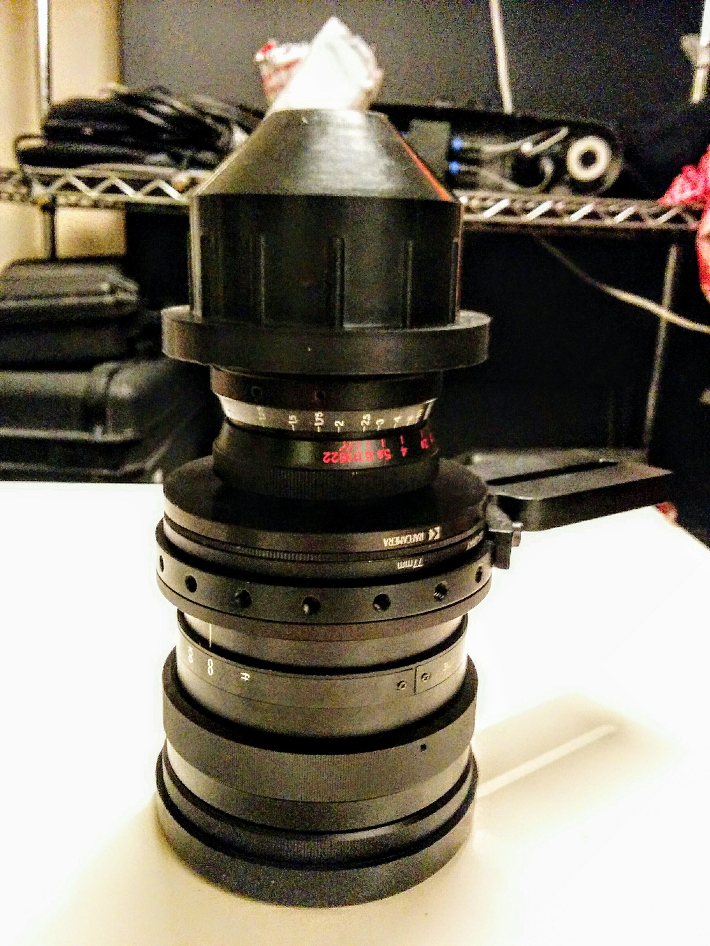

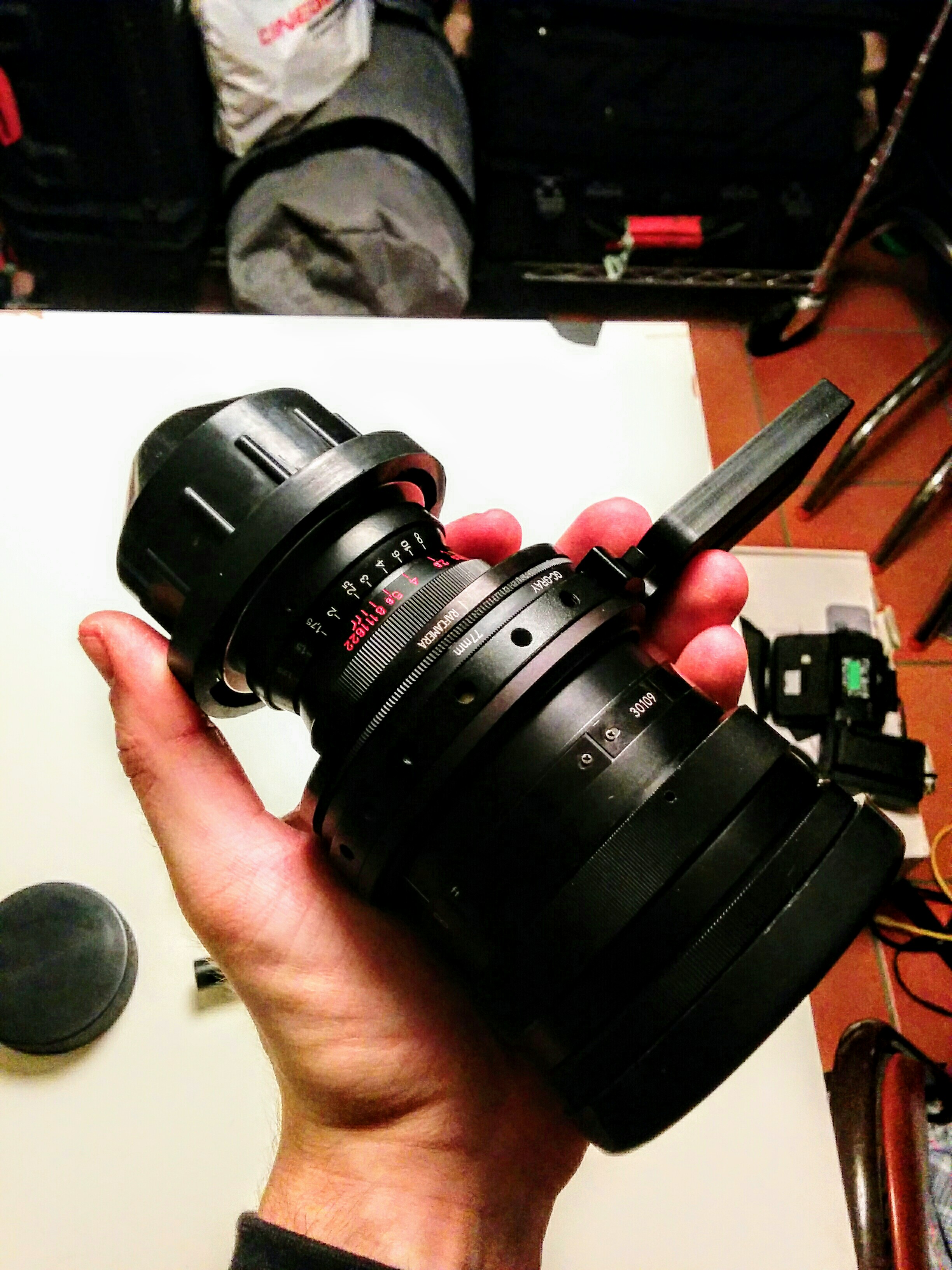

victorshoots Posted August 19, 2016 Author Share Posted August 19, 2016 17 hours ago, Hans Punk said: Tito's calculator is a handy tool to work things out. http://www.tferradans.com/blog/?p=8615 Where there is less info on vignette with a 1.75x lens, treat it as 1.5x stretch, but allow a little wiggle room in the numbers (round up a little to be safe). I'm my experience, 1.75x lenses can often be regarded as a 1.5x stretch, as most medium/close focus distance scenarios (non infinity) will always yield less of the stretch ratio from the lens...as all Anamorphic stretch ratios are measured at the infinity point. Definitive answers on taking lens vignette or performance can depend on many things...often the way to find a good pairing is to test out for yourself. Also a taking lens' coverage may be slightly flexible if you are able to shoot 4:3 or 3:2 aspect in camera...or if you plan to shoot 16:9 aspect and post crop. Perfect thanks again for the info it's been a great help! Finally have the Kowa in my hands and it looks pretty great! Some light cleaning marks on the front but otherwise very nice from my eye. Just working on making a nice hard mount for it on some rails to start. Next step is order the Core DNA and send the pair off for machining and fine adjustments. Hans Punk and Ian Edward Weir 2 Link to comment Share on other sites More sharing options...

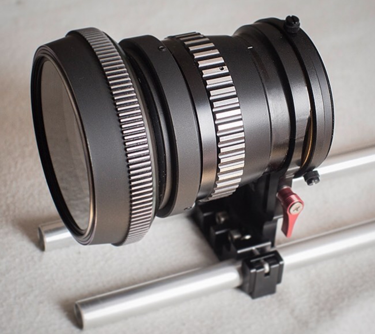

victorshoots Posted January 13, 2017 Author Share Posted January 13, 2017 So i've been waiting for bit for a while and patiently waiting for the Core DNA to come back in stock to finish my setup. Here is how she sits now! The new Rapido system is great. Had some custom step up rings machined by Raf in russia and everything mates together now. Once I get the rectilux i'll do an initial test then send away for cleaning/adjustment at super16 inc. Ian Edward Weir, Hans Punk, tweak and 1 other 4 Link to comment Share on other sites More sharing options...

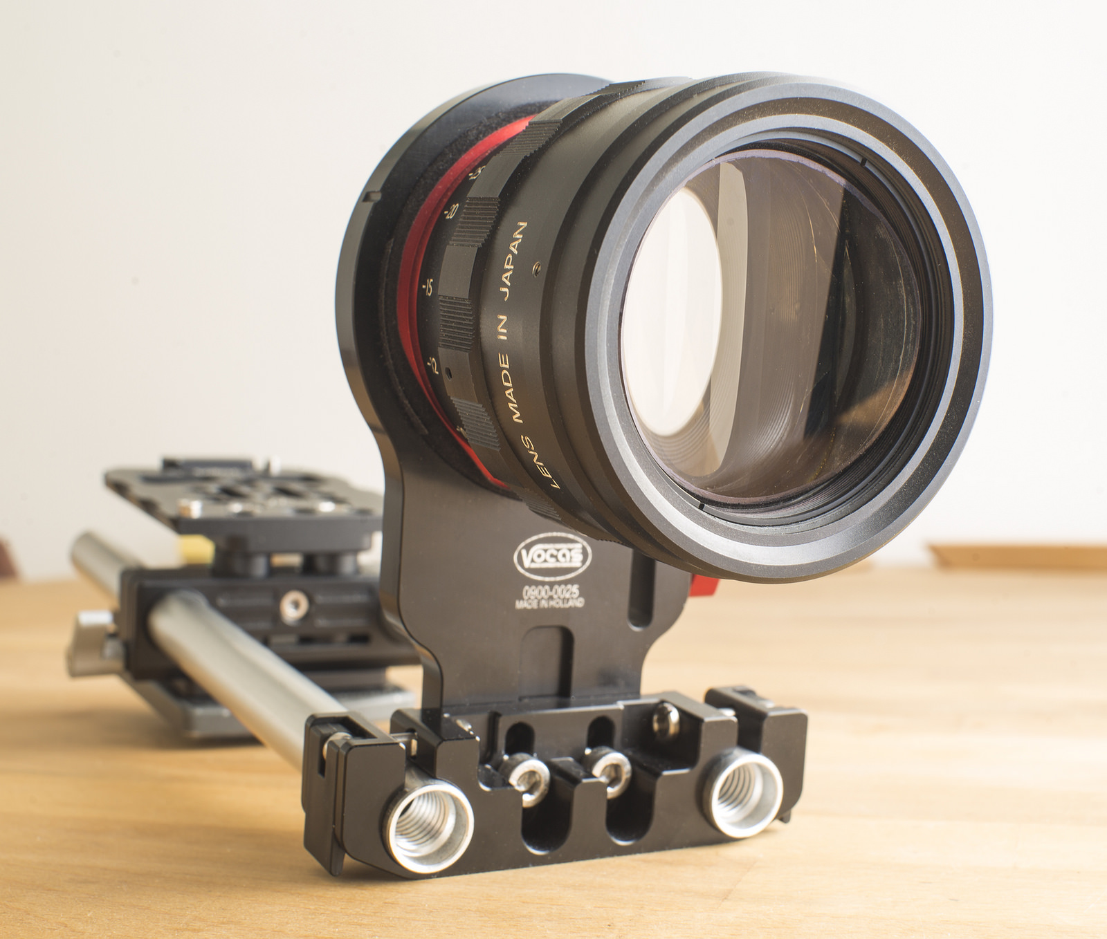

DamienMTL Posted January 14, 2017 Share Posted January 14, 2017 On 2016-08-12 at 3:28 AM, Hans Punk said: Here it is on my Inflight PA-35, with configured rail mount and custom clamps. Looks super nice. who did the lens bracket? I need exactly the same for my KOWA 16H. thanks Link to comment Share on other sites More sharing options...
Hans Punk Posted January 15, 2017 Share Posted January 15, 2017 4 hours ago, DamienMTL said: Looks super nice. who did the lens bracket? I need exactly the same for my KOWA 16H. thanks It's actually an adapter made by Vocas for mounting a PL to E-mount adapter. The inner clamp diameter is a fraction bigger than the outer diameter of a Redstan clamp...with a thin layer of felt tape applied on the inside, It resolves the issue perfectly. It gives a very secure grip, as well as avoiding metal on metal damage when cranking down on the clamp support to lock everything tight. Here is my other setup with the B&H attached. DamienMTL 1 Link to comment Share on other sites More sharing options...
victorshoots Posted January 17, 2017 Author Share Posted January 17, 2017 The V2 clamping system from Rapido is really solid and priced very well imo. I had rafcamera make me some custom step up fronts with a 77mm thread. Mates right to the Rapido and I used a rotating empty 77mm filter to be able to swap easier once mounted. rook, Ian Edward Weir and Hans Punk 3 Link to comment Share on other sites More sharing options...
