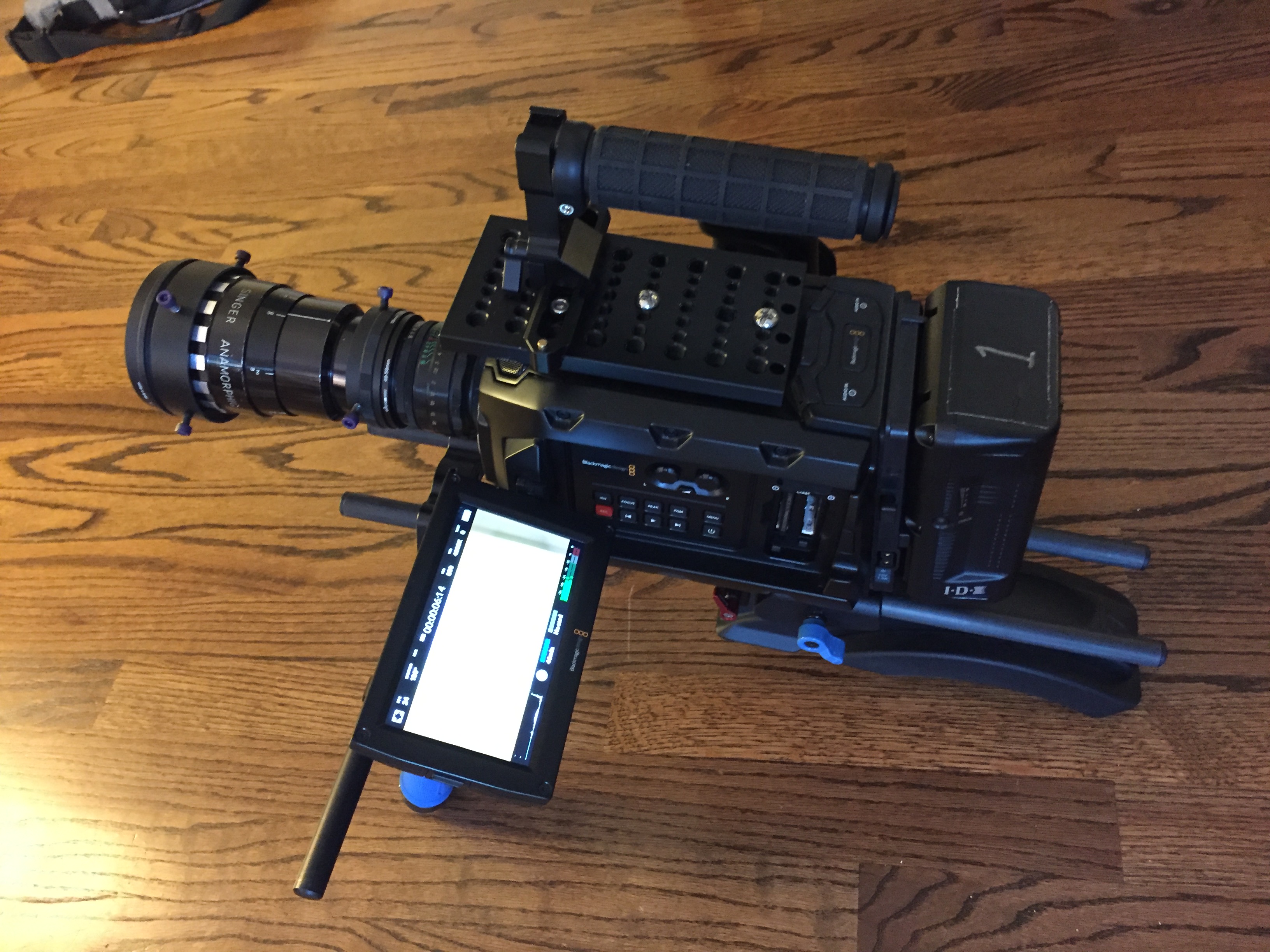

AaronChicago Posted August 19, 2016 Share Posted August 19, 2016 I came across this lens used and it's been sitting around. BM just updated to an anamorphic mode on the 4.6K so I wanna try it out. I'm so clueless when it comes to anamorphic. The rear diameter says it's 52mm. So here are my questions: -What adapters would I need to connect it to a 50mm taking lens with a 49mm front thread (Helios) or a 72mm front thread (rokinon)? -The front filter thread says 71mm. What kind of adapter would I need to attach filters that are 72mm? -Would the SLR Magic Rangefinder be useful in this situation as a single focus? Link to comment Share on other sites More sharing options...

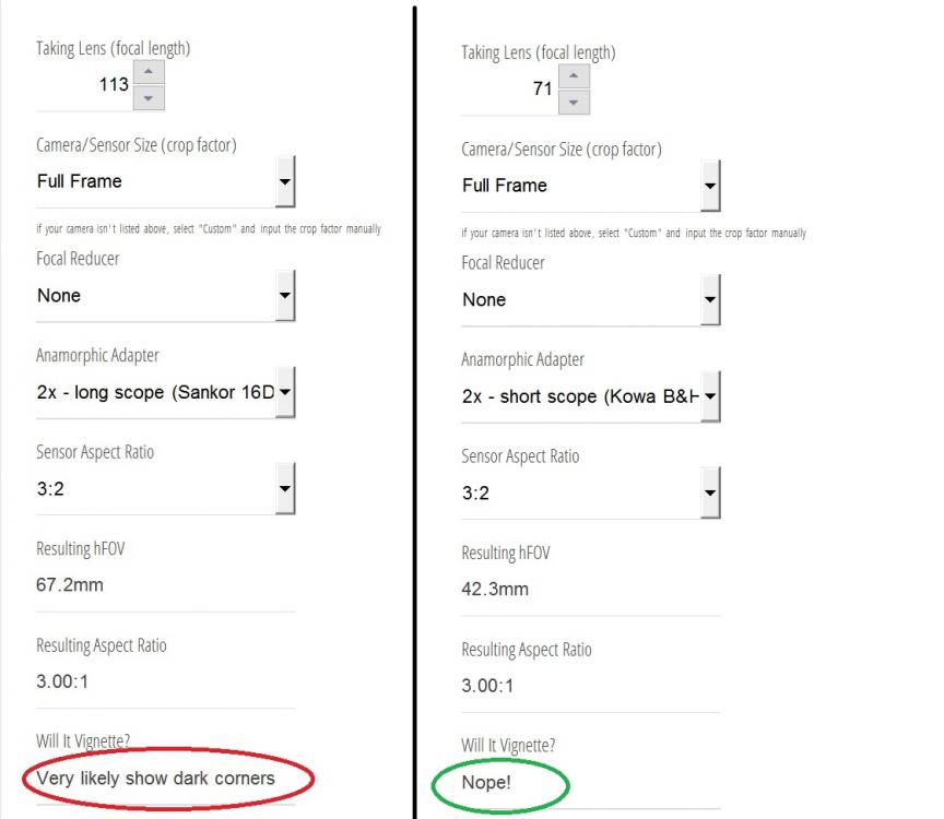

ken Posted August 29, 2016 Share Posted August 29, 2016 16D needs 135mm or over on FF. 16H can go below 85mm on FF. Link to comment Share on other sites More sharing options...

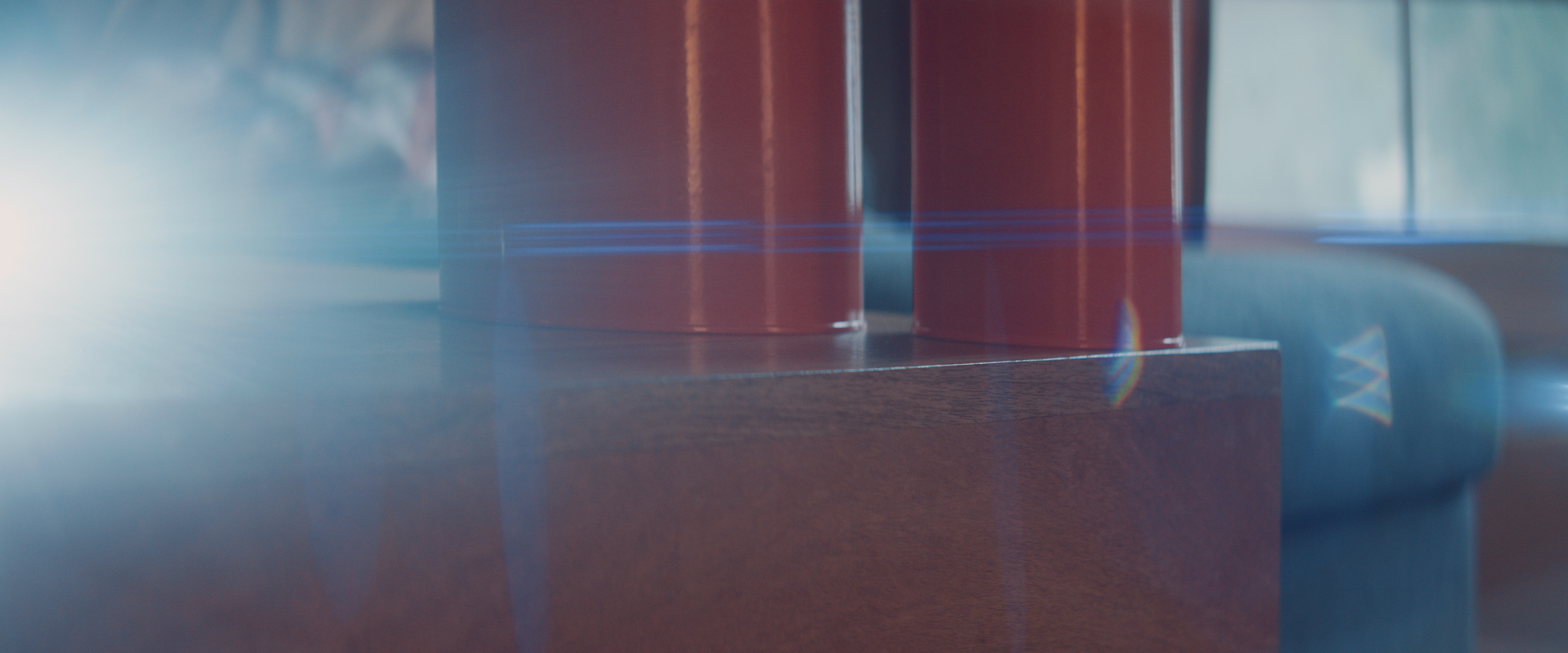

AaronChicago Posted August 29, 2016 Author Share Posted August 29, 2016 Well I have it looking a little better. The white vignette only pops up when a light source is hitting the lens. See below. Link to comment Share on other sites More sharing options...

ken Posted September 3, 2016 Share Posted September 3, 2016 10 hours ago, AaronChicago said: For anyone else interested in the Singer 16D don't listen to Ken. 50mm works fine on Super 35mm with the Ursa Mini. No vignetting. Not sure why he was so confident it's "impossible". What I said is based on FF, nothing wrong. According to TITO's calculator, comparing with 16H, you can see how much difference. By the way, IMO, without vignetting, must be focus at infinity with small aperture to test. Link to comment Share on other sites More sharing options...
