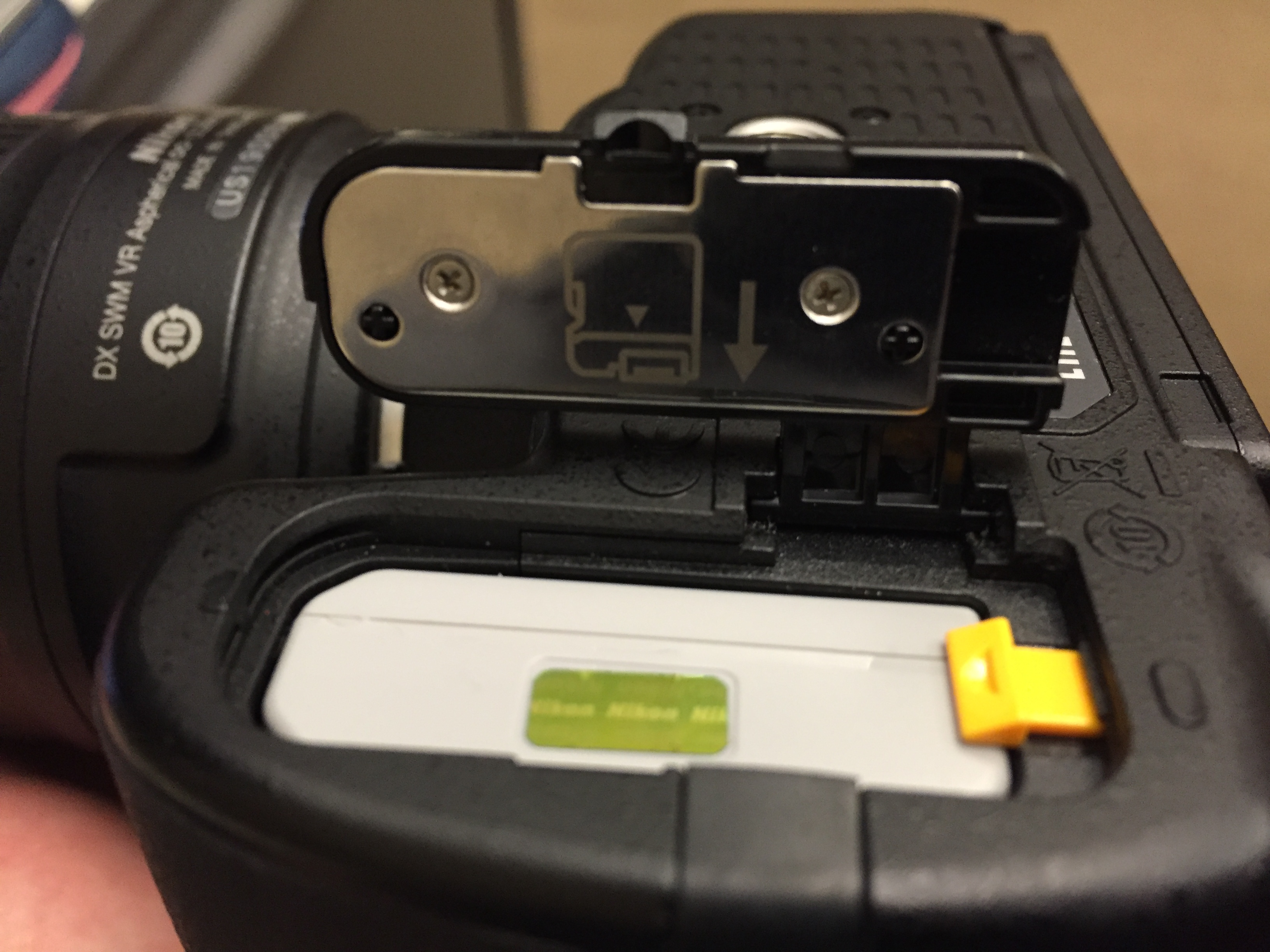

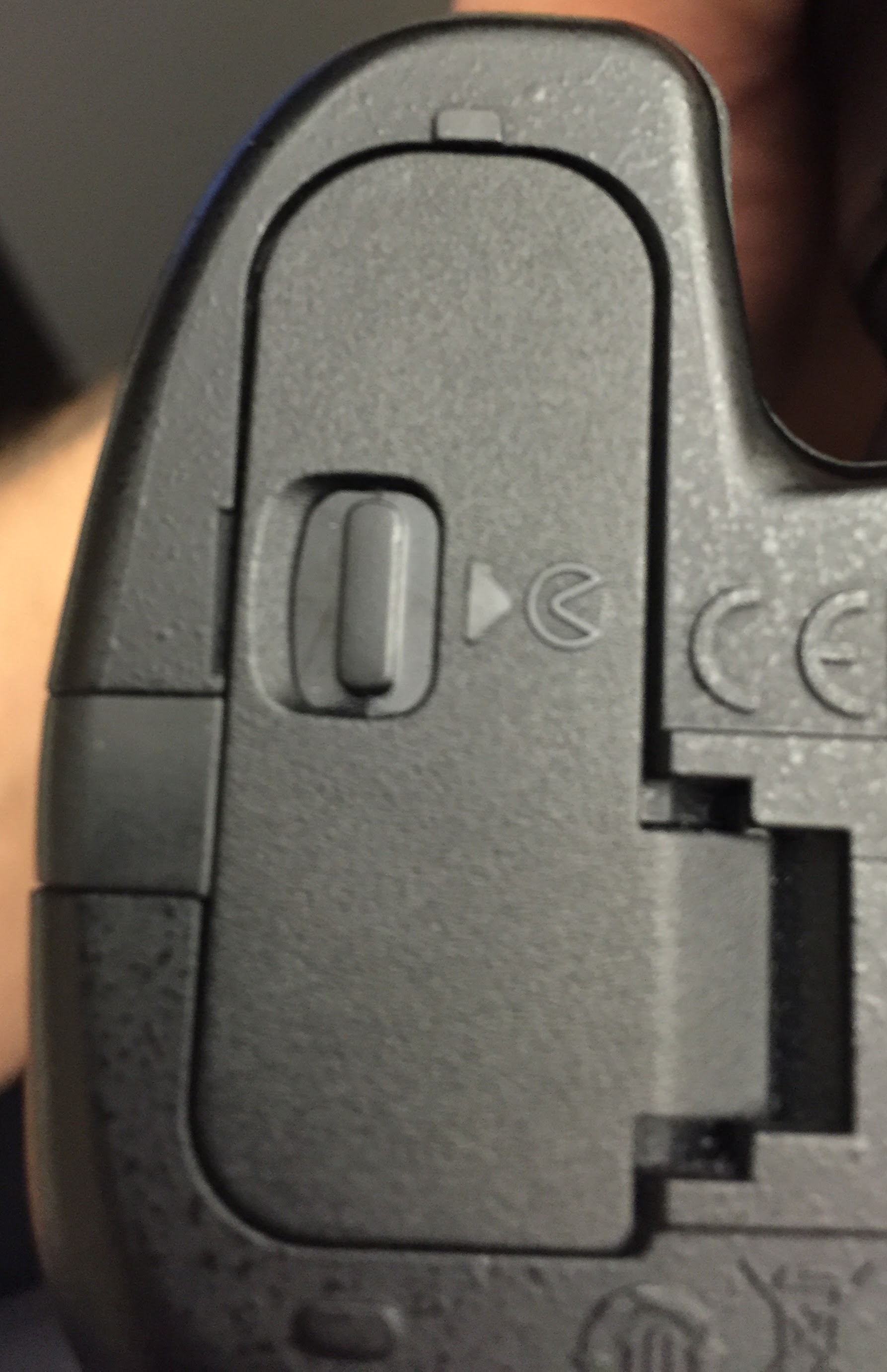

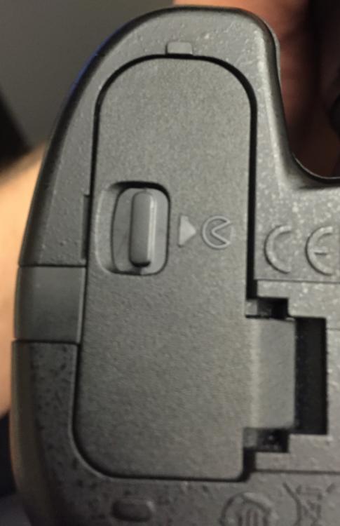

Dustin Posted September 5, 2016 Author Share Posted September 5, 2016 On 9/2/2016 at 0:37 AM, tupp said: No. You probably don't need to leave the battery door open -- look for a small rubber piece on/near the battery door that opens to allow a cable/connector to pass through. I can't seem to find that spot. Here is the battery compartment on my d5300. The outside battery door is rock solid with no cutouts. However I have looked at my tripod and it seems it does have room to open but I'm just worried it might fall out.. Link to comment Share on other sites More sharing options...
tupp Posted September 5, 2016 Share Posted September 5, 2016 6 hours ago, Dustin said: I can't seem to find that spot. Here is the battery compartment on my d5300. The outside battery door is rock solid with no cutouts. However I have looked at my tripod and it seems it does have room to open but I'm just worried it might fall out.. What is the thing shown inside the yellow circle?: Link to comment Share on other sites More sharing options...

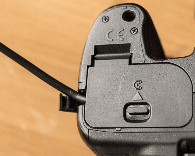

Richard Bugg Posted September 6, 2016 Share Posted September 6, 2016 That is a rubber boot that can be pulled back and which allows the cable from a dummy battery to exit the body with the battery door closed. Here it is on the D750 with dummy battery inserted. tupp 1 Link to comment Share on other sites More sharing options...
Dustin Posted September 6, 2016 Author Share Posted September 6, 2016 16 hours ago, Richard Bugg said: That is a rubber boot that can be pulled back and which allows the cable from a dummy battery to exit the body with the battery door closed. Here it is on the D750 with dummy battery inserted. You sir are the mvp. thank you! Richard Bugg 1 Link to comment Share on other sites More sharing options...
Richard Bugg Posted September 6, 2016 Share Posted September 6, 2016 As it turns out I didn't know this either until tupp pointed it out a few posts back. I just happened to get my dummy battery/AC power adapter a few days ago (Nikon knockoff via ebay) to help record an event to a Blackmagic video assist without the camera batteries cutting out. That's the value of a community putting ideas into the melting pot. tupp had the knowledge; I had a couple of pictures. Bam! Problem solved. tupp 1 Link to comment Share on other sites More sharing options...

tupp Posted September 7, 2016 Share Posted September 7, 2016 On 9/5/2016 at 4:37 PM, tupp said: What is the thing shown inside the yellow circle?: On 9/6/2016 at 5:46 PM, Richard Bugg said: That is a rubber boot that can be pulled back and which allows the cable from a dummy battery to exit the body with the battery door closed. Here it is on the D750 with dummy battery inserted. Thanks for the photos, but I already knew the answer to my question. I guess that I mistakenly supposed that the OP would find the hatch after I circled it in bright yellow. Link to comment Share on other sites More sharing options...
Dustin Posted September 7, 2016 Author Share Posted September 7, 2016 1 hour ago, tupp said: Thanks for the photos, but I already knew the answer to my question. I guess that I mistakenly supposed that the OP would find the hatch after I circled it in bright yellow. No need to be snarky here. I woke up to both Richard and your posts and simply happened to see both of them at the same time. I'm not a complete dumbass - I just don't have that much electrical know-how. Jeez. Link to comment Share on other sites More sharing options...
