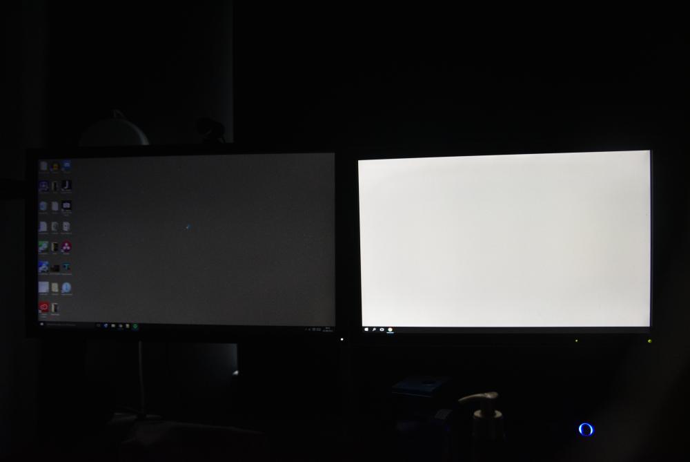

Inazuma Posted September 2, 2016 Share Posted September 2, 2016 19 hours ago, DPC said: I wasn't clear enough. I would like to eliminate the moiré that appears on footage of LED screens when filmed. Like I said, you can try using a circular polariser to fade out the LED screens. Attached image - left is an LED screen, right is an LCD screen. I don't know if it will eliminate moire but fading them out will make them less distracting. Link to comment Share on other sites More sharing options...
