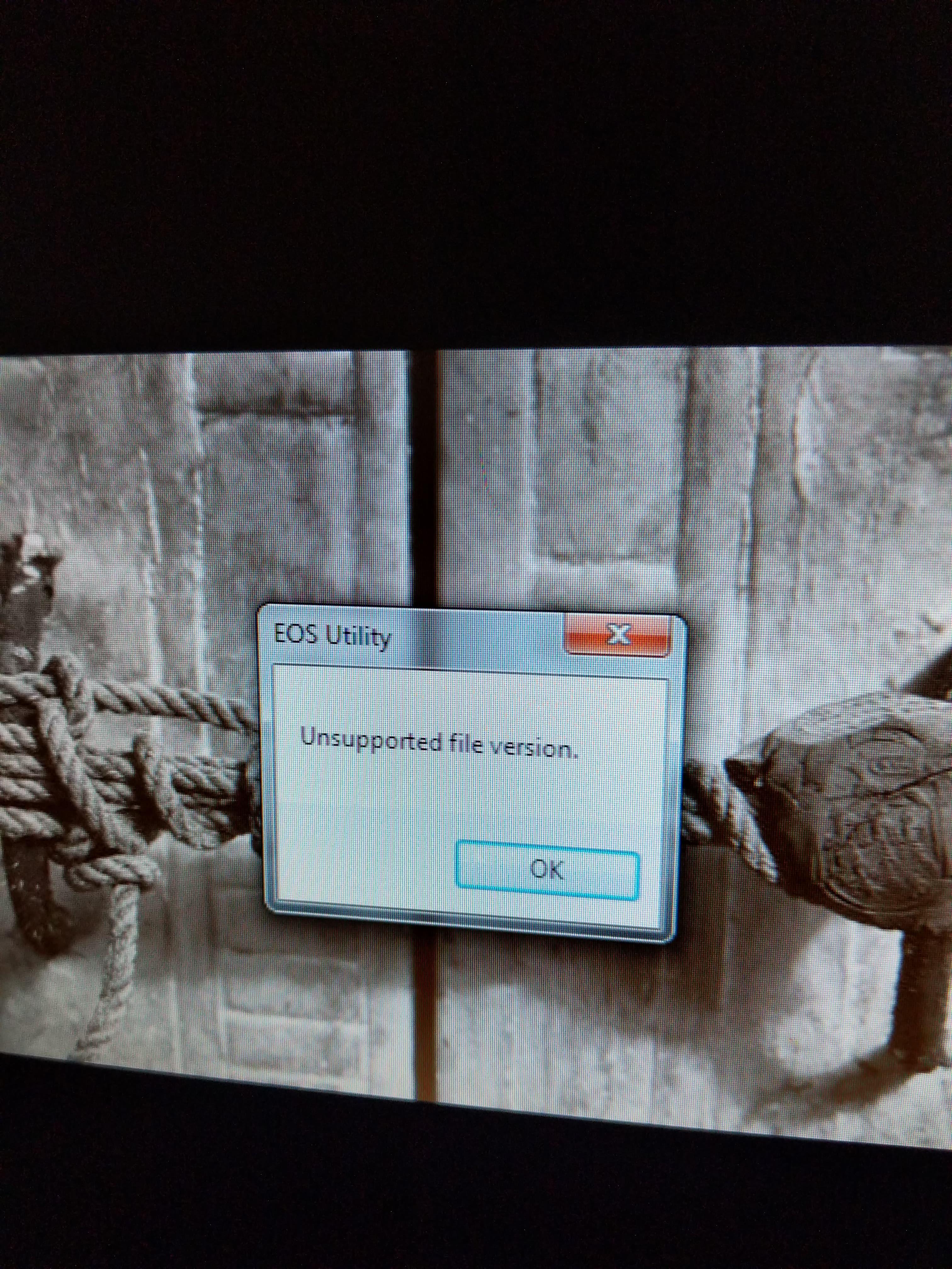

Truong Thắng Posted December 21, 2017 Share Posted December 21, 2017 Lol, anybody has the same problem ? Quote Link to comment Share on other sites More sharing options...

Truong Thắng Posted December 30, 2017 Share Posted December 30, 2017 Andrew, I think you just ignore me on purpose. Quote Link to comment Share on other sites More sharing options...
Ches Owen Posted January 2, 2018 Share Posted January 2, 2018 Anyone figure this out. I’m getting the same errors Quote Link to comment Share on other sites More sharing options...
Administrators Andrew Reid Posted January 18, 2018 Author Administrators Share Posted January 18, 2018 On 30/12/2017 at 6:59 AM, Truong Thắng said: Andrew, I think you just ignore me on purpose. Nope, I emailed you. Did you not get it? On 02/01/2018 at 9:46 AM, Ches Owen said: Anyone figure this out. I’m getting the same errors What version of EOS Utility? I can't diagnose problems when you give me zero information to go off, you know. On 17/12/2017 at 11:15 AM, Truong Thắng said: By the way, My firmware is up to date (1.0.4) 1.0.4 came out ages ago in April 2017. I don't think this is the problem. There have been many successfully uses of C-LOG on 5D Mk IV since then. If Canon blocked picture profile installation I would have known about it months before. On 17/12/2017 at 11:15 AM, Truong Thắng said: I am using the newest Canon ultilities also. Please look at the pics and tell me what i need to do to solve the issue. A) What version exactly of EOS Utility? B) Maybe the download is corrupt or incomplete. How large are the picture profile PF3 files on your drive? C) What mode is the camera in? Should be in stills mode, not movie mode On 17/12/2017 at 11:15 AM, Truong Thắng said: Quote Link to comment Share on other sites More sharing options...

colefulton Posted June 27, 2018 Share Posted June 27, 2018 hi I bought the Clog package and am trying to upload it via my PC onto my 1DX mk ii but i keep getting this response when adding it into the register picture style file please help Quote Link to comment Share on other sites More sharing options...
