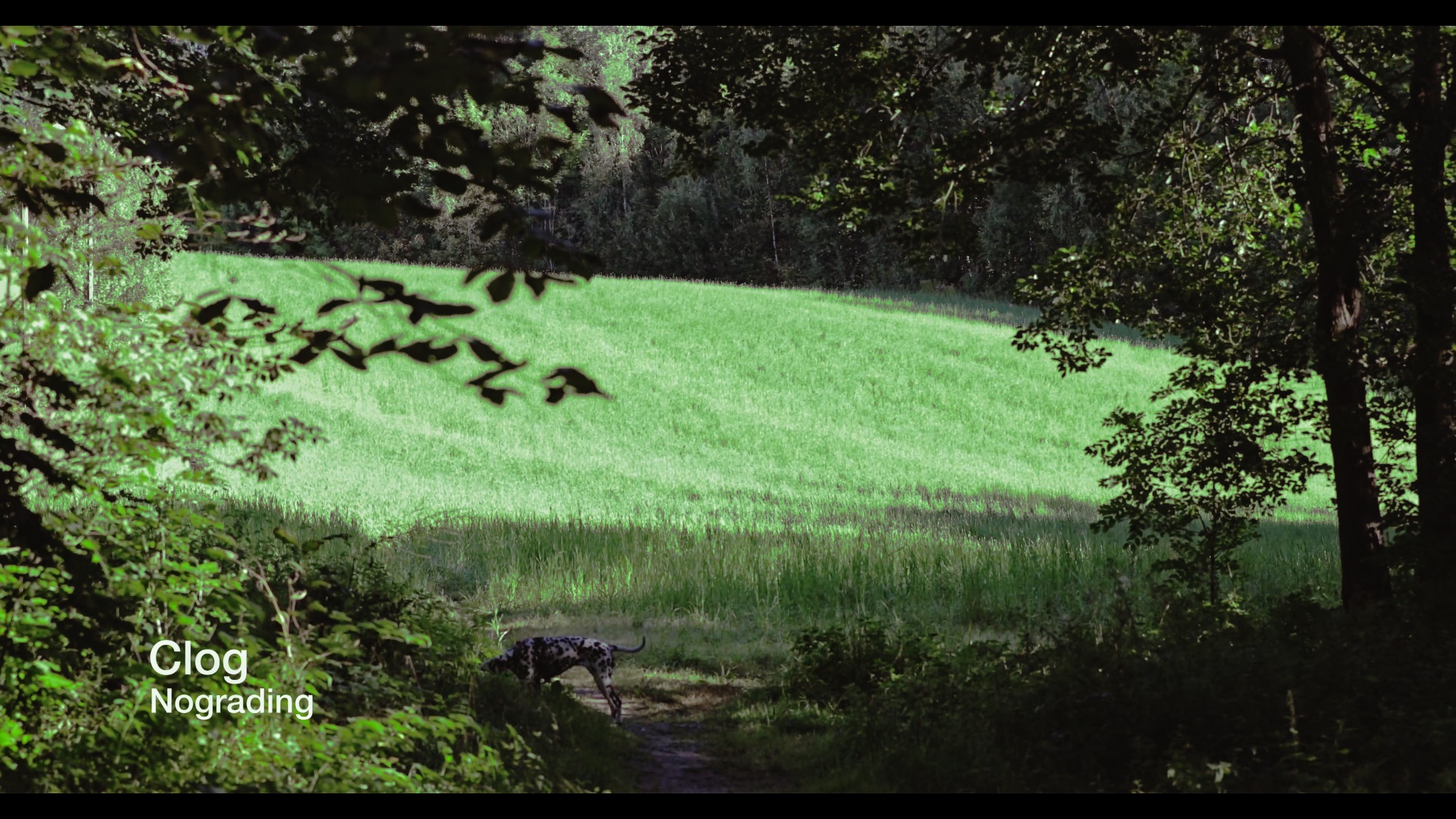

Asmundma Posted September 4, 2016 Share Posted September 4, 2016 Test of clog : Tried to find som contrasty scenes - when I was out with our dog this morning. Link to comment Share on other sites More sharing options...

Asmundma Posted September 4, 2016 Share Posted September 4, 2016 On 9/4/2016 at 11:42 AM, dvcrn said: Just bumping this again in the hope anyone can answer this Expand I am 99% sure you will be able to download them via the EOS utility to the Canon 80. However its still up for jugdement if they help getting a better frame. If you look at my video, I get better results with standard picture style. I am not able to get the green color back of the grass using clog and out & grading, but with standard I am. But I may have done something wrong, so you should wait for other testers. Link to comment Share on other sites More sharing options...
Administrators Andrew Reid Posted September 4, 2016 Author Administrators Share Posted September 4, 2016 On 9/4/2016 at 12:07 PM, Asmundma said: I am 99% sure you will be able to download them via the EOS utility to the Canon 80. However its still up for jugdement if they help getting a better frame. If you look at my video, I get better results with standard picture style. I am not able to get the green color back of the grass using clog and out & grading, but with standard I am. But I may have done something wrong, so you should wait for other testers. Expand Some friendly advice: The bright patch of grass isn't green because it is overexposed. Since C-LOG raises the shadows, you should have exposed for the highlights and the dark areas would have been recoverable in post. Once the grass is burnt it's gone. I don't agree you got the better results with the standard picture profile - the grass is fucked on that too. Have fun! On 9/4/2016 at 6:42 AM, dvcrn said: Honest question - I'd buy this pack immediately but is this even worth it for the 80D? I was thinking about something like this but fear it will just turn the footage into a noisy mess. Phillip Bloom posted a very similar post a few days ago. I asked the same question with the answer that the 80D probably won't be able to handle it. Expand It's definitely worth trying on the 80D. It won't be a noisy mess if you expose correctly and keep the ISO under control - i.e. 100 for a high dynamic range scene (bright light) and no higher than 1600 in low light. No the image won't be as good as 4K but, hey, it is the 80D we're talking about not a 1D X Mark II. If anyone would like to post the original files for me to grade, I can show you the best way to grade each camera. On 9/4/2016 at 7:01 AM, tomsemiterrific said: Andrew, what GREAT products. Honestly, I can't seem to download the files for the 80d, but the download worked great for my 1dC. NOW, I have C-log on the 1dC with Auto focus----fantastic!!! Thank you so much. And the LUTS you made for LUTS are beautiful--lovely and useful. I had been so frustrated that Canon Log on the 1dC didn't have an AF option, but now you've solved that and included what seems to me three great LUTS. The Vivid Skin tone is GORGEOUS, requiring only small tweaks in exposure for publication...and the colors!!! I also like Scarlett a lot. I wish I could replace several of the Canon standard custom profiles with your monochrome--which is beautiful---and the other files. Awesome! Log with AF out of the 1dC---and three great LUTS. Thank you so much. Expand Thanks for the kind remarks. Did you mean 1D X Mark II with auto-focus though? You're replacing your 1D C with a 1D X Mark II right? On 9/4/2016 at 7:58 AM, Dave Del Real said: Am I supposed to ETTR? Getting artifacts in the shadows (actually worse on my Ninja2 than internal 7D2 - could be something wrong with my Ninja2). Expand Yes ETTR (expose to the right), but you have the choice to protect the highlights - don't go so far to the right that you blow out important areas of the frame. If you under expose a LOG image it looks crap (as we see from so much of the Sony S-LOG 2 footage out there). Liam and kaylee 2 Link to comment Share on other sites More sharing options...

squig Posted September 4, 2016 Share Posted September 4, 2016 On 9/4/2016 at 1:29 PM, Andrew Reid said: Some friendly advice: The bright patch of grass isn't green because it is overexposed. Since C-LOG raises the shadows, you should have exposed for the highlights and the dark areas would have been recoverable in post. Once the grass is burnt it's gone. I don't agree you got the better results with the standard picture profile - the grass is fucked on that too. Have fun! Expand Looks ok to me. Link to comment Share on other sites More sharing options...
Dan Wake Posted September 4, 2016 Share Posted September 4, 2016 it looks bluish to me. could try to use a white paper for white balance before shooting. Link to comment Share on other sites More sharing options...

Administrators Andrew Reid Posted September 4, 2016 Author Administrators Share Posted September 4, 2016 The grass shot still looks buggered... I would have exposed it very differently and the white balance is clearly wrong for daylight. On 9/4/2016 at 4:43 PM, tomsemiterrific said: No. I mean the 1dC. With my 1dC in Canon C-log there is no AF. There is no one push auto focus. Manual focus is your only option. AF is disabled when you go to Canon Log. Your C-Log, in contrast, doesn't disable Auto Focus, so the one push focus is retained. I use manual focus most of the time, but sometimes the "one push" AF is really necessary--otherwise forget getting the shot. So, your C-log is really helpful, and the LUTS for it are lovely--knocked me out how beautiful the colors are. Expand Ah I see what you mean! Good idea about one-shot push focus. tomsemiterrific 1 Link to comment Share on other sites More sharing options...
Asmundma Posted September 4, 2016 Share Posted September 4, 2016 On 9/4/2016 at 5:16 PM, Andrew Reid said: The grass shot still looks buggered... I would have exposed it very differently and the white balance is clearly wrong for daylight. Ah I see what you mean! Good idea about one-shot push focus. Expand Thanks for the comments. Could be wrong regarding the white balance, yes. I used AWB, so the camera decided. However the RGB looks balanced, but the vector scope is not. I checked the histogram before shooting and there was no clipping as far as I could see, but maybe i should have lowered the exposure even more. By the way, this is then opposite to slog for Sony as there one shall shoot 1-2 stops lighter ? Link to comment Share on other sites More sharing options...
Administrators Andrew Reid Posted September 4, 2016 Author Administrators Share Posted September 4, 2016 I see. You should try and get the peaks in the middle of the histogram on a shot like this where about 50% of the frame is over exposed. Link to comment Share on other sites More sharing options...
