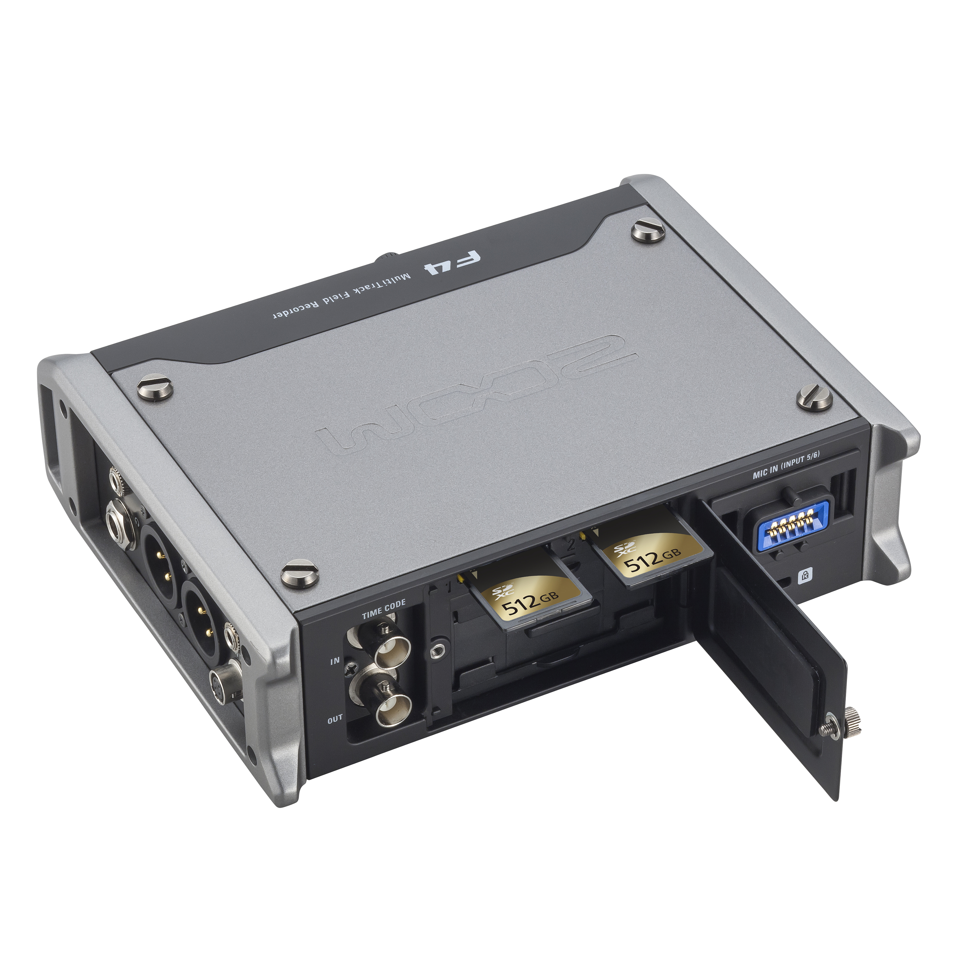

IronFilm Posted September 6, 2016 Share Posted September 6, 2016 My blog post on this news: http://ironfilm.co.nz/news-leak-zoom-f4-with-six-inputs-and-eight-tracks-is-like-a-new-low-priced-zoom-f8/ (some of it repeated below) News got leaked accidentally by B&H that a new Zoom F4 is coming. I think the Zoom F8 when it was announced was a groundbreaking new recorder in what it brought to a new low price point for soundies. Now the F4 is even cheaper ($650 vs $1K), and has nearly everything the F8 has! Except for most notably the lack of extra XLR inputs (8 vs 4, thus the names: F8 vs F4. The "F" = field recorder, "H" = handheld recorder such as H1/H4n/H5/H6) and the lack of an app for the F4 to mix on a tablet like you can with the F8. Oh, and in a more minor point the F4 has a monochrome screen vs the 4 color screen of the F8. But everything else (such as pre amps, and time code) is basically exactly the same as the F8! Here is the blurb and specs list from B&H (page is currently down, you need to use Google cache to view it): Quote Designed to provide big Hollywood sound on an affordable indie budget, Zoom F4 is a 6-input / 8-track professional field recorder featuring super-low-noise preamps and timecode with pinpoint accuracy. The unit provides recording and playback resolutions up to 24-bit/192 kHz with impressive audio specs including an extremely low noise floor (-127 dBu EIN) and high gain (up to +75 dB), with +4 dB line-level inputs. The on-board temperature-compensated crystal oscillator (TCXO) generates timecode at 0.2 ppm accuracy and supports all standard drop-frame and non-drop formats, as well as jam sync for external devices. The advanced on-board limiters provide overload protection for all inputs and outputs, which lets you capture audio in a wide range of environments. Limiting can be applied simultaneously at full resolution with 10 dB of headroom and features controls for setting threshold, attack, and release. The F4 offers four combo XLR-1/4" inputs, a 1/8" stereo input, and includes a Zoom mic-capsule input for recording six discrete tracks with an additional stereo mix, all at full 24-bit/192 kHz resolution. Additionally, inputs 5/6 can function as a camera return for audio monitoring only for confidence checks. The dual-SD card slot features simultaneous recording to both cards allowing you to make a backup or split recording with all eight tracks on one card and a stereo mix on the other. Each of the four XLR-1/4" inputs offers a dedicated preamp with gain control, phantom power, a six-segment LED level meter, plus a Record Ready and PFL switch. In addition to the 1/4" headphone output with a dedicated volume control, the F4 provides two main balanced XLR outputs, as well as two sub outs on a single unbalanced 1/8" stereo mini-jack, enabling easy connection to a camera. All timecode I/O is provided on BNC connectors and the unit includes a variable-frequency slate-tone generator to confirm levels. An easy-to-read 1.9" LCD display is suitable for use in all lighting environments including dark low-light sets to bright sunlight. The on-board mixer not only provides user-adjustable level, pan, and input/output delay, but also offers high-pass filtering for noise and wind reduction, phase inversion, and Mid-Side decoding. The F4 ships with a camera-mount adapter, AC power adapter, and download codes for Cubase LE and Wavelab LE. Six-input / eight-track multitrack field recorder with integrated mixer Six discrete inputs, including four with locking Neutrik XLR/TRS combo connectors, a stereo 3.5mm input, and Zoom mic-capsule input Compact and lightweight metal chassis, weighing just two pounds (without batteries) High-quality mic preamps with up to 75 dB gain, less than -127 dBu EIN, and +4 dB line inputs Support for up to 24-bit/192 kHz recording as well as 96, 88.2, 48, and 44.1 kHz, plus 47.952 and 48.048 kHz for HD video compatibility; 16-/24-bit resolution Accurate timecode (0.2 ppm) I/O on standard BNC connectors; dropframe/non-drop formats with Jam Sync Two different power supply options: 8x AA batteries or external DC battery pack with 4-pin Hirose connector Dedicated gain control knob, 6-segment LED level meter, and PFL/Solo switch for each channel Phantom power (+48V/+24V) on every preamp Advanced on-board limiters for input and output High-pass filter, phase invert, and Mid-Side decoder Input delay of up to 30ms per channel / output delay of up to 10 frames per output Compatible with all Zoom mic capsules; optional ECM extender cable enables remote positioning Dual XLR balanced Main Outs plus 1/8" stereo mini-jack Sub Out Dedicated headphone output (100mW) with front-panel volume control 1.9” white, backlit monochrome LCD Dedicated PFL display with viewable trim settings Dual SD/SDHC/SDXC card slots, up to 512GB each Records in BWF-compliant WAV or MP3 file formats Support for extensive metadata (BWF and iXML); input time, date, project, scene number, etc. Built-in tripod mount; camera-mount adapter also included Use as a 6-in/4-out USB audio interface (@ 96 kHz) kaylee 1 Link to comment Share on other sites More sharing options...
Michael Ma Posted September 6, 2016 Share Posted September 6, 2016 It looks like Zoom and Tascam has both finally paid for the SDXC license. I wonder if they'll update my Zoom H4n for SDXC support. Link to comment Share on other sites More sharing options...
IronFilm Posted September 6, 2016 Author Share Posted September 6, 2016 They show their F4 with a a terabyte of storage in it!! :-o Holy crap. Link to comment Share on other sites More sharing options...

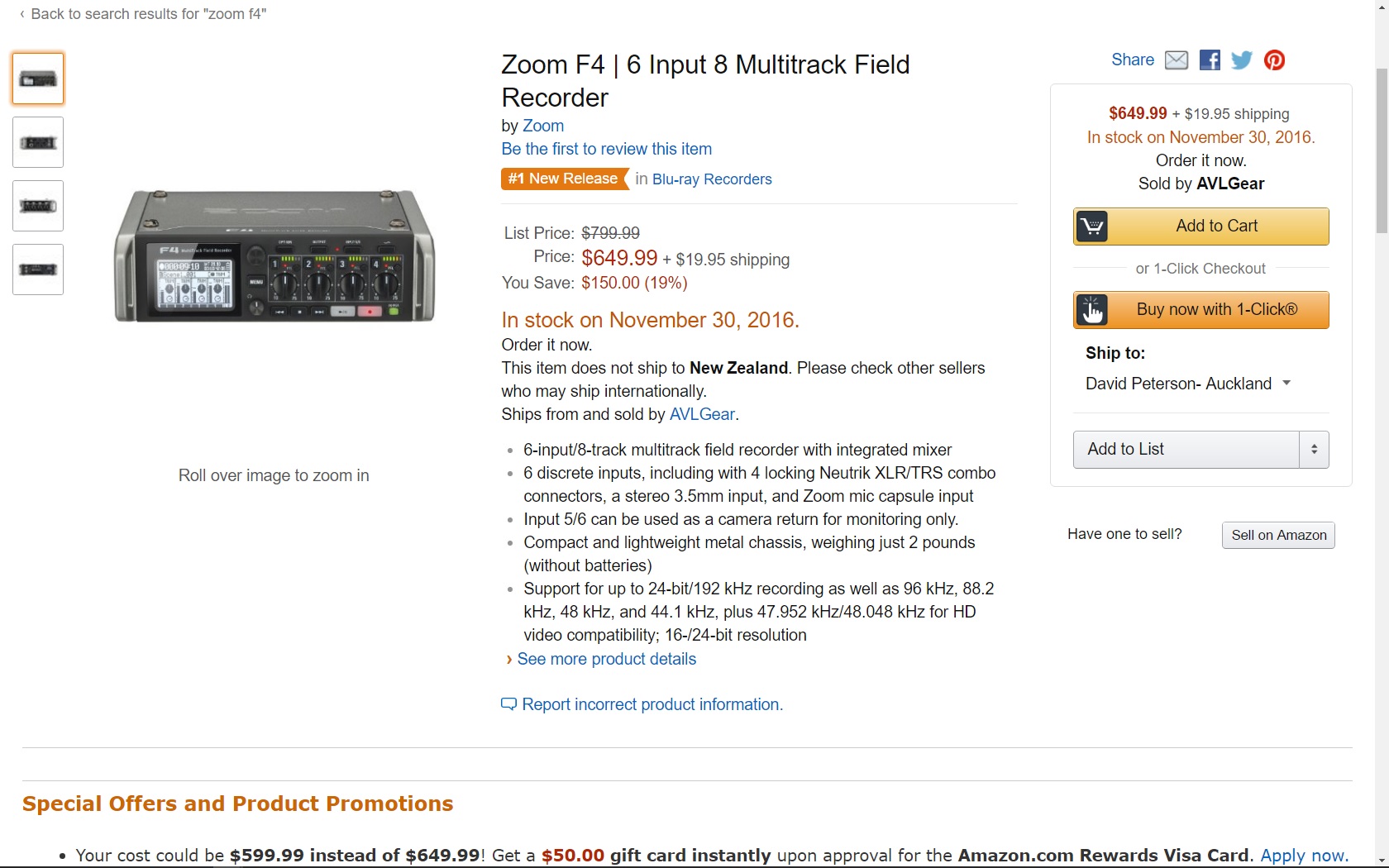

IronFilm Posted September 8, 2016 Author Share Posted September 8, 2016 Little known fun fact: the Zoom F4 can also record to Blu-ray disks as well as SD cards! ;-) As the new Zoom F4 is "#1 New Release in Blu-ray Recorders" on Amazon, that is a new feature we didn't hear about from Zoom... that it can record not just to SD cards but to Blu-rays as well! ;-) ha That isn't even the oddest thing about this Amazon listing, it indicates the RRP is $799 and won't ship until November 30th! :-o Yet Zoom has stated pricing of $650 and shipping in October ( B&H Photo Video Pro Audio has expected availability of October 11th), thus I'm guessing that is two more things Amazon got wrong. https://www.amazon.com/Zoom-F4-Input-Multitrack-Recorder/dp/B01LOR91FC/ Link to comment Share on other sites More sharing options...
