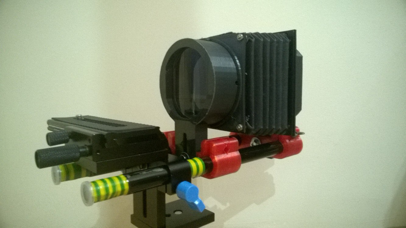

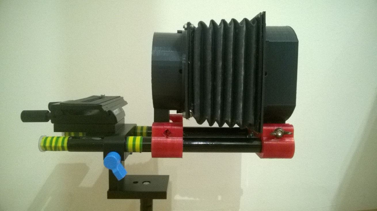

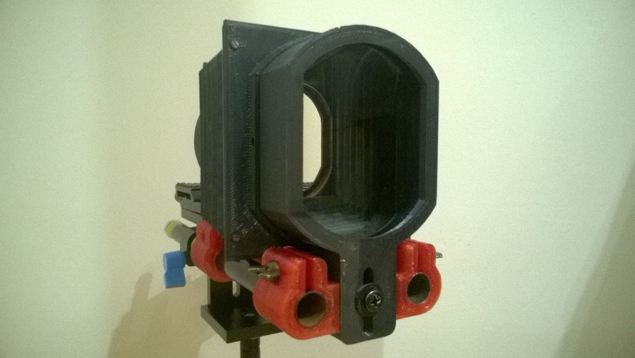

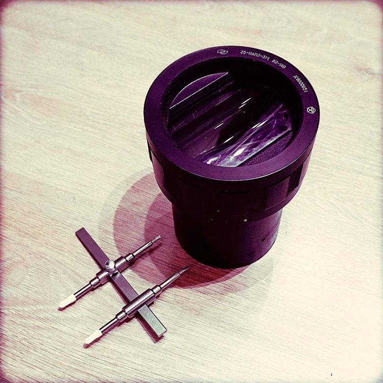

Dr. Verbel' Posted October 3, 2016 Author Share Posted October 3, 2016 Bellows added Link to comment Share on other sites More sharing options...
Dr. Verbel' Posted October 3, 2016 Author Share Posted October 3, 2016 Who want to buy budget anamorphic like on the photo, welcome to message box. Link to comment Share on other sites More sharing options...

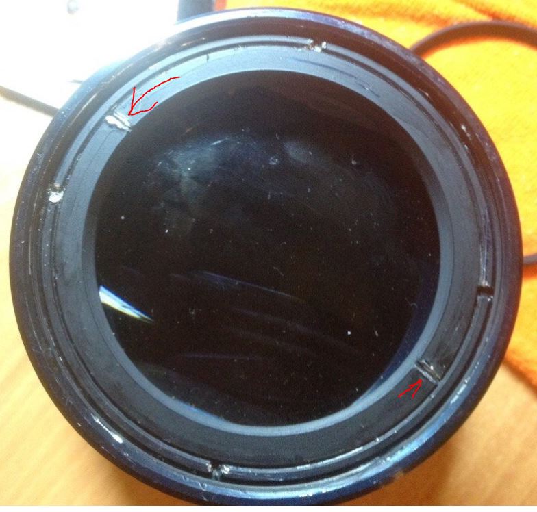

Justin Bacle Posted October 3, 2016 Share Posted October 3, 2016 May sound like a stupid question, but how did you disassemble yours ? Mine is so tight I can't open it :s You start from the back lens right ? Link to comment Share on other sites More sharing options...
Dr. Verbel' Posted October 3, 2016 Author Share Posted October 3, 2016 1 minute ago, Justin Bacle said: May sound like a stupid question, but how did you disassemble yours ? Mine is so tight I can't open it :s You start from the back lens right ? I have lens spanner. not strong for tight nut, but if on slightly choppy to unwind, you can unscrew Link to comment Share on other sites More sharing options...
Justin Bacle Posted October 3, 2016 Share Posted October 3, 2016 1 hour ago, Dr. Verbel' said: I have lens spanner. not strong for tight nut, but if on slightly choppy to unwind, you can unscrew Okay, thanks for the tip. Mine is super tight :s I'll have to find a way to unscrew it. Link to comment Share on other sites More sharing options...

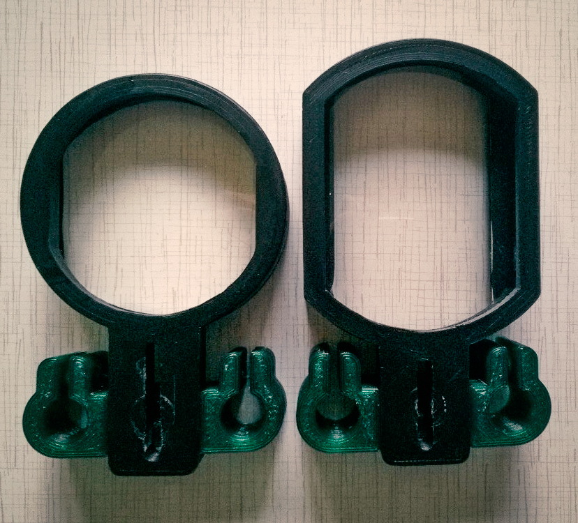

Dr. Verbel' Posted October 6, 2016 Author Share Posted October 6, 2016 Hi! Yes! I think, it will work with any bulky anamorphic projector lenses. You must carefully remove the lens first. if they are not folding rims, and then leave. Make a drawing frames to suit your lens and configuration. Print a 3D-model and everything is ready. Adjustments of lenses in my video with English subs (first configuration, not so easy construction, but ready to work also) at 14:02 12 minutes ago, Juank said: Woaw amazing job !!! keep it going !!! Do you thing it will work with my Moller 63X2 ? Link to comment Share on other sites More sharing options...

Dr. Verbel' Posted October 6, 2016 Author Share Posted October 6, 2016 Juank, bless you! In my case weighed design 1.7 kg / 3.75 lb . Lenses in rims weigh around 1 kg / 2.2 lb. In your case I don't know, but I think, lighter than now. Double focus, but ready for work. 6 minutes ago, Juank said: You 're the Man Dr Verbel' Thanks for your work and kindness!!! Justin Bacle 1 Link to comment Share on other sites More sharing options...
Dr. Verbel' Posted October 6, 2016 Author Share Posted October 6, 2016 Justin Bacle, do you have the same 35nap 2-3m, as on photo? I'm interested, which logo on it (on the left side). Different factories in USSR produce these lenses with same name 35nap 2-3m. Little differences in body construction. Do you saw small hole on the frame's side? small screw lock big nut. Link to comment Share on other sites More sharing options...

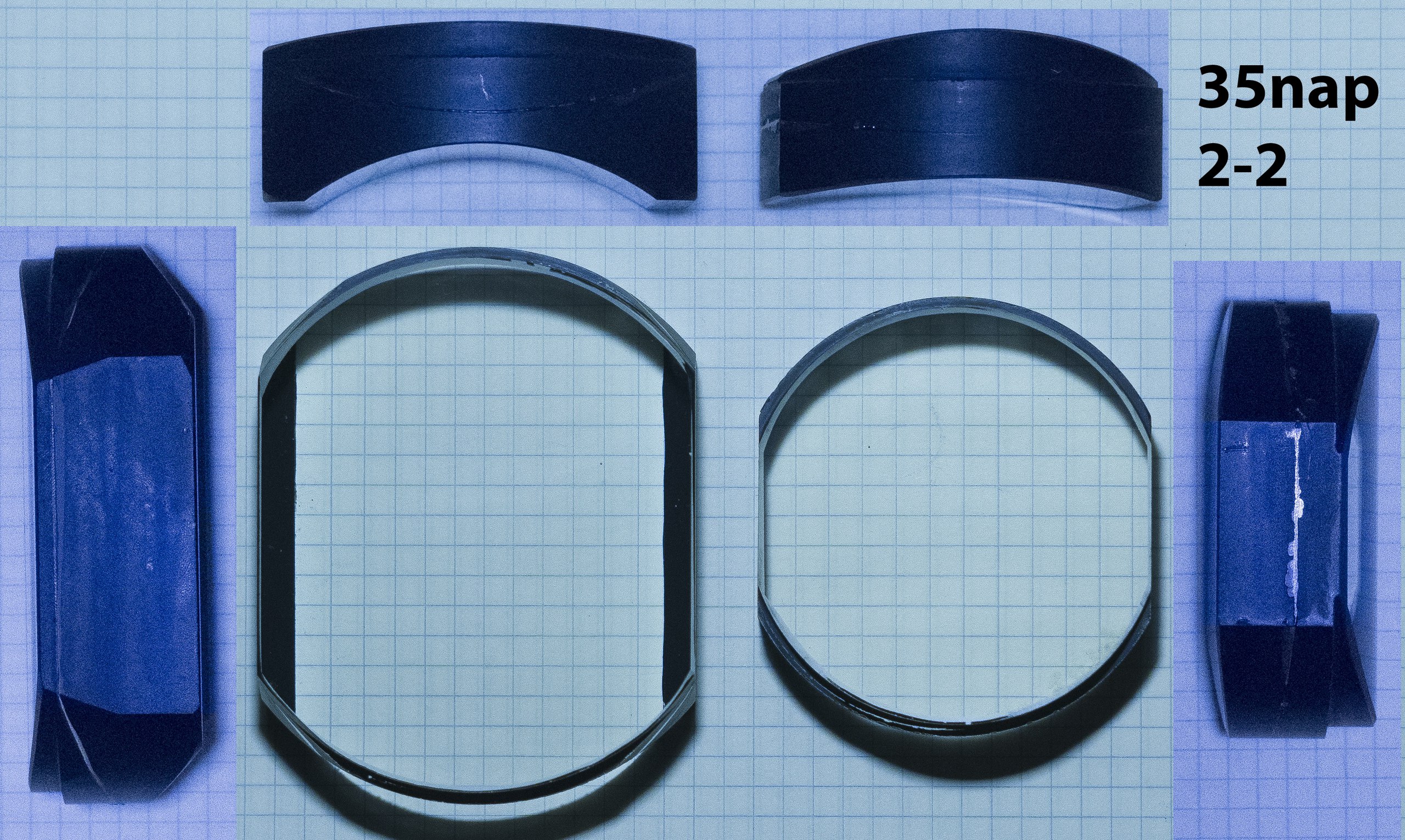

Dr. Verbel' Posted October 6, 2016 Author Share Posted October 6, 2016 Lenses from modifications 35NAP. All my own... yet ken 1 Link to comment Share on other sites More sharing options...
ken Posted October 7, 2016 Share Posted October 7, 2016 10 hours ago, Dr. Verbel' said: Lenses from modifications 35NAP. All my own... yet How much the front lens weight? If less than 350G, I am interested in it. 15 hours ago, Juank said: Woaw amazing job !!! keep it going !!! Do you thing it will work with my Moller 63X2 ? I can tell you this Ana lens's front lens is easy to take apart. But rear lens is tricky, you need to make a special tool to unscrew it. Because it is in too deep. Link to comment Share on other sites More sharing options...

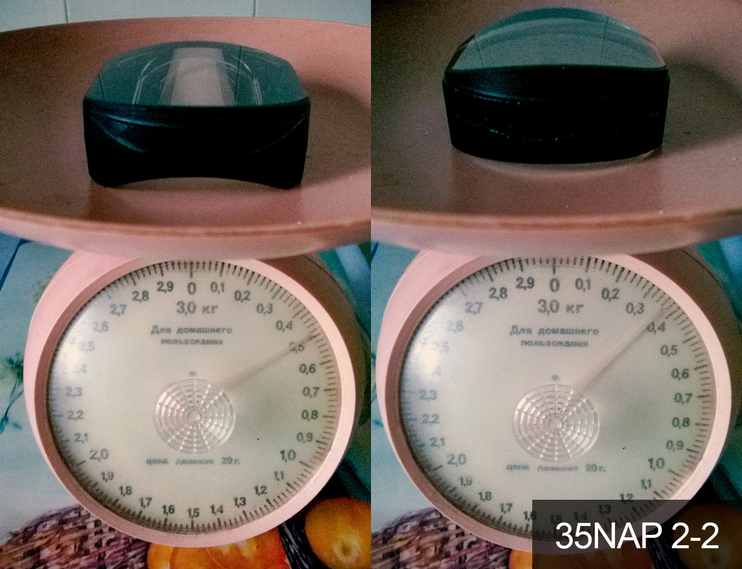

Dr. Verbel' Posted October 7, 2016 Author Share Posted October 7, 2016 35nap 2-2 smaller than 35nap 2-3m. Weight you see... front lens around 500 g, rear 370 g. 35nap 2-3m lenses in sum near 1 kg 4 hours ago, ken said: How much the front lens weight? If less than 350G, I am interested in it. ken 1 Link to comment Share on other sites More sharing options...
Justin Bacle Posted October 7, 2016 Share Posted October 7, 2016 15 hours ago, Dr. Verbel' said: Justin Bacle, do you have the same 35nap 2-3m, as on photo? I'm interested, which logo on it (on the left side). Different factories in USSR produce these lenses with same name 35nap 2-3m. Little differences in body construction. Do you saw small hole on the frame's side? small screw lock big nut. Mine doesn't look exactly the same :s I am quite busy with shooting a music video this week-end but i'll send you photos asap Link to comment Share on other sites More sharing options...
Dr. Verbel' Posted October 7, 2016 Author Share Posted October 7, 2016 7 minutes ago, Justin Bacle said: Mine doesn't look exactly the same :s I am quite busy with shooting a music video this week-end but i'll send you photos asap no problem, I live now on this forum small hole on the side - frame from 35nap 2-4. if you have 35nap 2-3m as I think, fisrt - leave lenses in frames from body. Then leave lenses from frames much easier. Link to comment Share on other sites More sharing options...
Dr. Verbel' Posted October 7, 2016 Author Share Posted October 7, 2016 If I'm not mistaken, you have 35nap 2-3, LOMO version. Construction of body must be similar to 35nap 2-4 (also LOMO version). Must be small hole on the frame's side, in which small screw lock big nut. One man also have this version and send to me several photos. Right version? 5 hours ago, Justin Bacle said: Mine doesn't look exactly the same :s I am quite busy with shooting a music video this week-end but i'll send you photos asap may try internal nut. later man tell me exactly. Link to comment Share on other sites More sharing options...
ken Posted October 7, 2016 Share Posted October 7, 2016 8 hours ago, Dr. Verbel' said: 35nap 2-2 smaller than 35nap 2-3m. Weight you see... front lens around 500 g, rear 370 g. 35nap 2-3m lenses in sum near 1 kg Hehe, too heavy to me. I remembered the front glass of Moller 63/2x is around 0.47kg. So I think the 46/2x or 48/2x lens are the best size for me. The front glass is around 0.3kg range. But the 32 lens is too small. BTW, who knows what this number mean? But I guess it maybe the rear glass size in mm, looks very close. Dr. Verbel' 1 Link to comment Share on other sites More sharing options...
