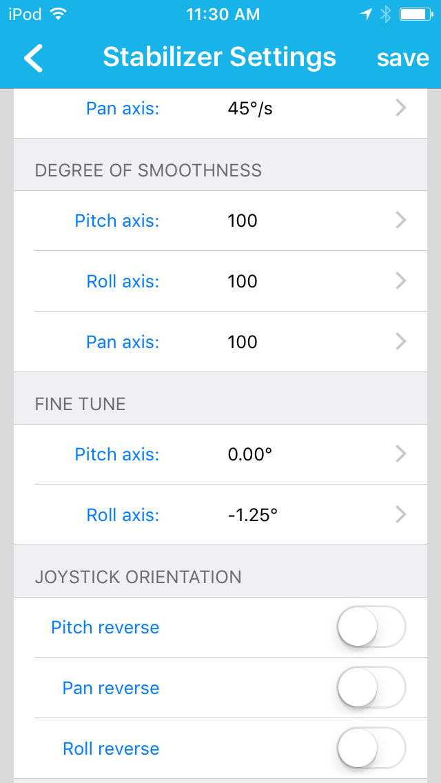

jonpais Posted September 25, 2016 Share Posted September 25, 2016 Yes, nice job, I prefer tests under a variety of conditions and with different subject matter, so, well-done. I've been using my Crane every day now for a couple months, and I still haven't mastered the 'ninja' walk, so my footage is still a little bouncy, Also, I have a bad habit of swinging the gimbal a little, for example, when walking on the sidewalk and aiming the camera at people sitting in the park. I wish there was someone here (in Vietnam) who could show me the proper handling. I've also noticed that, even after calibrating the Crane, the camera is sometimes a fraction off of level, but ever so slightly. Finally, the roll axis has a habit of coming unbalanced and I have to rebalance the camera from time to time. I think the spring that holds the arm in place when tightening the screw has loosened or something, but I'm not sure. Anyhow, I'm still quite happy with it, I just have to learn how to move with it. Link to comment Share on other sites More sharing options...

jonpais Posted September 25, 2016 Share Posted September 25, 2016 11 hours ago, mojo43 said: Other than that, I would say that if you are having trouble balancing with the gimbal. It's about 20 times more difficult to balance with a steadicam in my opinion if not more. Throw in some wind and it becomes exponentially difficult with a steadicam. There is a shot in my test of a man's back shooting towards the city. That was in very strong wind and the stabilizer barely budged. Can I see the footage? Are you saying the panning is bouncy? Because if so, set the panning to lower in the menu system and it should help... The bounciness is from my walking. Because I mostly wear sandals here in VN, I think it makes it even more challenging to walk smoothly. To make matters worse, most of the sidewalks here are in bad disrepair/ I've tried shooting indoors without shoes and it's an improvement. I may begin editing the footage soon, and I'll upload some. Probably the worst you've ever seen, but all operator error I'm sure. Edit: I wrote Zhiyun Tech today about the camera not being level and the roll axis continually needing adjustment. I expect to hear back from them this afternoon. Maybe there's a simple fix. Link to comment Share on other sites More sharing options...
jonpais Posted September 26, 2016 Share Posted September 26, 2016 Rose over at Zhiyun responded to my email right away. She said to fine tune the roll axis, which I did using the Zhiyun Assistant app on my iPod. Now, the camera is level. It took just minutes to calibrate. The only thing left to figure out is why the roll arm seems to move or something, I have a feeling there is not enough tension when I tighten the screw. Rose asked me to send a video of the problem. So far, very happy with customer service there. Link to comment Share on other sites More sharing options...
