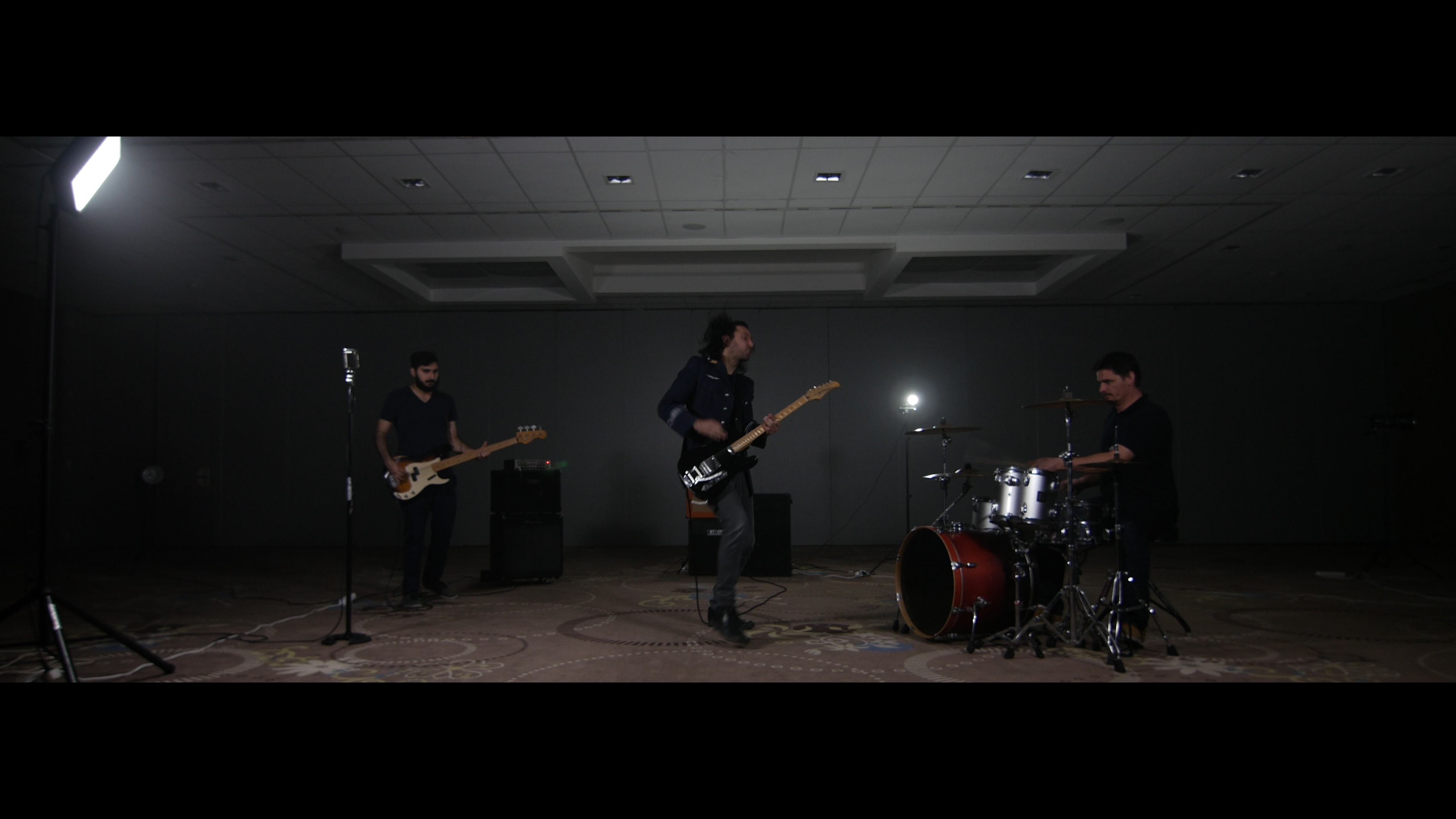

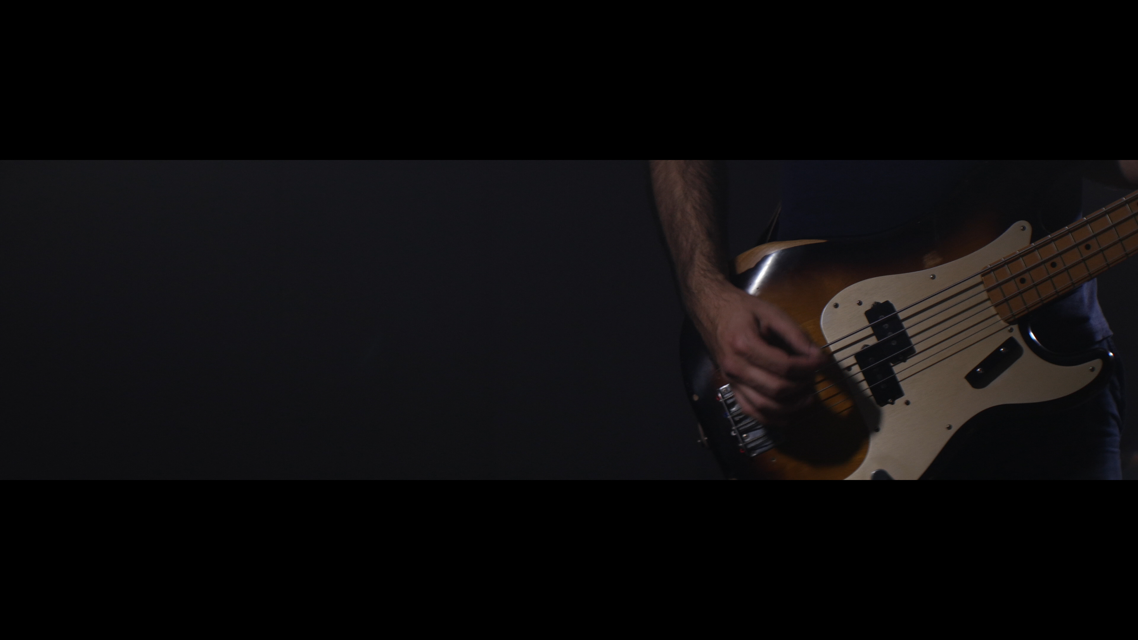

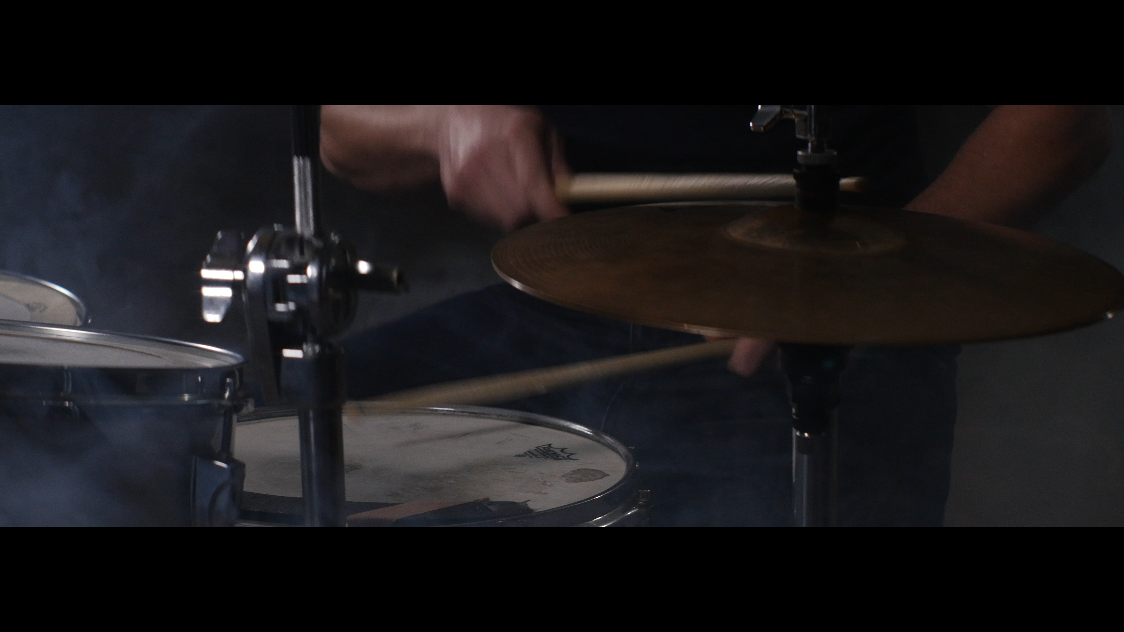

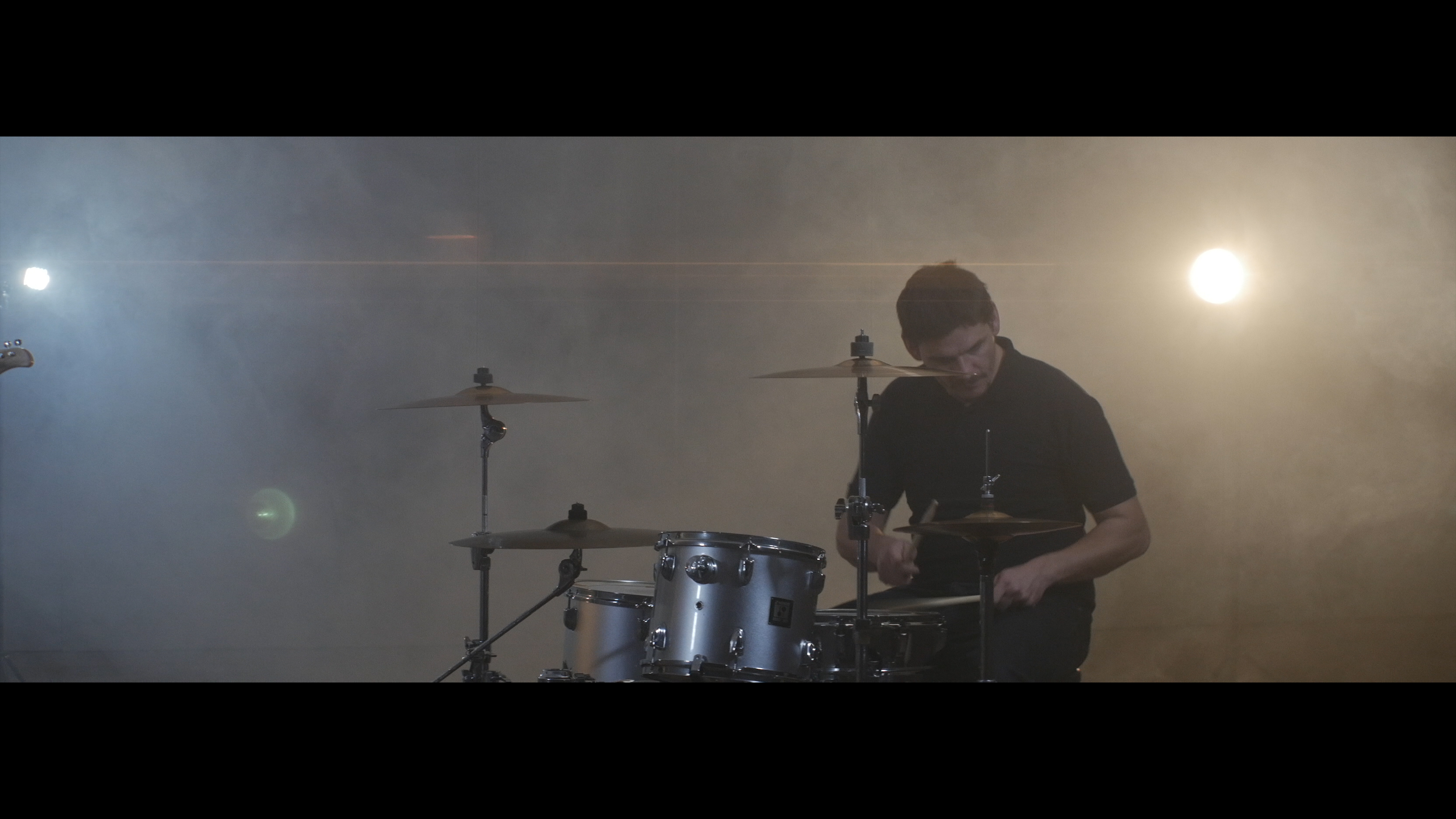

funkyou86 Posted November 17, 2016 Author Share Posted November 17, 2016 So, I have finished the building of my two LED panels. And they work pretty good! I have used 6000K leds, and each got a luminance of 4000 lumen. Here are some screengrabs from the music video I shot few weeks ago (not graded, only the scr1.jpg). All shots by GH4, the first one with tokina 11-16, the rest with Pentax 50mm SMC + Sankor Cinemascope Anamorphic, ISO around 400. Dr. Verbel' 1 Link to comment Share on other sites More sharing options...
