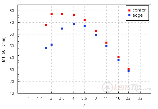

jonpais Posted October 15, 2016 Share Posted October 15, 2016 6 minutes ago, estarkey7 said: The 20mm f/1.7 is waaaaay sharper than the sharp 42.5 f/1.7. Not according to the test charts over at LensTip, it isn't. Link to comment Share on other sites More sharing options...
estarkey7 Posted October 15, 2016 Share Posted October 15, 2016 3 minutes ago, jonpais said: Not according to the test charts over at LensTip, it isn't. Maybe because I have the 20mm f/1.7 II? Link to comment Share on other sites More sharing options...
jonpais Posted October 15, 2016 Share Posted October 15, 2016 42 minutes ago, estarkey7 said: Maybe because I have the 20mm f/1.7 II? Could be... My bad... And it's only $268.00... Link to comment Share on other sites More sharing options...
