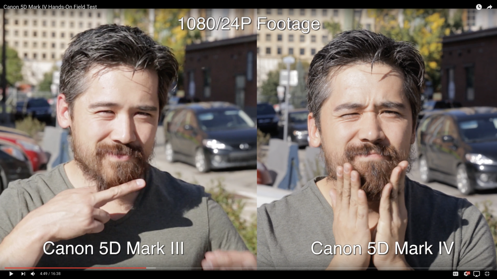

there is a youtube review somewhere that shows the 1080p vs the mkiii. the mk IV is a good deal sharper than the mkiii. Not Sony sharp by any means, but noticeable. I'm curious how it compares to the 1DXII 1080p FF.
found it, about 4:50 on this video - Its a bit sharper.
looks only a tiny bit sharper.. personally can't stand how soft 5DIII 1080p is anymore.. fortunately shooting RAW changes all that. but i would certainly not get a 5D4 / 1DX II for good 1080p IQ and their MJPEG cropped 4K is so cumbersome. Really if you wanna stick with Canon, either 5D3 Raw or C line for best 1080p IQ.. or go Sony with Metabones EF to E-mount adapter..
