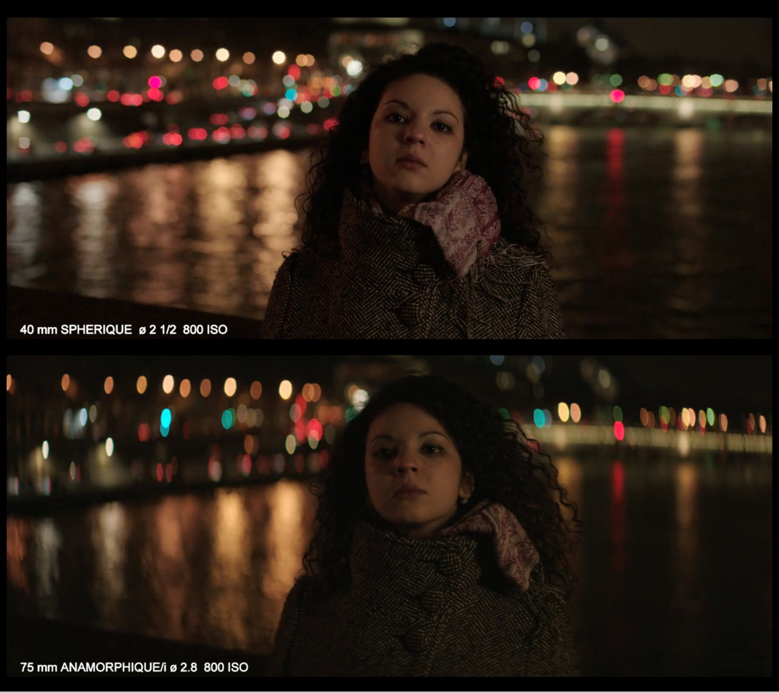

Jay Martin Posted November 2, 2016 Share Posted November 2, 2016 I couldn't really find a single answer online about this. I'm trying to find out if there would be a noticeable difference in quality in using a good anamorphic lens on a DSLR over just shooting 16:9 and cropping the image in post. Some people said that because a lot of anamorphic lenses aren't that sharp, the sharpness will ultimately be the same or worse, but I have not come across any comparisons. I was wondering if anyone has done any side by side comparisons of sharpness between an aspherical lens (cropped, less resolution, like 1920 x 800) and an anamorphic lens (stretched out, like from 1920x1080 to 2560x1080) and which one they found to be higher quality. Thanks! Link to comment Share on other sites More sharing options...

SigurdW Posted November 3, 2016 Share Posted November 3, 2016 If sharpness is what you are after, you are better of shooting spherical. However, some scopes are indeed sharper than others. The Cinelux and Isco Wide-screen 2000 are commonly considered to be sharp scopes, but imo pretty 'sterile'. I did a quick lens test for a short I am shooting: Grimor and Justin Bacle 2 Link to comment Share on other sites More sharing options...
