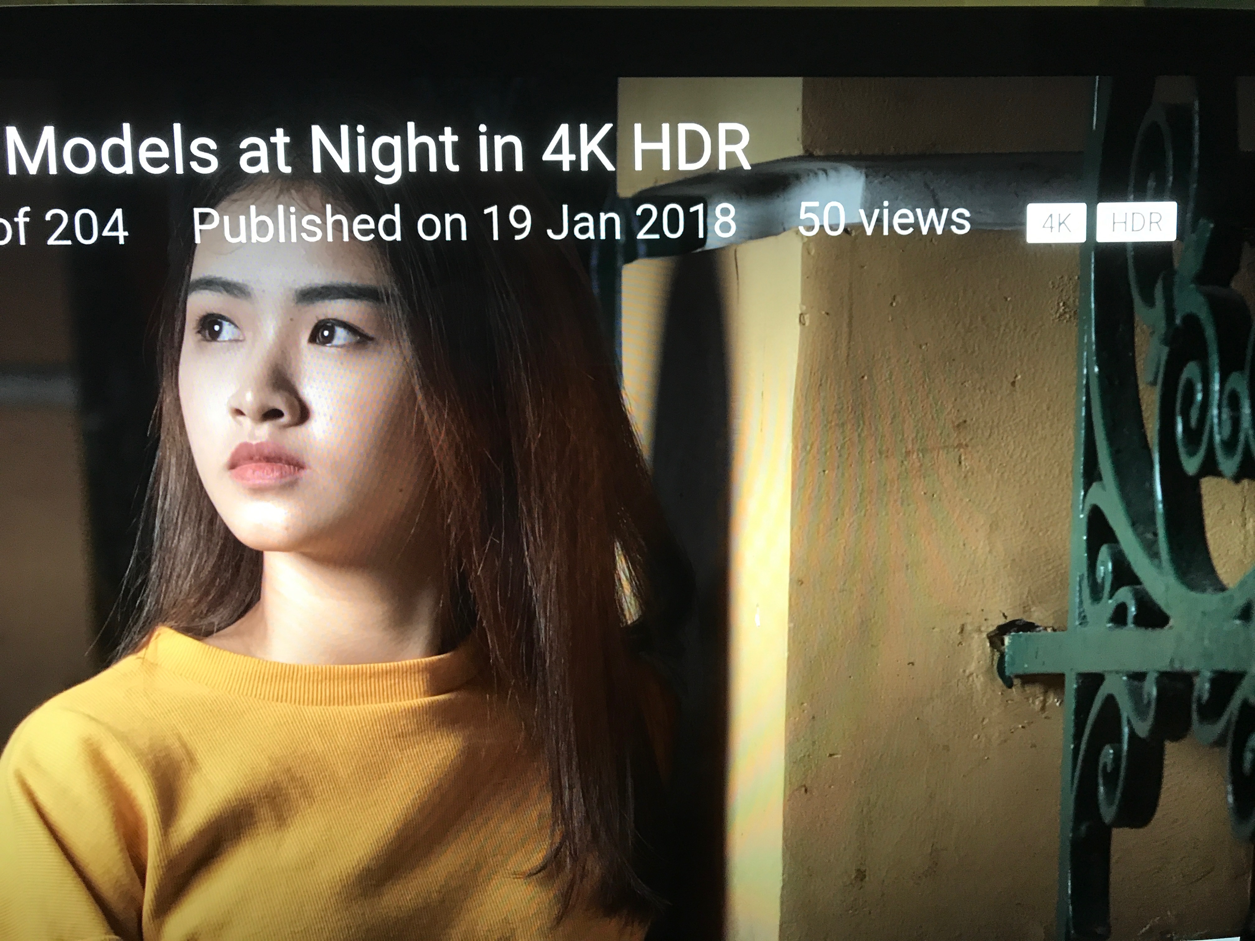

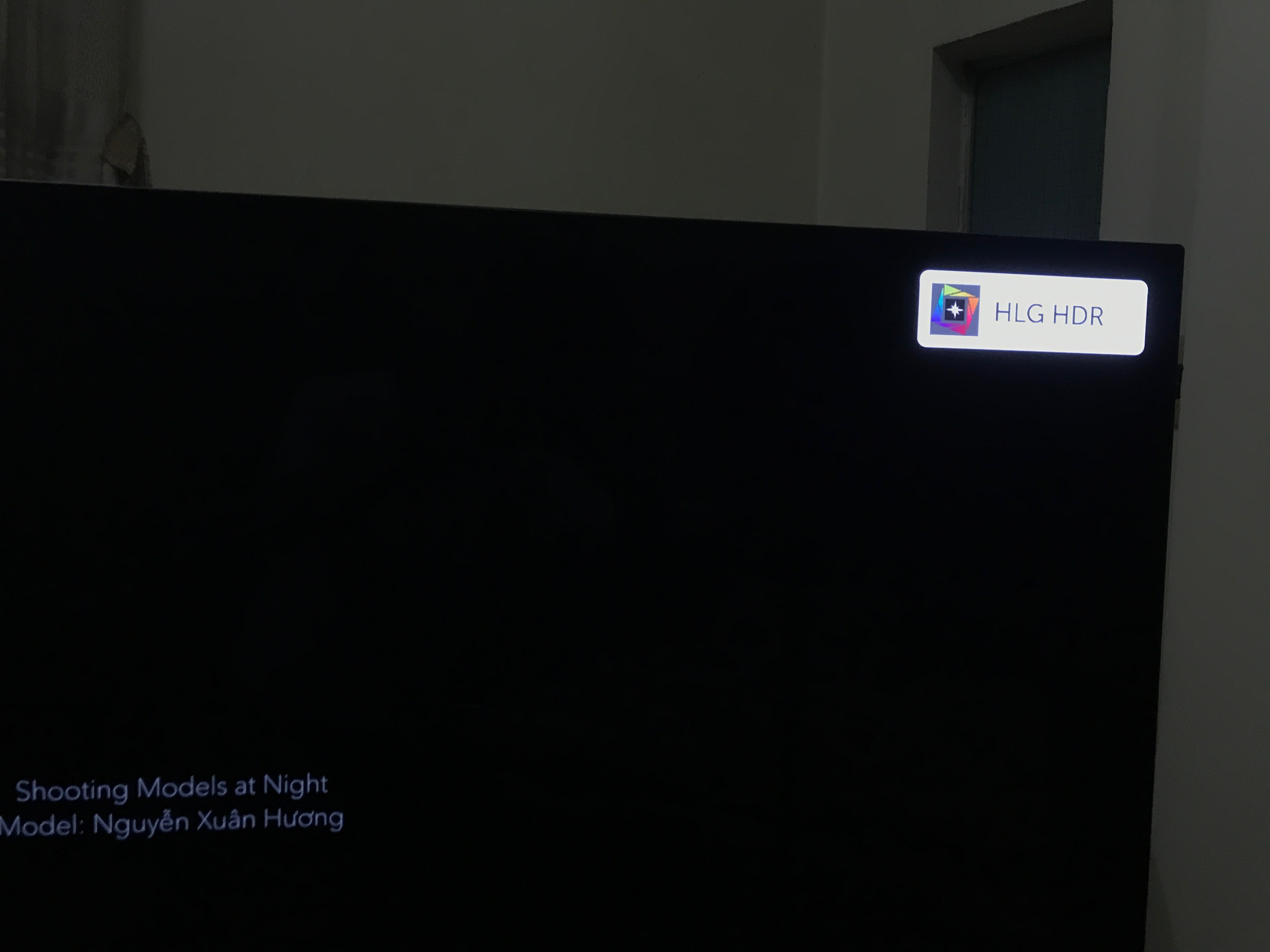

Eureka! I just uploaded my very first HDR video to YouTube. It's actually my 'Shooting Models at Night' clip, but in rec.2020. No color correction. No HDR monitor required. No expensive equipment or i/o stuff. Easy as pie! Of course, if you want to grade your work, you'll probably want to shoot V-Log and get an HDR monitor, but if you expose and white balance carefully, you can edit HLG and deliver to YT no problem. The video should be watched on an HDR capable television or smart phone. Colors aren't perfect by any means, but I'm still pretty excited.

Hi Jon.  I watched your video with my HDR-ready LG television by using the internal Youtube app that typically shows HDR content. I also watched the video by using the previous generation AppleTV (non HDR). I was not able to see difference in these videos. Maybe the metadata doesn’t trigger the HDR.
The HLG HDR flag appears in the upper right corner of my LG C7. I tested it numerous times.

@jonpais I have LG 49UH610V, and its Youtube app does not show HDR flag for any content (but other apps like Netflix and iPlayer do show HDR flags). I am not seeing in my TV similar DR  (?) as the above screenshot indicates.
Your television is not HDR, sorry to say. HDR Pro and HDR Effect are not true HDR. Your TV doesn't support HLG, HDR10 or Dolby Vision.
