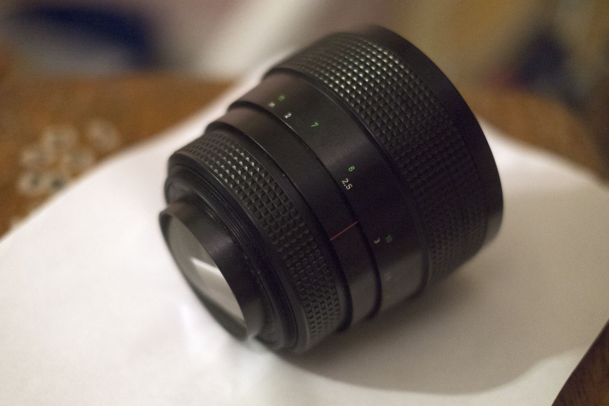

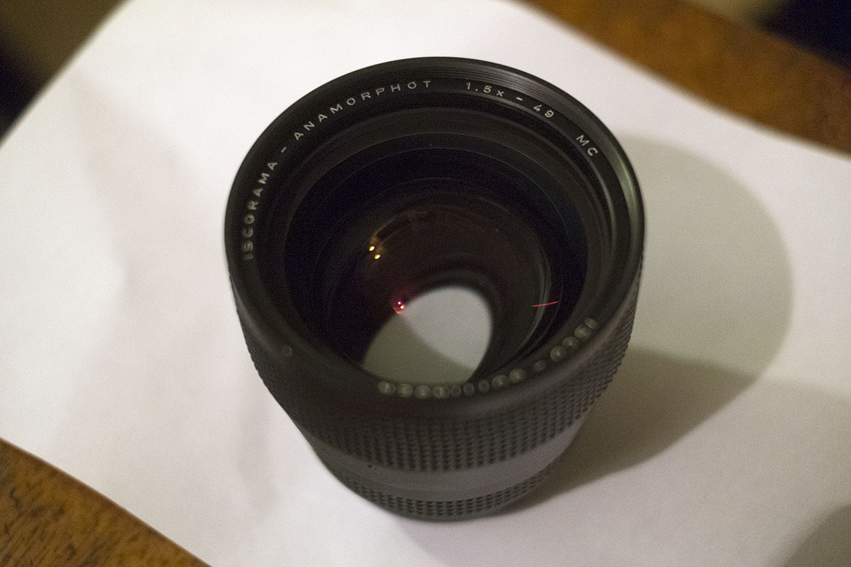

Barney909 Posted November 13, 2016 Share Posted November 13, 2016 Hi all, Has anyone come across one of these before, I can't seem to find out anything about this lens? Front markings are ISCO-GÖTTINGEN ISCORAMA - ANAMORPHOT 1.5x - 49 MC. It has the the same front and rear element diameters as a 54. However this one has a 72mm rear mounting thread, and instead of buttons, has the same alignment mechanism as the 42. I haven't been able to test it yet, thinking of hacking together a UV filter mount. In the meantime does anyone have any more info on this lens? Any help would be most appreciated. Thank you! Liszon and PepperJay 2 Link to comment Share on other sites More sharing options...

SigurdW Posted November 16, 2016 Share Posted November 16, 2016 That looks very similar to the Iscorama 42: 49 probably stands for the size of the rear element. I guess its really sharp and veeeeery rare and expensive. Link to comment Share on other sites More sharing options...

raf702 Posted November 16, 2016 Share Posted November 16, 2016 7 hours ago, SigurdW said: That looks very similar to the Iscorama 42: 49 probably stands for the size of the rear element. I guess its really sharp and veeeeery rare and expensive. It's most likely the Isco-42, and one of the sharpest Isco lens between the 36 and 54. But has far less prominent lens flaring. SigurdW 1 Link to comment Share on other sites More sharing options...
Bioskop.Inc Posted November 16, 2016 Share Posted November 16, 2016 Andrew has a weird/rare single focus x2 Isco Anamorphic, so Isco did make a few made to measure lenses it would seem. So is this a 54 housed in a smaller body? But the 49 name would suggest that the rear element is 49mm & not 54. Whatever you've got, it is rare & if it is as sharp as the 42, the OP has got a very nice lens indeed - none of this plastic 36 housing shit, that makes you too scared to take it outside. Flares be damned, it's the out of focus qualities that are the important thing. SigurdW and valery akos 2 Link to comment Share on other sites More sharing options...
brera100 Posted November 18, 2016 Share Posted November 18, 2016 ISCO only manufactured a couple of examples of this lens. And they were never released commercially. It has a 49mm rear element diameter and a 95mm front filter thread. Which does beg the question as to why it was produced in the first place, given that the size and weight are pretty much identical to the Iscorama 54, and its successors, the ISCO 16:9 Video Attachment (1.33x) and the ISCO 16:9 Video Attachment I (1.42x). I've got a little stash of rare ISCO stuff, including one of the prototypes for the original 1967 Iscorama (all metal construction and a 67mm filter thread). So if you are ever interested in parting with your special find, I'd certainly make you an offer. And treat your lens carefully, because it's a little bit of German optical history... Timotheus, Tito Ferradans, valery akos and 1 other 4 Link to comment Share on other sites More sharing options...

Barney909 Posted November 20, 2016 Author Share Posted November 20, 2016 Wow. Thanks everyone, really great response. Especially brera100 for the background info. I've ordered some cheap 72mm filters to hack together a mount and will be testing shortly, will keep you updated Link to comment Share on other sites More sharing options...
