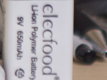

Michael Ma Posted November 28, 2016 Share Posted November 28, 2016 My wife accidentally knocked my camera with the Pan/Leica 42.5 f/1.2 Nocticron attached from about 100cm (3.5ft) to the floor. It was carpet so there was no signs of physical damage. I originally thought the camera and lens were OK. However, I'm starting to see that the center is not "tack sharp" at f/1.2. Actually, quite the opposite. It is still tack sharp at f/1.8, but as for right now, this lens behaves like a $400 lens, not a $1400 one. Because this lens is fairly new, and I never got a chance to test it at f/1.2 at any controlled settings, I'm not sure if I'm overreacting, or if it certainly requires servicing. I'm wondering if any owners could chime in? Here is 100% crop from the center of the lens, touch focused in a small box at about 1/250s with stabilization enabled (same results with stabilization disabled). This is the sharpest I can get anything in focus at the center at 1.2 on my GH3 or GX85 at the center. But when I stop down to 1.8, it's very sharp. Any comments would be appreciated. Link to comment Share on other sites More sharing options...
jonpais Posted November 28, 2016 Share Posted November 28, 2016 Very sorry to here that, Michael. I can assure you, this is not normal. I wouldn't describe the Nocticron as tack sharp wide open, though it gets spectacular results when stopped down to F/2.8. I don't shoot stills, but if you check out my video, most of the shots of the woman getting her hair done were shot at or around f/1.2. There is also a video shot wide open on YouTube of military exercises in Poland, but I don't know if sharpening was added in post. You can also check out LensTip's sample images at f/1.2 for comparison. Link to comment Share on other sites More sharing options...
Michael Ma Posted November 28, 2016 Author Share Posted November 28, 2016 40 minutes ago, jonpais said: Very sorry to here that, Michael. I can assure you, this is not normal. I wouldn't describe the Nocticron as tack sharp wide open, though it gets spectacular results when stopped down to F/2.8. I don't shoot stills, but if you check out my video, most of the shots of the woman getting her hair done were shot at or around f/1.2. There is also a video shot wide open on YouTube of military exercises in Poland, but I don't know if sharpening was added in post. You can also check out LensTip's sample images at f/1.2 for comparison. Thanks for the reassurance Jon! I will take my lens to Panasonic asap and see if I can get it serviced under warranty. The more I think of it, I don't think Panasonic would be selling too many of these at this price with that kind of performance. Link to comment Share on other sites More sharing options...

Michael Ma Posted March 18, 2017 Author Share Posted March 18, 2017 Just an update. I finally got my Pan Leica 85mm 1.2 Nocticron back from Panasonic. It was a long process (took approximately 10 weeks). Initially, they did tests and thought nothing was wrong with the lens and on my second visit, I had to show them the difference with a floor model and how all the edges were excellent except the very center which looked fuzzy at 1.2 although it cleared up very quickly when stopped down to 1.8. Before. 100% crop at the center at f/1.2: Now, 100% crop at the center at f/1.2 Definitely very happy with the replacement lens. Maybe even slightly sharper than their floor model. Link to comment Share on other sites More sharing options...

Administrators Andrew Reid Posted March 18, 2017 Administrators Share Posted March 18, 2017 Wow that is sharp for F1.2, the replacement What focus distance was the panasonic logo shot at? Link to comment Share on other sites More sharing options...
jonpais Posted March 19, 2017 Share Posted March 19, 2017 26 minutes ago, Andrew Reid said: Wow that is sharp for F1.2, the replacement What focus distance was the panasonic logo shot at? I think I'll replace mine for their ultra sharp version too! ? Link to comment Share on other sites More sharing options...
Michael Ma Posted March 19, 2017 Author Share Posted March 19, 2017 47 minutes ago, Andrew Reid said: Wow that is sharp for F1.2, the replacement What focus distance was the panasonic logo shot at? I'm going to roughly guess about 7 meters. I've attached the raw file if you're interested.P1410745.RW2 As a side note, I exported to jpg with Adobe Camera RAW, which adds 25 sharpening by default. But the blurry image was processed the same way. Link to comment Share on other sites More sharing options...
