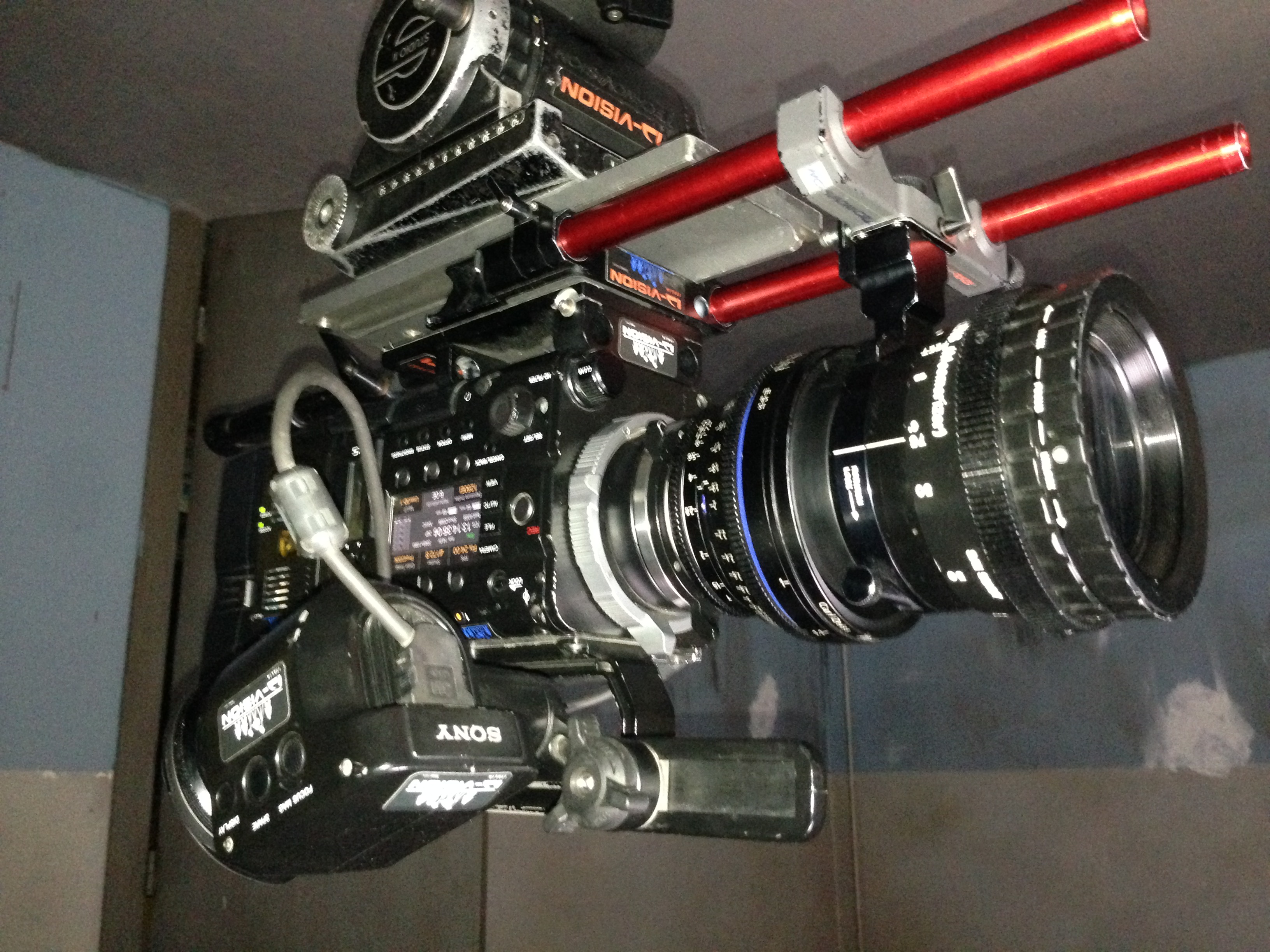

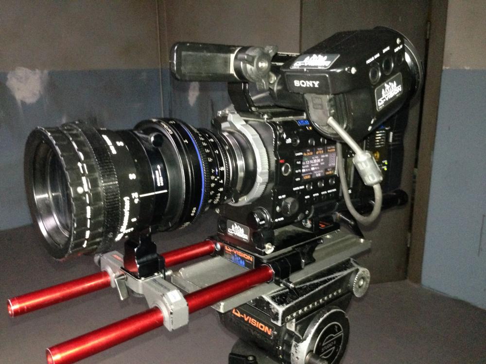

Hi folks, recently I was filming in Italy and we filmed everything with an F55 with CP2 lenses and this godsend anamorphic adapter that really blew me away. The sheer size of it, unbelievable! :)
I only found a brief mention of it on the forum, but on cinematography.com I was able to retireve a bit more information. Anyway, for this shoot I intended to use my Kowa B&H, as I really pressed to shoot part of the short in anamorphic, but as you can imagine, without machining out a proper adapter for the CP2 lenses this was a no go.

and minimum focus distance is not that bad: 1.7m I found it it's more than enough to get close ups with an 85mm taking lens (That's what we used most of the time 50mm or 85mm plus the mesmerizer
My experience working with the mesmerizer and the CP2 made double focusing very easy. we shot all the footage between T2.8 and T4.
Every time we moved the camera or we needed to adjust focus I could easily focus the taking lens onto my subject and then refine the focusing with the mesmerizer.
We didn't need to rack focus for the type of filming we were doing, but I figure that a skilled focus puller could manage to pull focus on both the mesmerizer and the taking lens.
A quirk of this optics is that the focus throw is actually an incredible 390 degree circa. you can focus beyond the closest focus mark set at 6 feet, but then the scale restart from infinity so it could trick you into thinking the adapter is set at infinity - 50 feet while for real it is set at the closest focusing point.

Though, for ease of use, I have to say that the mesmerizer it's simply great. I can imagine you could rehouse any anamorphic and adapt the body to mimc the functioning of the mesmerizer, or pair your favorite anamorphic lens with a Rapido clamp technology so to ease the correct alignment, still I don't think they could guarantee the degree of accuracy you get with having the allign sign on the body of the lens itsels. Togheter with a lens support :)
