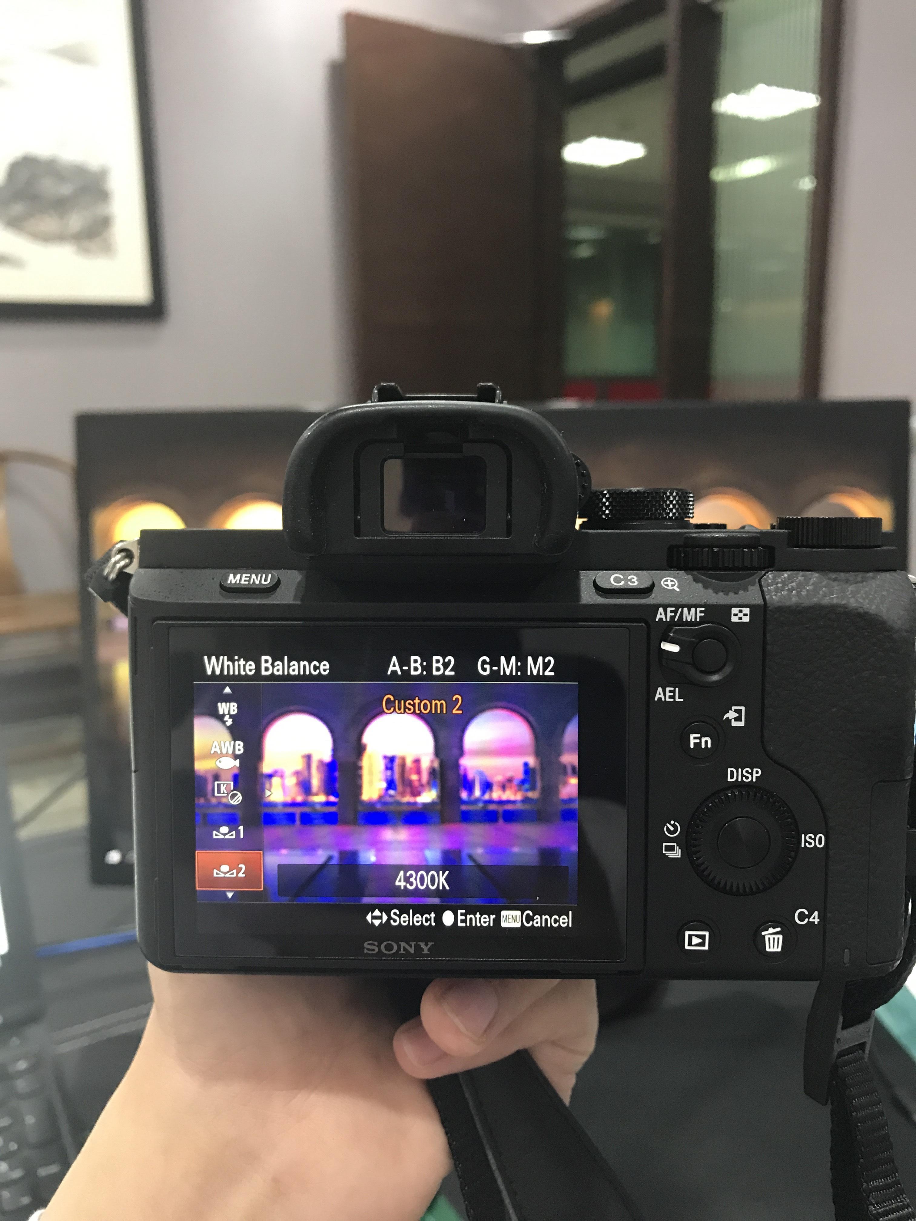

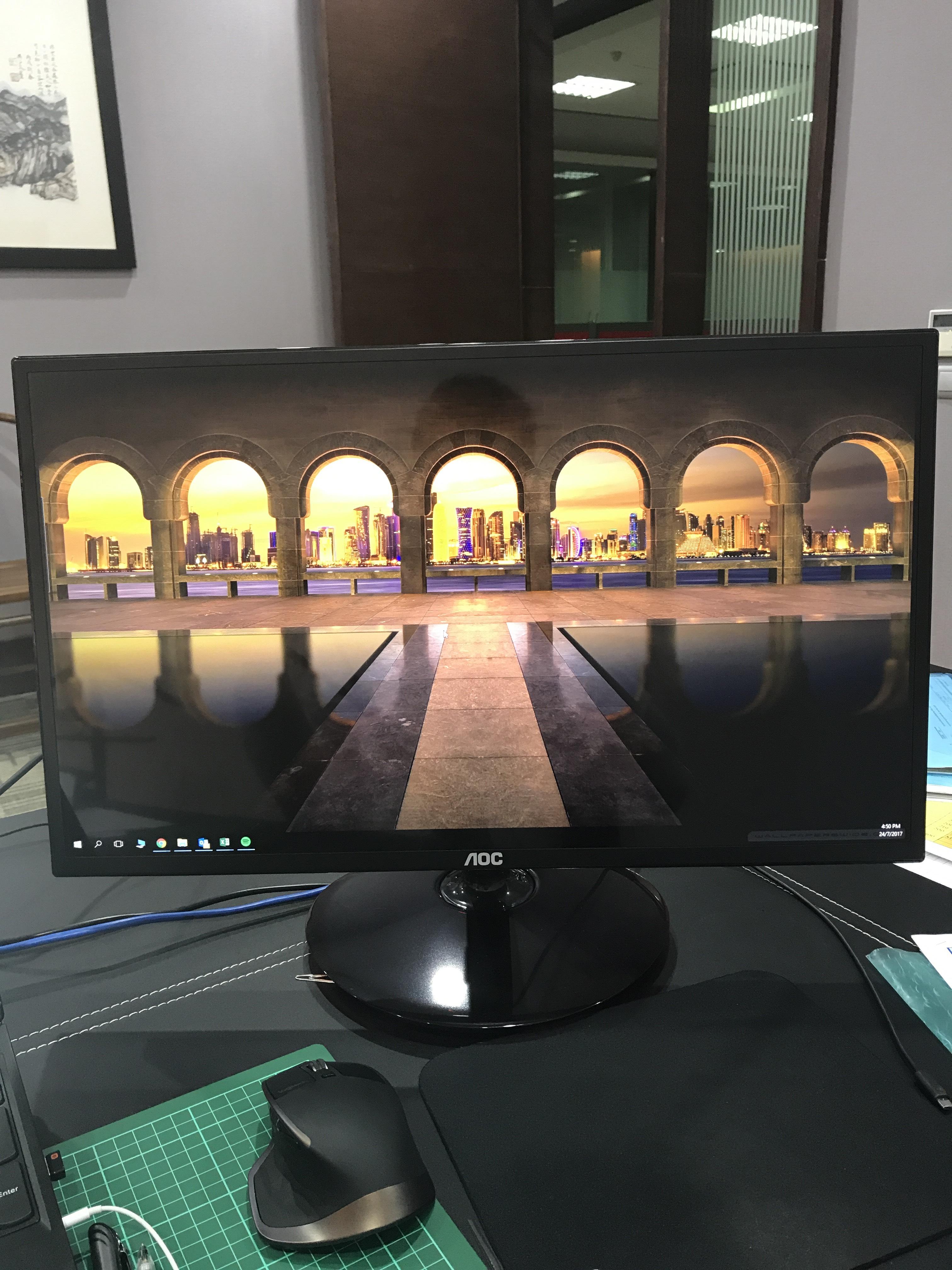

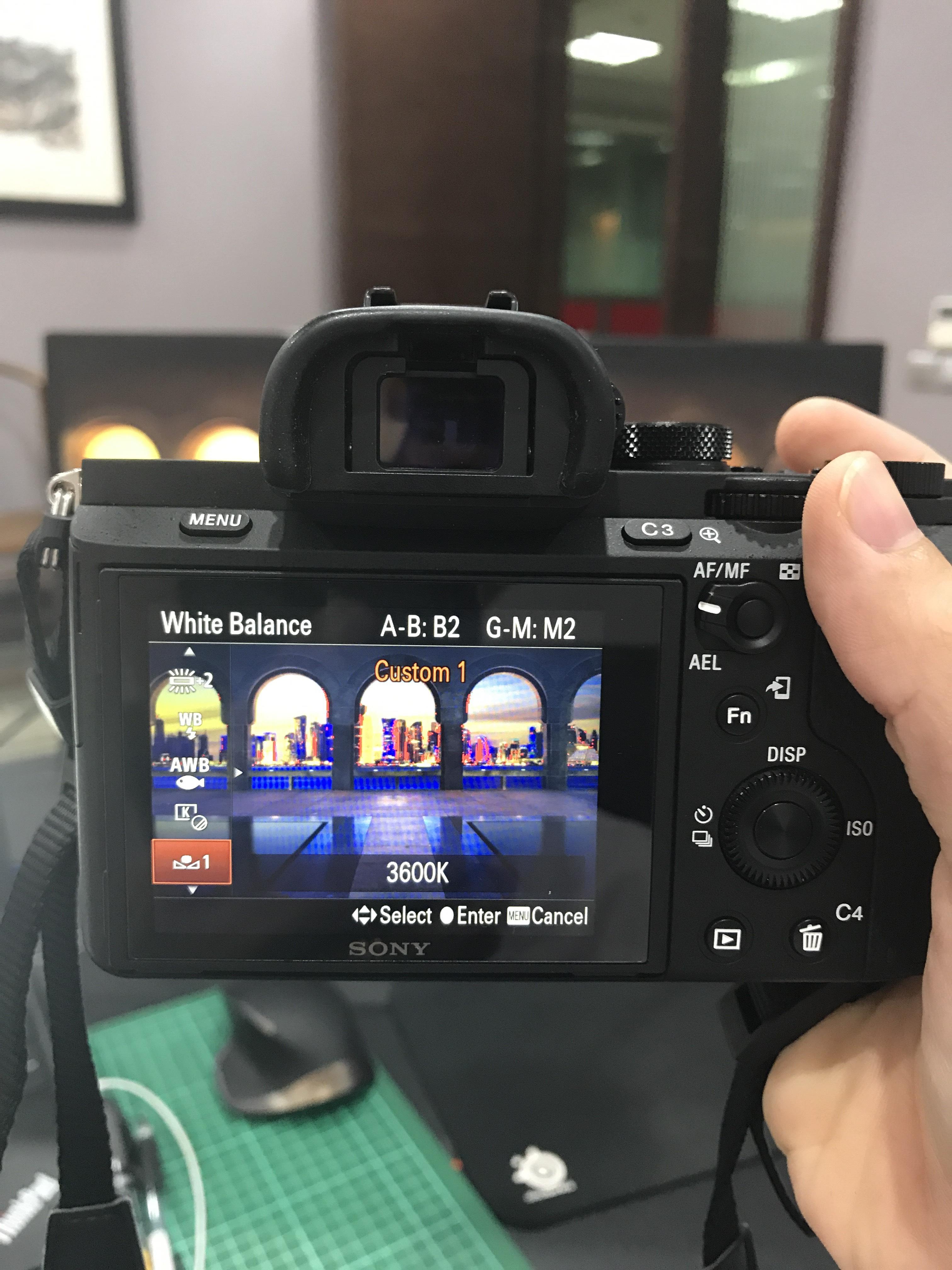

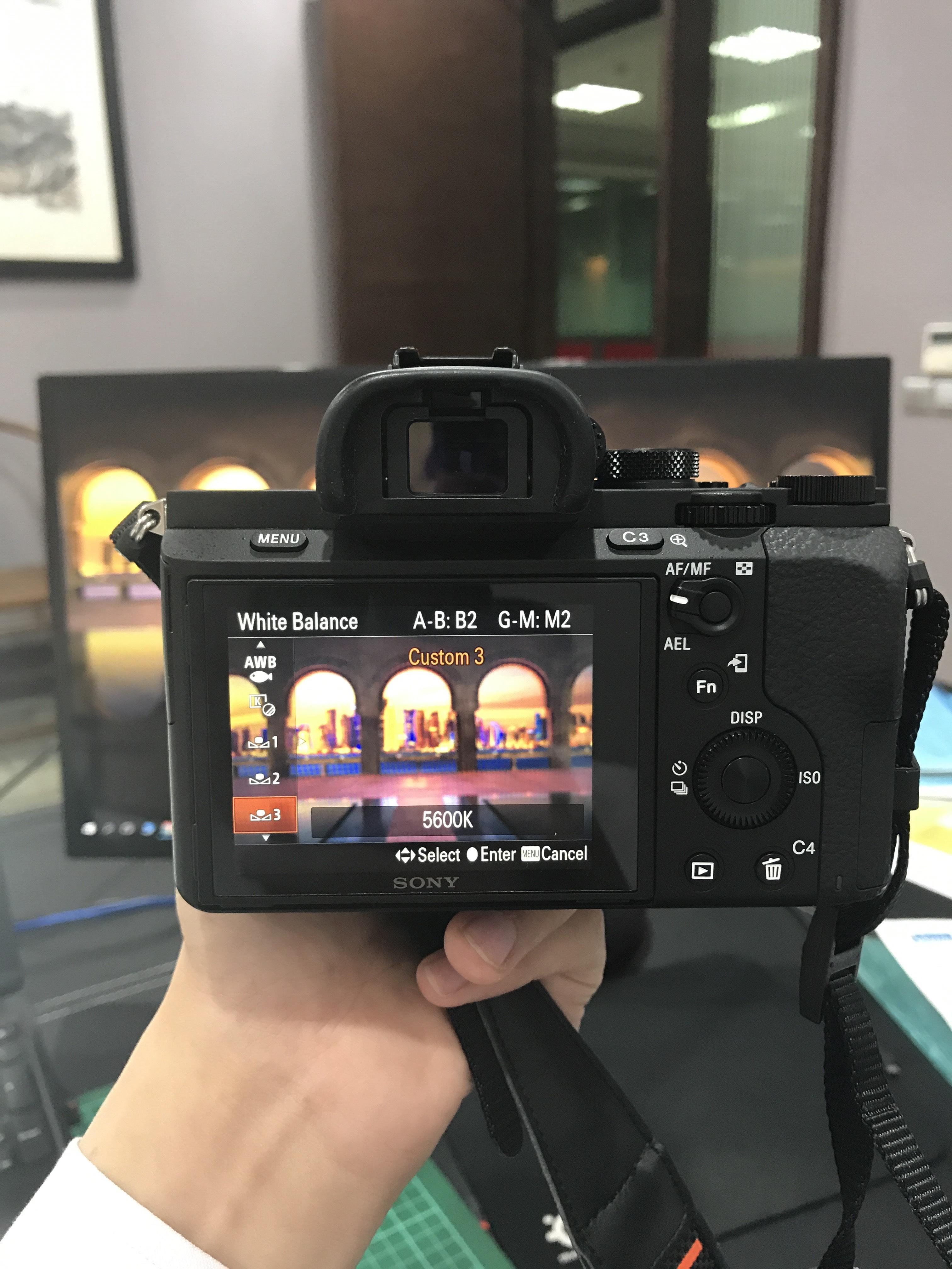

Adrian Lim Posted July 24, 2017 Share Posted July 24, 2017 Hi guys! Just pulled the trigger to set my colors straight and I seem to have run into abit of a confused path here. I followed the settings as per the pdf stated. However, my white balances 1 (3600K) and 2 (4300K) seems to be more BLUE than anything else. As you can see, the color rendition is clearly on the blueish side. Any pointers? Thank you Gregormannschaft 1 Link to comment Share on other sites More sharing options...
Administrators Andrew Reid Posted July 24, 2017 Administrators Share Posted July 24, 2017 The monitor you are pointing the camera at cannot be used to set the white balance, because it sends out a bunch of blue wavelength LED light from the backlight. You need to set the white balance off real subjects. Use various situations like direct sunlight, cloudy weather, shade and indoor light at various positions in a room to get the desired white balances. Or just use the Kelvin preset and dial in the K you need for a particular scene. If you prefer, just use AWB instead. Adrian Lim 1 Link to comment Share on other sites More sharing options...
Adrian Lim Posted July 24, 2017 Share Posted July 24, 2017 Thanks for getting back to me so soon . I preset the K to 3.6k , 4.3k and 5.6k prior. i only used the monitor to show the huge difference in colour changes after altering the white balance . where did I go wrong ? Was it the Setting of the K ? ???? Link to comment Share on other sites More sharing options...
Administrators Andrew Reid Posted July 24, 2017 Administrators Share Posted July 24, 2017 That's what white balance does. It shifts the colour balance of the camera to compensate for different temperatures of light. If you don't know how to use white balance, just set it to auto. Your screen is emitting predominantly only one colour of blue wavelength light from the backlighting, no matter what picture overall you see on the display. Link to comment Share on other sites More sharing options...
EthanAlexander Posted July 24, 2017 Share Posted July 24, 2017 3 hours ago, Adrian Lim said: Thanks for getting back to me so soon . I preset the K to 3.6k , 4.3k and 5.6k prior. i only used the monitor to show the huge difference in colour changes after altering the white balance . where did I go wrong ? Was it the Setting of the K ? ???? It makes sense that your monitor would look blue on settings with low Kelvin: The lower the number the more blue and the higher the number the more orange the scene will appear. Monitors are commonly white balanced around 6500K, so it makes sense that 3600 and 4300 (and even 5600) would make it appear blue. A better test would be simply to see if colors look correct outside, during the day at 5600K and at night at 3600. Link to comment Share on other sites More sharing options...
Ben J. Posted August 1, 2017 Share Posted August 1, 2017 On 7/24/2017 at 7:36 AM, Adrian Lim said: Thanks for getting back to me so soon . I preset the K to 3.6k , 4.3k and 5.6k prior. i only used the monitor to show the huge difference in colour changes after altering the white balance . where did I go wrong ? Was it the Setting of the K ? ???? Your using two different color temperatures in the scene. One is the room light which is just flooding the whole scene in what I assume 4800k or 3900k, the other is the monitor which is suppose to be set around 5600-6500k. All the sources have to be the same color temperature for best results. It's the same reason why if you are lighting a subject in a incandescent/tungsten room, and you set your kelvin to match the tungsten at around 3200k, why sunlight coming in from windows looks very blue. You have to set a custom white balance with both sources hitting the 18% grey card in order to get good mixed lighting results (or as someone said above me ^, dial it in manually till it looks correct to you). Link to comment Share on other sites More sharing options...
