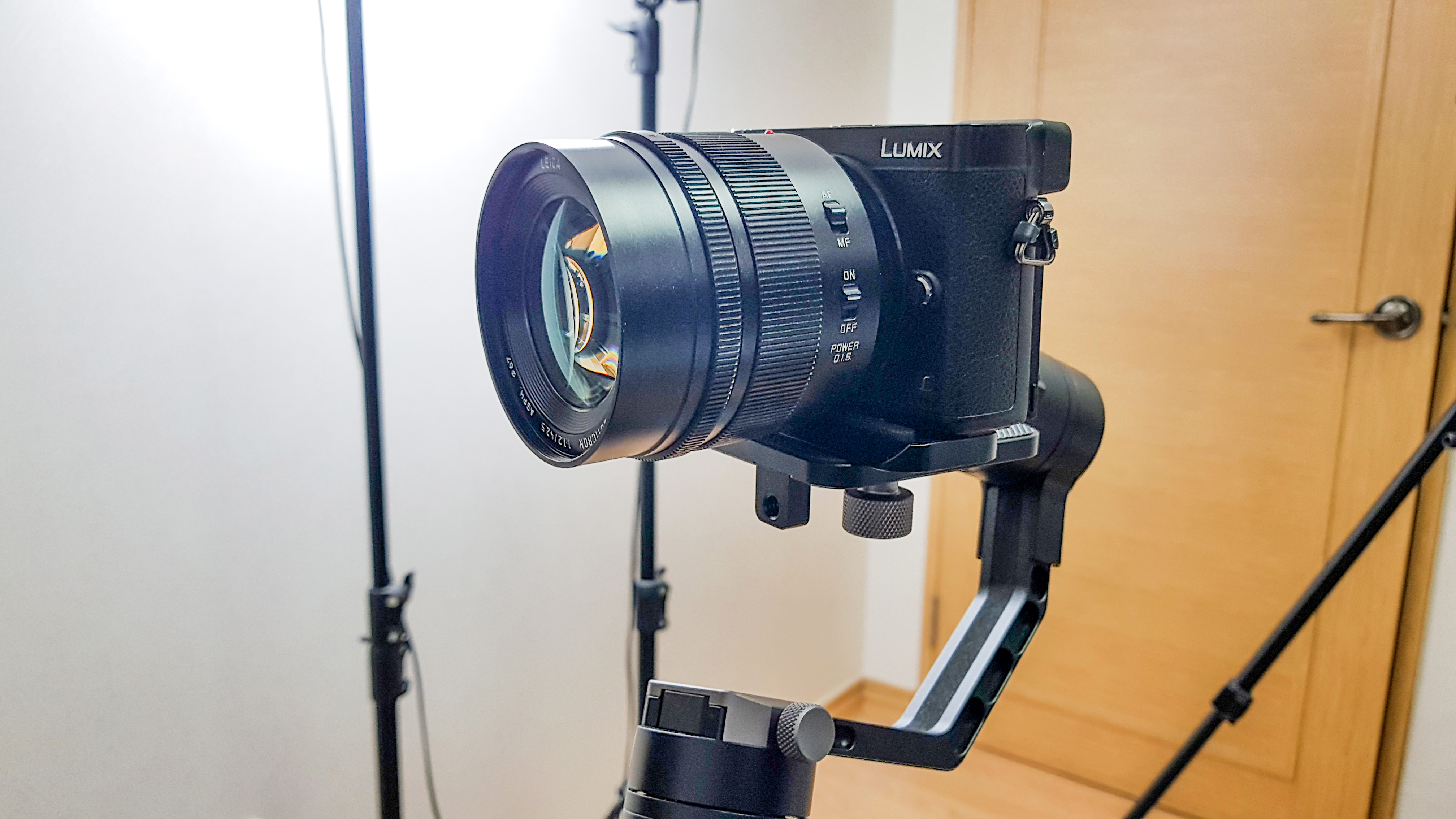

Michael Ma Posted December 6, 2016 Share Posted December 6, 2016 1 hour ago, jonpais said: Thanks, Michael. So, you're saying your footage also exhibits some jitter when trying to hold the gimbal absolutely still. If that's the case, best not to use the gimbal for static shots. Actually, I only just started to use sticks again for video work, since I recently purchased an amazing carbon fiber tripod, and believe it or not, I love working with it. I also shake quite a bit, but I did try to hold as steady as possible for the video clip above. Did you send your 42.5mm in for repair, or are you holding off? Also, I'm curious how you ever managed to balance the Nocticron on the Crane - first of all, it is heavy as hell, secondly, the barrel of the lens is so large, I couldn't even mount it on my Crane. Yes, it's me trying to hold the GH3 as still as possible. The weight is definitely a factor, and the shake is definitely the result of my struggling arms to hold it very still. I just tried with the GX85 as well. It was much harder to balance because of an additional base plate as a spacer, but to my surprise the IBIS although it seemed better on the 12mm only improved it slightly. The 42.5mm....it felt like it did worse as I started seeing very rapid micro tremors at times...might be because it's so front heavy. Anyway, my tests were relatively short and not thorough but something I'm gonna have to keep in mind if I ever put the GX85 on the gimbal with the Nocticron. As for the GH3 in my original tests, I had no problems balancing the Nocticron on the Crane. I'm on the old firmware as well (much before the Canon firmwares were released. I haven't updated since). The edge of the barrel does hit the base plate of the gimbal just a little bit, so it might not be completely flush, although, it mostly looks like it is. Thanks for asking at the lens. I looked at the first images that I took before the fall from the desk did not change the lens at all. It was not sharp at the very center from the first day. The funny thing is the lens is so much sharper at the extreme edges than it is at the very center at 1.2. I'm actually very pleased just how well this lens performs at the very edges (on all 4 corners) at 1.2, and disappointed at how it is not sharp at the very center. Off center, it's fine. I think it could benefit from some adjustment. I'm still planning to take it in, but not in a rush to do it. BTW, if you're wondering about the spacer plate, here's what I use: http://copter-rc.com/en/accessories/69-pilotfly-balance-plate.html It's not perfect, but gets the job done. I'm sure you can find better though. jonpais 1 Link to comment Share on other sites More sharing options...

Michael Ma Posted December 8, 2016 Share Posted December 8, 2016 5 hours ago, jonpais said: Michael, Did you try using the little gizmo that comes with the Crane that screws into the baseplate and fits under the lens to hold it steady? Ah, that gizmo. Thanks for the tip! I've never tried it but with some tweaking, I think it has some potential of pushing the weight back on a front heavy camera. I'll try it when I need to mount the Nocticron + GX85 on the Crane. jonpais 1 Link to comment Share on other sites More sharing options...
