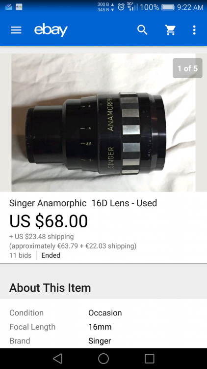

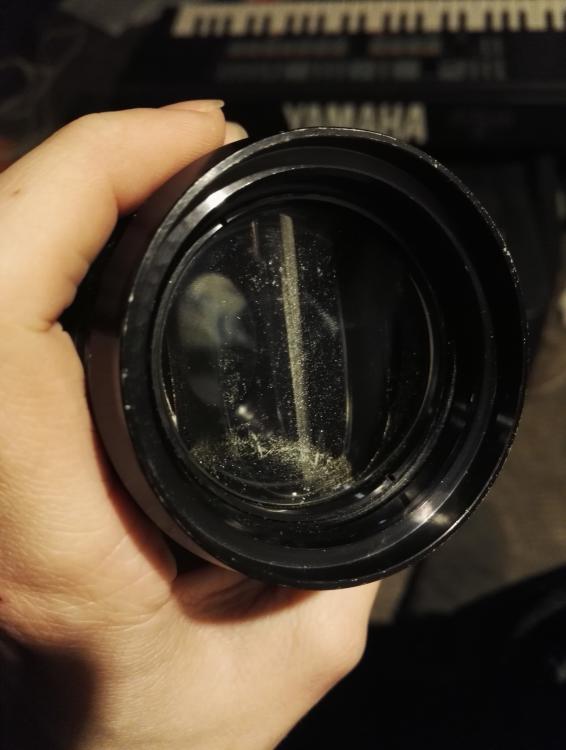

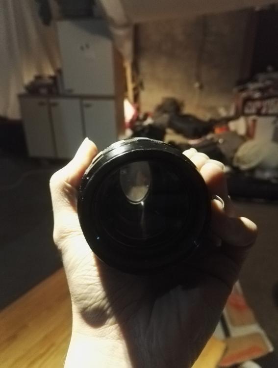

Justin Bacle Posted December 17, 2016 Share Posted December 17, 2016 Hi everyone, just wanted to share my experience fixing a bad singer 16D i got on ebay for cheap. 1. I got this Singer 16-D for a very good price on ebay. As shown on the ad's pictures, there seemed to be fungus/dust inside. 2. I received the adapter and noticed that there was no fungus but the coating has gone bad and was partially gone or made tiny bubbles. I tried the adapter but it was just a hazy ghosty mess. 3. I got the adapter open (you can follow @Tito Ferradans guide with his Elmoscope/Kowa B&H as the construction is very similar), removed the the front elements and got to work. I did scratch the remaining coating with my nail (went away very easily) and finished the job with a bit of acetone. The result is not perfect but way better than I expected. 4. Here is a very quick and dirty shot with the Singer 16-D : Compared to the same quick and dirty shot with my Isco Ultra-Star Both shots with the Helios 44M wide open (f/2) Still hazy but very usable IMO, plus I want the Singer to be hazy and flary as I already has the Isco which is damn sharp and does not flare by itself. Do you have similar experiences to share or have any remarks on my repair ? Flynn and Tito Ferradans 2 Link to comment Share on other sites More sharing options...
