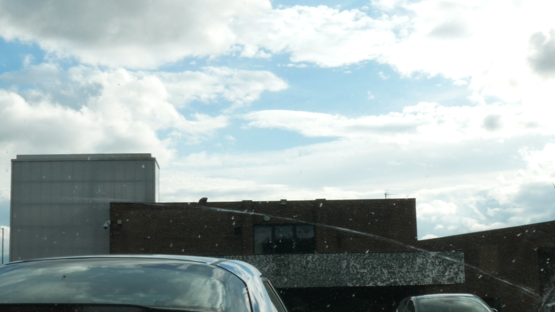

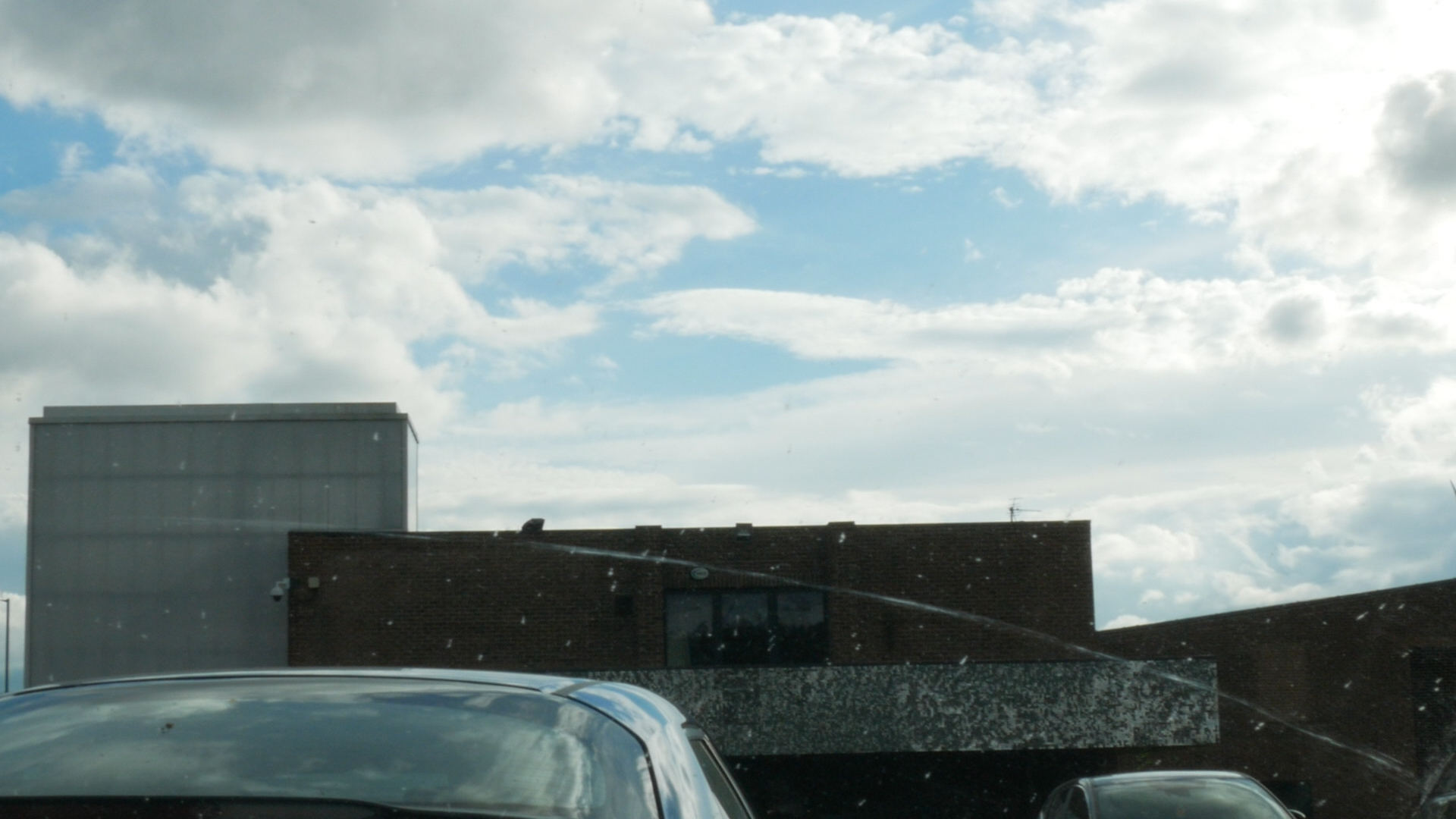

Inazuma Posted December 22, 2016 Share Posted December 22, 2016 Cary, I have to thank you for reminding me about this because I did actually forget about it. The easy way to fix the problem actually (in Premiere Pro anyway) is just to use the Fast Color Corrector and change the white OutPut Level frm 255 to 235. Before: After: Zak Forsman and dahlfors 2 Link to comment Share on other sites More sharing options...

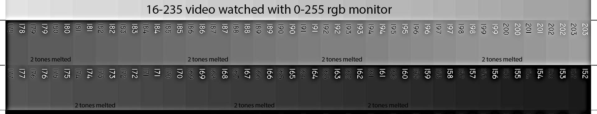

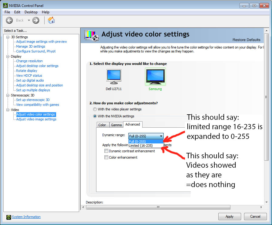

Vesku Posted January 18, 2017 Share Posted January 18, 2017 I studied Sony RX100 mk3 files with Vegas Pro scopes and it gives different values than Premier. Vegas shows RX100 XAVC-S is 16-255 and Premier shows 0-255. I saw odd readings with my GH4 files in Premier too. Premier Waveform shows 16-235 with my GH4 0-255 files. My eyes says the Vegas Waveform is right. Is there some settings in Premier causing wrong values in Waveform. It is also confusing to view videos with PC Media players. If I play full range 0-255 video I must set graphics card level setting to "limited range 16-235". If I use normal 16-235 video I must set graphics card setting to "full range 0-255". When I watch GH4 full range 0-255 video file with "limited range 16-235" setting the final video image in monitor contains all the 0-255 shades and it is perfect and has no banding. When I watch "normal" 16-235 video with "full range 0-255" setting the final video image in monitor has only 235 shades stretched to 255 monitor and the result lacks about every 6th shade causing banding and noise. If I use 16-235 video with 16-235 setting the gradations are perfect but the whites and blacks are gray. One problem is that many cameras record 16-255 levels but there is no setting in graphics card for that. I can use my video players additional settings for levels for 16-255. There is no way to watch full range videos with TV players. TV player always clips everything outside 16-235. Many cameras record full range video like Canon DSRLs and Olympus mirrorless and some Panasonics like GH3 and GH4. Here is a rough example what happens when watching normal video. Link to comment Share on other sites More sharing options...
Vesku Posted January 19, 2017 Share Posted January 19, 2017 What is actually video level "flag"? Inside video file is somewhere VUI (video usability info) flag for full range or limited range. Can I see the VUI flag somehow? Is it in video exif? What a player or editor does with that flag? Does the Premier do something when a file has a flag? Is there always a level flag in video file? Video level setting in graphics card is confusing when I want to watch full range video: Link to comment Share on other sites More sharing options...
