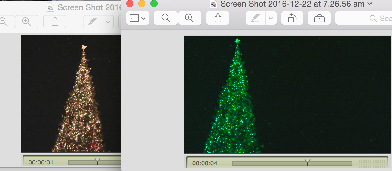

fletch murray Posted December 23, 2016 Share Posted December 23, 2016 I've had my NX1 for a year now. Last night while filming the sensor turned green 4 seconds into the shot. I stopped and it did the same thing the next time I rolled. (I have 1.40 body firmware. I was filming at 120 fps.) But the rest of the shoot it worked perfectly. Anybody run into this? I'm wondering if this is why Samsung shut it down (cost of recalls, embarrassment, bad publicity for the brand, etc. I've never seen such an excellent camera disappear after beating all the competitors in the mirrorless category PLUS providing 4k internal with an SD card. I could go on and on. At the time, I hoped that Nikon bought the innards for their own mirrorless system. I still hope that will occur. The first NX1 I bought in November 2015 did this "go Green" on one shot, but then worked fine. I sent it back to Adorama anyway and they replaced it with the one I now have. At the time I just thought that the first camera was a lemon. Link to comment Share on other sites More sharing options...

fletch murray Posted December 24, 2016 Author Share Posted December 24, 2016 It isn't a tint issue. The camera's picture turned green and remained green. Here's a link to the first NX1 I bought in November 2015 that turned green while filming video. (Password is fletch) I notified Samsung but they'd already gone into "radio silence" about the NX1. I returned the camera. Then I ordered another NX1. I hoped that the "turning green" issue was only on the first NX1. Now this second NX1, which I've had for a year now, did it while filming the Christmas trees. Has anyone else experienced this? Any input on how to avoid it or correct it? Or do you have a way I can bring this to Vasile's attention. Link to comment Share on other sites More sharing options...

fletch murray Posted December 24, 2016 Author Share Posted December 24, 2016 Hi BopBill, Thanks for the suggestion. On the shot three nights ago, I was on Auto White balance. The sensor went green 4 seconds into the shot. On the next shot, it went green 4 seconds in...but no changes in settings. Both were shot at 120 fps. The rest of the night the camera worked fine even at 120 fps. Link to comment Share on other sites More sharing options...

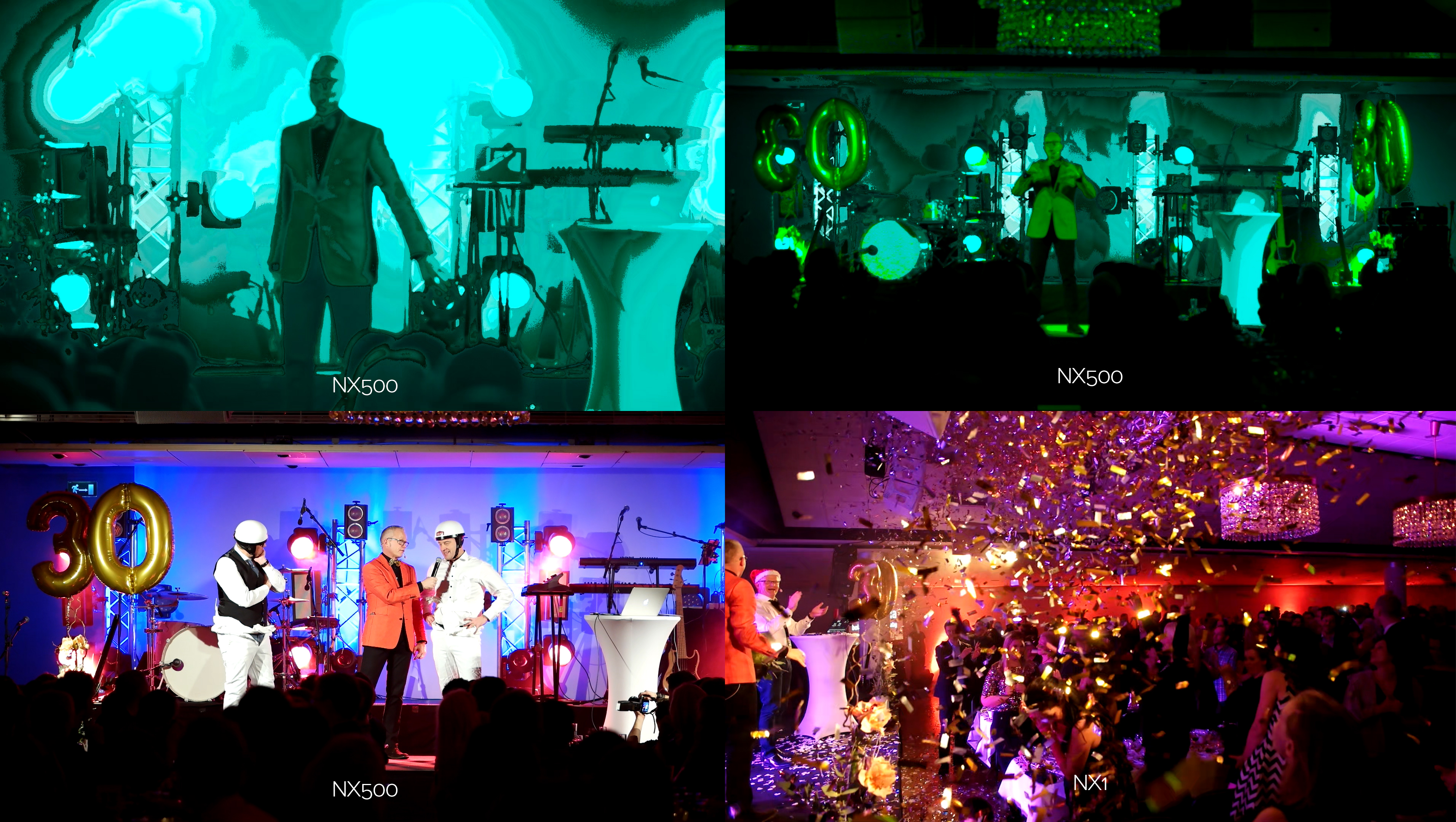

Vincent De La Rosée Posted February 23, 2017 Share Posted February 23, 2017 I can confirm this problem. I had it on both my NX500 and my NX1, also on my friends NX500. Everytime it happend it has happend during an event. I shot and record events like the one above with the sensor getting damaged. I've also called them - when they still sold the NX1, told me they never heard about it. Said it happend on three different cameras, they didn't care much, sent a mail with images and everything and never got a response. Anyway. I always use AWB on my events, I'm going to Val de Sair next week for a nightclub video shot, will try shooting with fixed WB or another WB mode. This has also happend when I'm just viewing the LCD when taking stills. Worth noting is that I took it for a ride in the winter almost exactly one years ago, shot and filmed a couple of hours during sunny daylight - no problems what so ever. Never had this issue during daytime (almost never shot images or video during the day though). And when my friend was using her NX500 during her school projects which occured during daytime she didn't have any problems either. So I think this has something to do with the lightning at the scene. I've tried to pinpoint what kind of lightning that set this off, and I've been noticing that magenta/pink/strong reds has been involved ALMOST every time. You would think that the one in the lower corner (NX1) should rise the issue in like a second, but it doesn't as you can see. Also, I know like a fraction of video compared to you guys, trying to learn all these cinematic stuff you do here. Just so you know before you bash down on anything xD Also,NX500 is operated by friend, NX1 by me, as you can guess it's stills from video Been thinking about selling off my stuff, actually missed a couple of important photos because of this issue, and the autofocus in low light is a joke for taking photos (had Nikon D4 before this). During daytime it's unbelievably awesome though - so weird I think :P I have everything, battery grip, NX1, NX500, all three S-lenses etc. But when I see what you guys can do with the camera, and how much you appreciate the bitrate hack I always take a step back and think again... Link to comment Share on other sites More sharing options...
