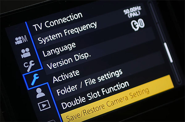

Vesku Posted January 8, 2017 Share Posted January 8, 2017 GH5 NEW FEATURES! (I have asked most of them for years, thanks Panasonic) -auto iso in M with EV comp and with auto iso range setting. -min shutter speed limit. -iso100 for video! -folder and file custom naming -the whole camera status save/load option to SD card (ability to share settings between GH5s) Dean and Cas1 2 Link to comment Share on other sites More sharing options...

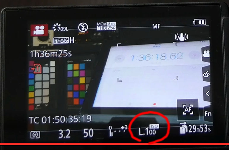

Vesku Posted January 8, 2017 Share Posted January 8, 2017 zetty 1 Link to comment Share on other sites More sharing options...

hyalinejim Posted January 8, 2017 Share Posted January 8, 2017 That could be a digital ISO @Vesku ie: ISO 200 pulled one stop. What is the "L." in "L.100" - does that stand for low or something? 2 minutes ago, jonpais said: That's just the texture of the finish. Cellulite! Link to comment Share on other sites More sharing options...
Vesku Posted January 8, 2017 Share Posted January 8, 2017 2 minutes ago, hyalinejim said: That could be a digital ISO @Vesku ie: ISO 200 pulled one stop. What is the "L." in "L.100" - does that stand for low or something? Cellulite! L.100iso mean it is "extended iso" low. Same as in GH4 photo mode. It means GH5 can use extended iso 25600 too for video. Link to comment Share on other sites More sharing options...
hyalinejim Posted January 8, 2017 Share Posted January 8, 2017 16 minutes ago, Vesku said: L.100iso mean it is "extended iso" low. Same as in GH4 photo mode. It means GH5 can use extended iso 25600 too for video. In that case, I wouldn't get too excited as it's the same as shooting at 200 and pulling one stop in post - ie: you lose one stop of highlight headroom in comparison to a theoretical analogue ISO 100. At 6:00 he mentions a hybrid 4k gamma for HDRTV - I presume this is Rec2020. And just when I'd got my head around Rec709! And speaking of Rec709: I don't see a huge difference in colour reproduction but maybe it would help in improving Panasonic colours a little? Link to comment Share on other sites More sharing options...

Axel Posted January 8, 2017 Share Posted January 8, 2017 29 minutes ago, hyalinejim said: In that case, I wouldn't get too excited as it's the same as shooting at 200 and pulling one stop in post - ie: you lose one stop of highlight headroom in comparison to a theoretical analogue ISO 100. Yep, every ISO setting that deviates from the native sensor sensitivity is the native sensor sensitivity with a gamma correction curve applied and baked into the file. BTW: what is the native ISO of the GH5? 29 minutes ago, hyalinejim said: I don't see a huge difference in colour reproduction but maybe it would help in improving Panasonic colours a little? The best way to improve colors would be to a- use a good profile b- set an appropriate WB -c record a color chard like the one in your screenshot so that Resolve or Color Finale can use it as a reference to optimize the colors automatically. Link to comment Share on other sites More sharing options...
