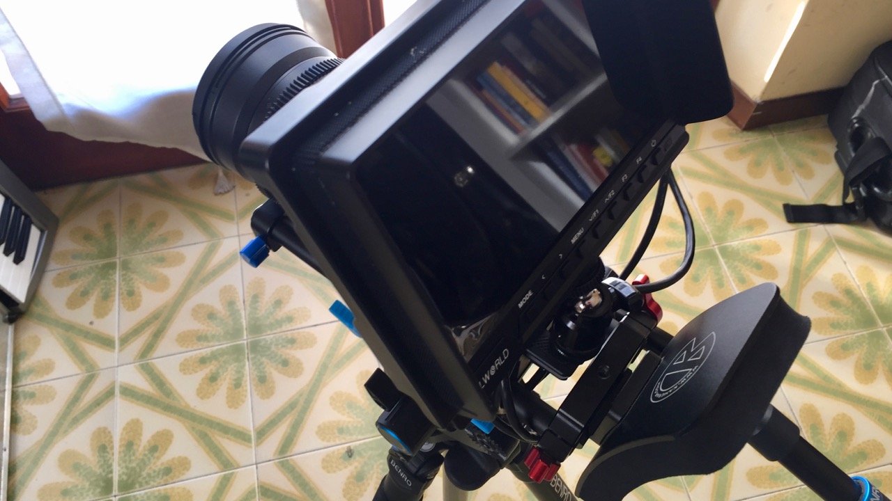

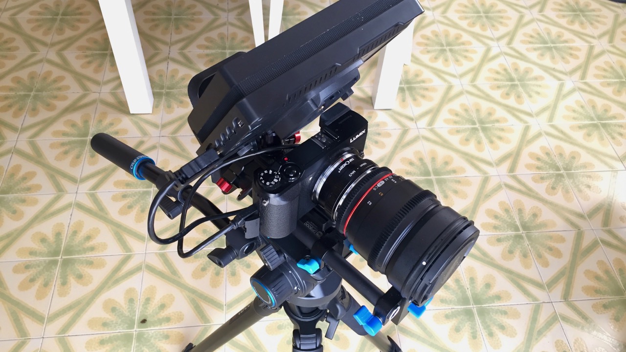

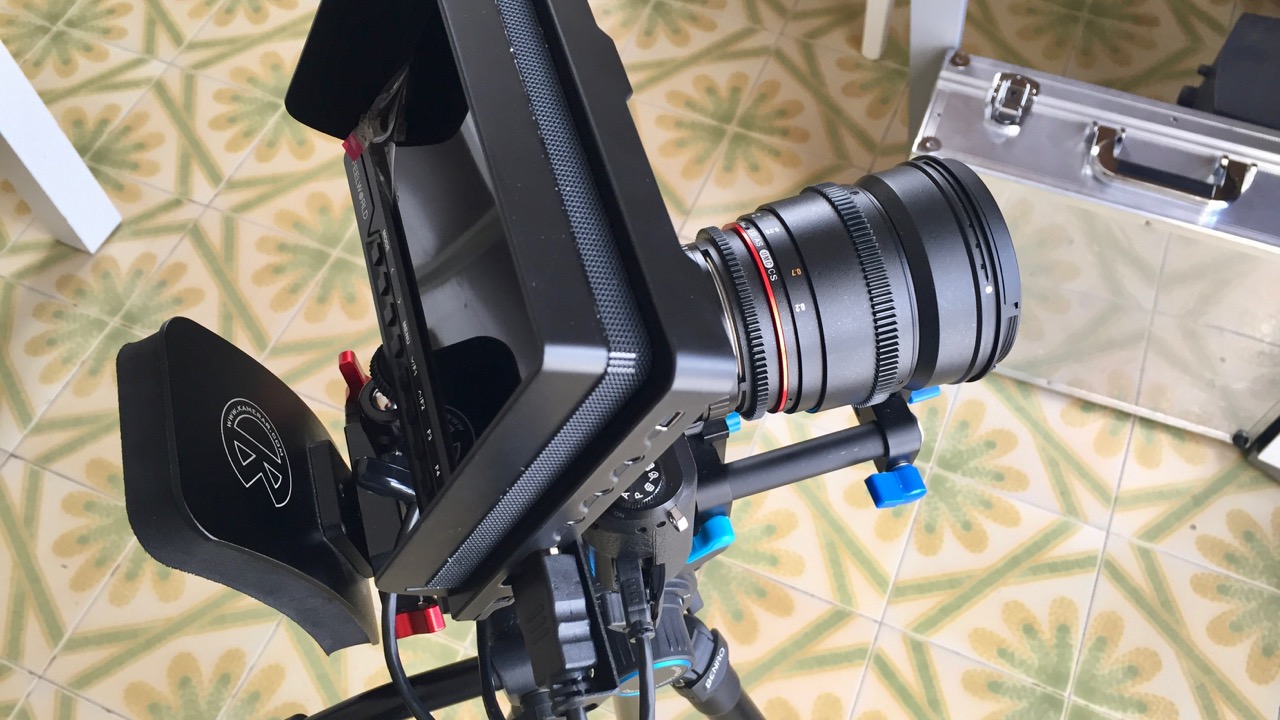

Ronnie Amighetti Posted January 20, 2017 Share Posted January 20, 2017 In case anyone's interested: Got to play with a Feelworld FW760 7" field monitor, connected to my GX80. It came with the latest software review in which they bumped up the input formats to 4K. The monitor in itself is quite nice, building is average but you totally get what you pay for. The kit came with a coldshoe ballhead support, sunhood mounting frame, sunhood, HDMI cable (mini to regular) and documents. Main features: 4K input support 4 assignable function button for direct access Safe frames, aspect ratio masks Focus peaking Sony NP battery It does what it is supposed to do except for a few quirks that I don't really like: Huge latency on the signal: annoying and very visible, I know it's the monitor beacuse the camera connected to my TV doesn' show the same behaviour. I guess that might be because of the 4K update, the few reviews I saw on the web didn't show any of this latency Signal is intermittent, don't know if it's a cable problem (only got one HDMI micro to regular to test with) or what, but right of the box the first 30 minutes or so it was quite a pain in the ass, then it started acting a bit smoother A few bugs in the software: powered up and the images was so oversharpened it was painful to look at. Dialed down to 20 (from stock 50) and all was good. Problem is as soon as you activate focus peaking and then deactivate it sharpness is back to stock value and you gotta dive into the menu once again. Very annoying. Zebra show some strange behaviour. You can dial them in from 0 to 100 but your changes take place only if you have them activated. If you have zebra off and set them to 70 and turn them on they'd be at their previous (random) value. Makes no sense at all. Feelworld website is probably one of the worst I've ever seen. There's no info on software or firmware or whatever. I looked at their Facebook page and it's worse. I'll keep it for a few days and then make my mind up. It's a tad too big for my tastes, I was looking to build a small and easy to carry around rig so 5" was my choice but I couldn't find any cheap monitor that size. My 2 cents. Inazuma and Orangenz 2 Link to comment Share on other sites More sharing options...
